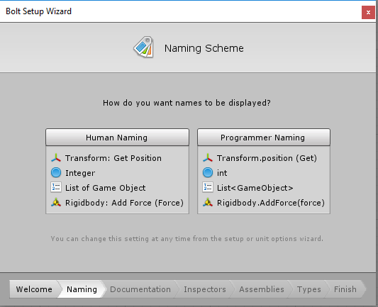

When you first install Bolt it is recommended to stick with Human Naming. If you're a programmer and you're used to writing things out, you can go with the Programmer Naming. For beginners, Human Naming will make it much easier to understand and to find nodes (units).

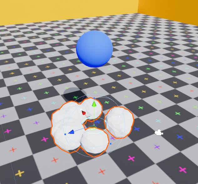

In order to detect objects, we need a couple of things, a rigidbody and a collider. If two objects hit each other this is known as a collision and we can detect collisions by using an OnCollisionEnter unit. Both of these objects must have a collider component of some kind in order to detect each other and at least one of these must have a rigidbody.
We'll demonstrate this by using a ball bouncing onto the floor. The sphere game object has a rigidbody, collider and a bouncy physic material to make it easy to bounce. Upon hitting the ground I also want to play a cartoon smoke ring to mimic dust from the impact.

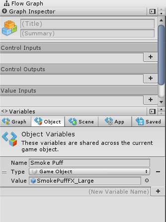

We need the ball to detect the collision with the ground and the smoke ring will be a particle system that will just reside on the ground at the exact point where the ball would hit the ground. Ideally, you'd have the smoke ring move with the sphere and play at the point of impact, but to keep things simple we're keeping it where it's at.
Since the particle effect is not attached directly to the sphere we'll need a variable specifically to play the smoke particle system. In order to play a particle system, we'll use a Particle System Play unit, which will be attached to the OnCollisionEnter.
Since OnCollisionEnter gets called automatically on impact with an object, we will then have the output of that unit play the smoke ring particle system. Here is the end result:

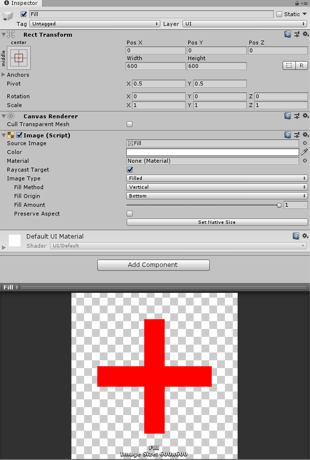

Images will come in the form of a dynamic fill for things like a health bar or experience level meter. Text is usually a compliment to those images but can also display relevant information such as time in game or points accumulated so far.
Lets take a look at an example of a health bar shown in the Game Programming Bootcamp Exercise. This utilizes a white border with a dynamic red fill.
For the example we'll have the health bar deplete over time smoothly until it reaches zero. In the original exercise we used a Coroutine which allows us to wait a specific amount of time and loop through using a while loop. This can be done using an Update unit as well, but for this we'll use the Start unit and set it to be used as a Coroutine by clicking the checkbox in full screen mode as such.
You'll see two straight green arrows appear on this unit once you enable this. If you forget to enable this as a coroutine you will see an error appear when you play the game. We will use the Start unit to automatically go into a While Loop unit. This While loop requires a condition in order to work.

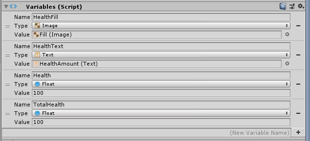

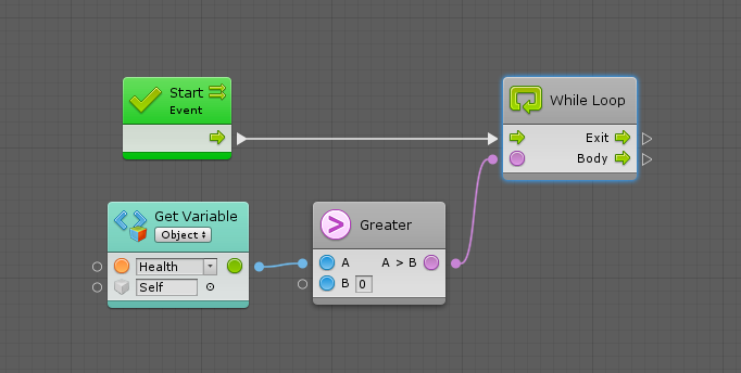

We can say "while the health is above 0 we can perform an action". So we need a health variable, and we'll utilize it as a float. While we're adding variables, lets add in a few more that we'll need. We need the red fill image as an Image type called HealthFill, the text to display the actual health called HealthText and two floats, one for the current health called Health and one for the total amount of health called Total Health.
These will be added as object variables which should reside right above your flow machine component.
We use two float values as we'll be using this with the fill amount of the image which has a range between 0 and 1. By using Health divided by TotalHealth we can then turn our health value into a fraction allow us to utilize that directly with the fill amount. An example of this would be if Health (50) over Total Health (100) resulting in 50/100, giving us a value of 0.5 which is the halfway point for the fill amount of the image, representing half our health depleted.
That said, lets take a look at how we would use all these variables to create a health "bar" that depletes over time. First lets check to see if the Health value is greater than 0 with a Greater (than) unit, which means we can start deducting health using the While loop.
If we are in the while loop we deduct our health over time, using the Get Time Delta Time unit. This unit will count up based off the in game time and since it's a float value as well we can use this to deduct from our Health value and get incremental changes. We will subtract the time from the Health variable using a Subtract unit. Since we are going to use this Health value later, we also need to ensure we set the new value for the same Health variable. Take the output of the Subtract unit and connect it back to the Set Health unit.
We need to also update the Health fill image to display the changes in the health value in a visual format, otherwise all of this will happen in the background without us noticing. So lets plug in the value of Health divided by the TotalHealth and assign that to the fill amount value of the image.
Use the Set Fill Amount unit which will take in a float input and an image input. The image input will connect to the HealthFill variable while the float will be based off the output of a Divide unit that is connected to Health (top input) over TotalHealth (bottom input).

When the health reaches 0, the while loop condition is no longer true and will stop looping.
