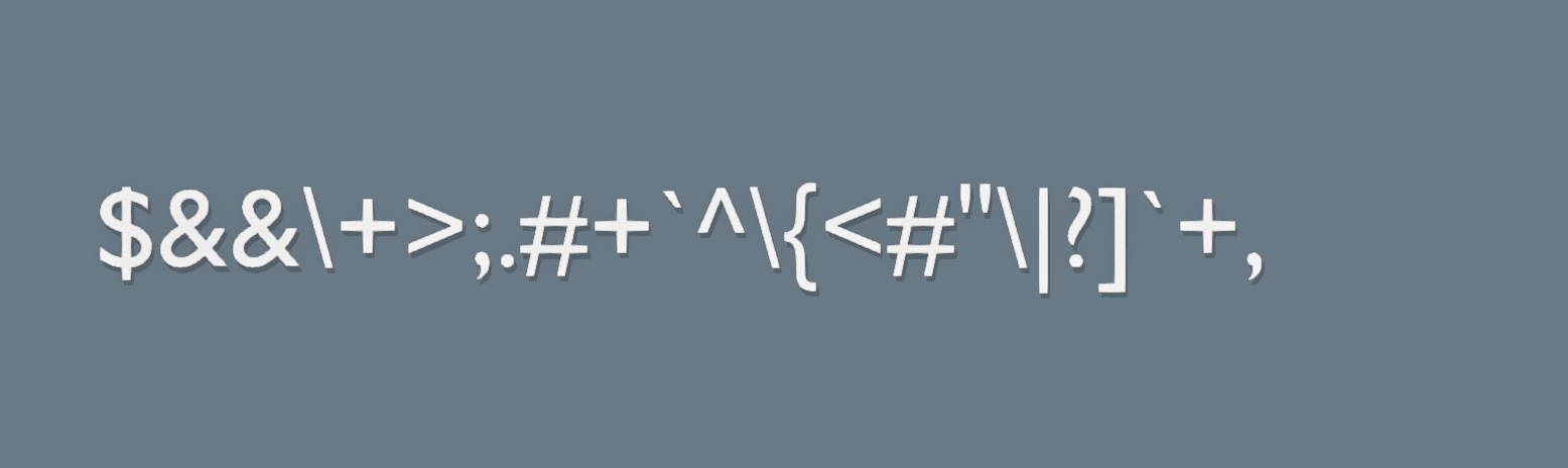

9. Text FX
One of the areas where Blender can be said to be a little bit behind is motion graphics, in particular when working with Text objects. The addon Text FX makes animating text a breeze and adds quick controls for effects that you’re likely to want to use. You can animate numbers counting up or down, make a timer, a typewriter printout, or that cool matrix style scramble effect.

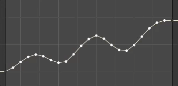

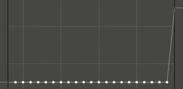

There are a thousand tools for moving vertices in Blender in all different sorts of ways, but not that many tools for moving our other favorite points in space - keyframes!
Well, the addon AnimAide by Ares Deveaux brings some of those clever concepts to the graph editor. After installing the addon you can use these sliders in the graph editor to ease your keyframes between two points in 14 different, incredibly helpful, ways. There are also hotkeys and pie menus if you really want to get serious with it.
There’s also a second panel called Anim Transform which lets you move your object in the 3D view and all of the curves will shift over accordingly so you can play the same animation in a different spot. That is magic.
You can tell it’s made by animators for animators because there’s no extra fluff and no gimmicks - just a handful of well thought through features that work every time.
