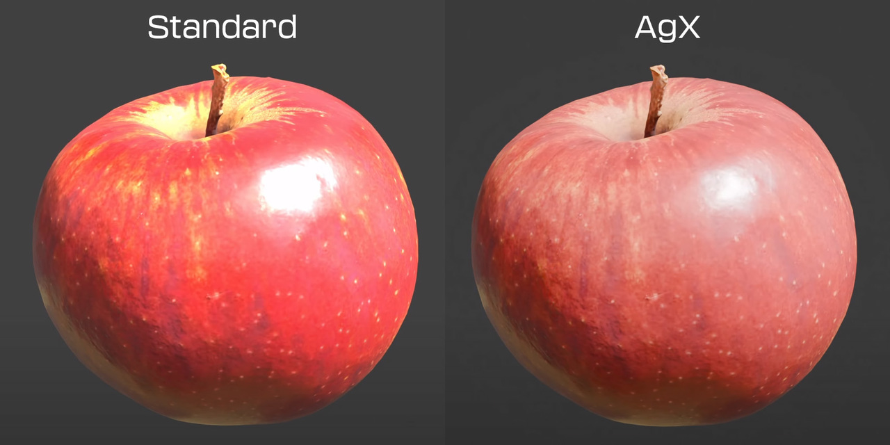

Many artists have heard about how Blender’s AgX color transform is technically better than standard sRGB, Filmic, ACES, and others, but, in practice, struggle to actually get the colors they want while using it because the default results can look a bit dull, and certain colors like neon yellow are hard to produce.
In this article, I’m going to show you exactly why that is, how AgX actually helps you get more vibrant colors rather than less, how the mysterious RAW color transform might be the key you’re looking for, and a few techniques for making colors pop in Blender that I haven’t seen anybody else talk about online.
First though, we need to talk about why your renders with AgX might be looking dull.

Some color transforms are better than others. Standard sRGB, which is what was available during most of my time with Blender, blows out any bright or colorful areas, and skews the hue in bright areas towards neon yellow, magenta, or cyan. Filmic doesn’t blow out but does skew, while ACES does a bit of both.
This is very unfortunate because it means you can’t use very bright lights or saturated materials without things blowing out, thus leading to renders that look less realistic. A better color transform is one of the key reasons the lighting in animated films has started to look a lot more natural, totally separate from the rendering technology itself.
