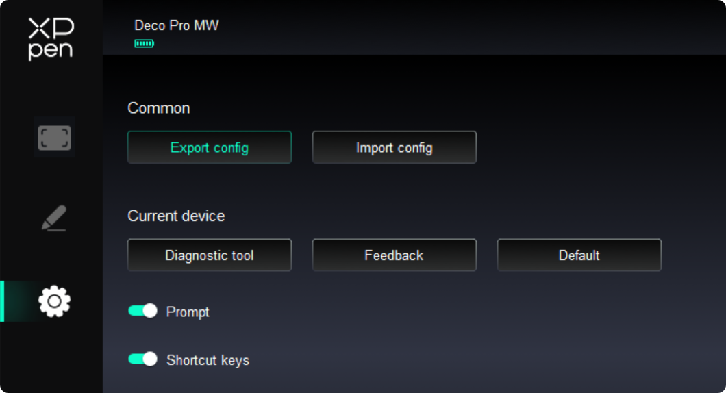

Finally, if you want to share this layout, you can export the configuration easily from settings:
