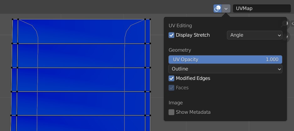

14. Visualizing Stretching and Modified UVs
As mentioned before, I usually like to work with subdiv disabled in Edit Mode, but it can be helpful to turn on sometimes to diagnose what is causing some stretching. After enabling it, turn on Modified Edges in the UV Editor’s Overlays popover (I think it may actually be on by default now) and you’ll be able to see just how your UV edges are being pulled around by the smoothing.Â
You can also turn on Display Stretch in that same menu, which shows a helpful heatmap of where your islands are most distorted.Â

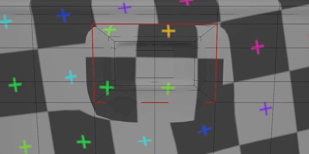

15. Partially Following Active Quads
Here’s the best trick I know for straightening out more complex islands: use Follow Active Quads on only the part of the mesh that should have straight quads, pin those vertices, and then unwrap the rest of the island. Everything that's not pinned will snap right into place!Â

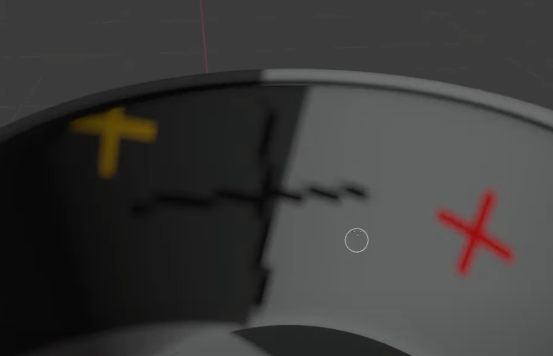

17. Use Pinning to Guide the Unwrap
If your UV islands are jumping around while you unwrap or if you want to guide your unwrap a little bit more manually, try pinning just a few vertices of an island and let Blender interpolate the unwrap between them.Â
