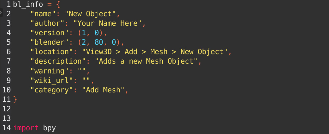

Terrific Templates
If youâd like to turn your script into a proper addon that can be accessed via a button in the interface or a menu, Blenderâs built-in templates are a great place to start. There can be a lot to remember when it comes to how to provide the info thatâs seen in the User Preferences or how to register the addon so that itâs displayed properly, so templates are a great thing to refer to (or copy and paste from) if you get stuck.Â
