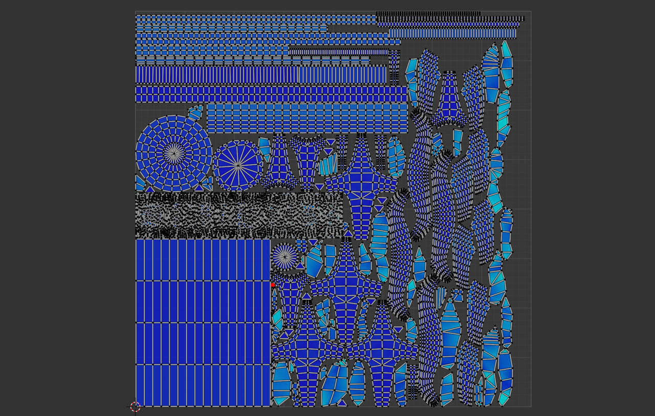

Setting up our UVs for our 3D asset
Before we are able to start adding texture to our model, we need to tell the model how we wish to display the images on its faces.
We’ll use the model’s UV coordinates to determine how the textures will appear. This involves creating seams to separate parts of the model, unwrapping the islands that are created from our seams and straightening everything out so that we minimize UV skew and distortion.
That can sound somewhat cumbersome and is often the stage in the workflow that most people strongly dislike. I find it oddly cathartic and enjoy putting on some music or a podcast to listen to while I get into a flow state, so to each their own!
