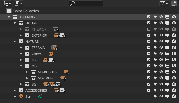

The spice-venders-house_ASSEMBLY.blend file is organized pretty thoroughly and intuitively into Collections.
These collections are great for enabling and disabling parts of the scene for faster navigation or optimized rendering (like disabling exterior nature when rendering inside and vice versa). By default the interior collection is disabled for this reason.
Though the assembly is quite fast in solid viewport shading, things can get very slow when viewport rendering with Eevee. I do not recommend enabling all collections at the same time.
All animation is intact however the scene slows to a painful crawl if you try and playback in the viewport, especially the more animated objects visible. I recommend avoiding animation playback in the viewport except when fewer collections are visible.
For example, the mill mechanism should playback in realtime if only the INTERIOR and MILLHOUSE collections are visible.

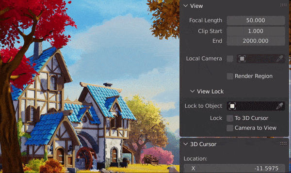

The start and end clip values can significantly effect rendering components with Eevee. They need to be within a proper range to avoid artifacts in shadows and alpha textures. The clouds especially show black artifacts if the start and end clip aren't set properly. The defaults should work well for exterior viewing/rendering:
View Properties (N panel) > View
For interior shots you may need to reduce the start value to 0.1 depending on how close your camera is to interior objects. Also if you disable the NATURE and ACCESSORIES collections you can reduce the end clip value.
NOTE: These values are relevant for both viewport and camera.
