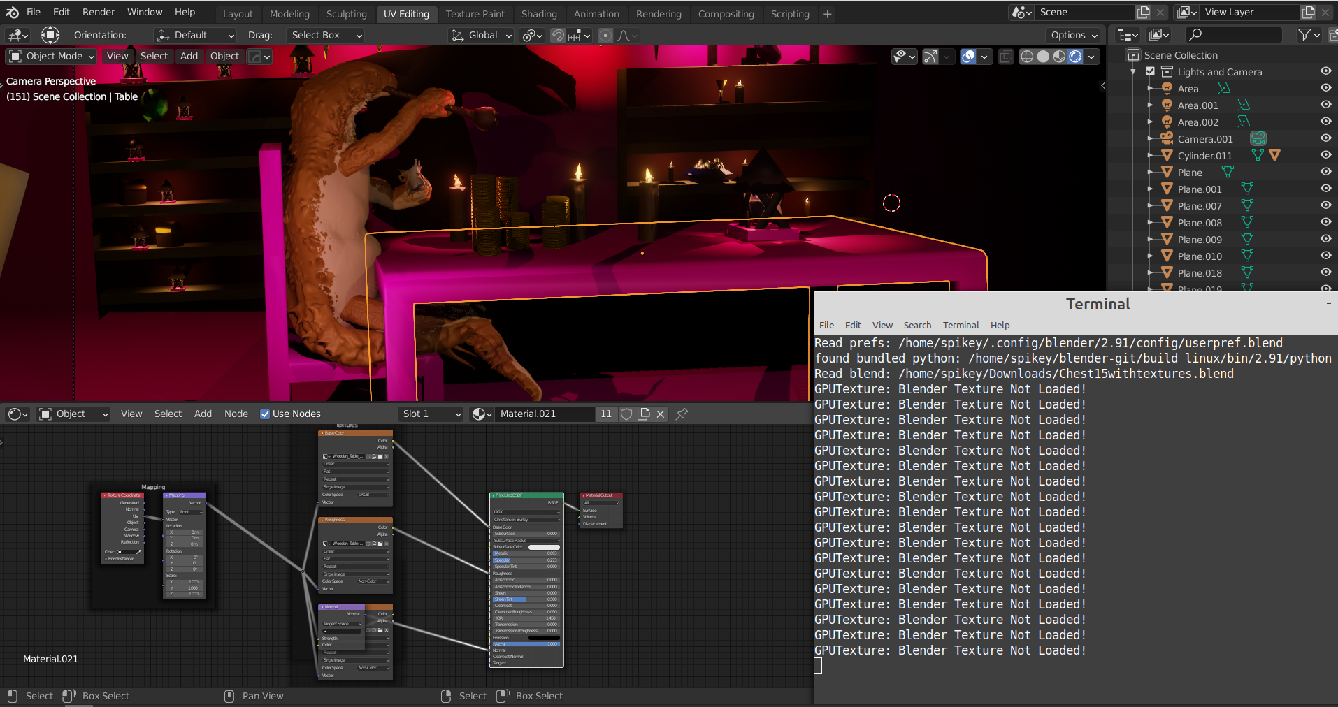

    cchaoslillith it looks like your images did not get packed into the blend file. Also you left your "lock camera to view" button on. Pretty cool scene though. I'm interested in seeing this one covered!
  • Kat Loveland(chaoslillith) replied
    blanchsb I am not sure what you mean by images did not get packed. Does it not open right in Blender? Thanks! Glad you like the scene. Or are you referring to the textures?

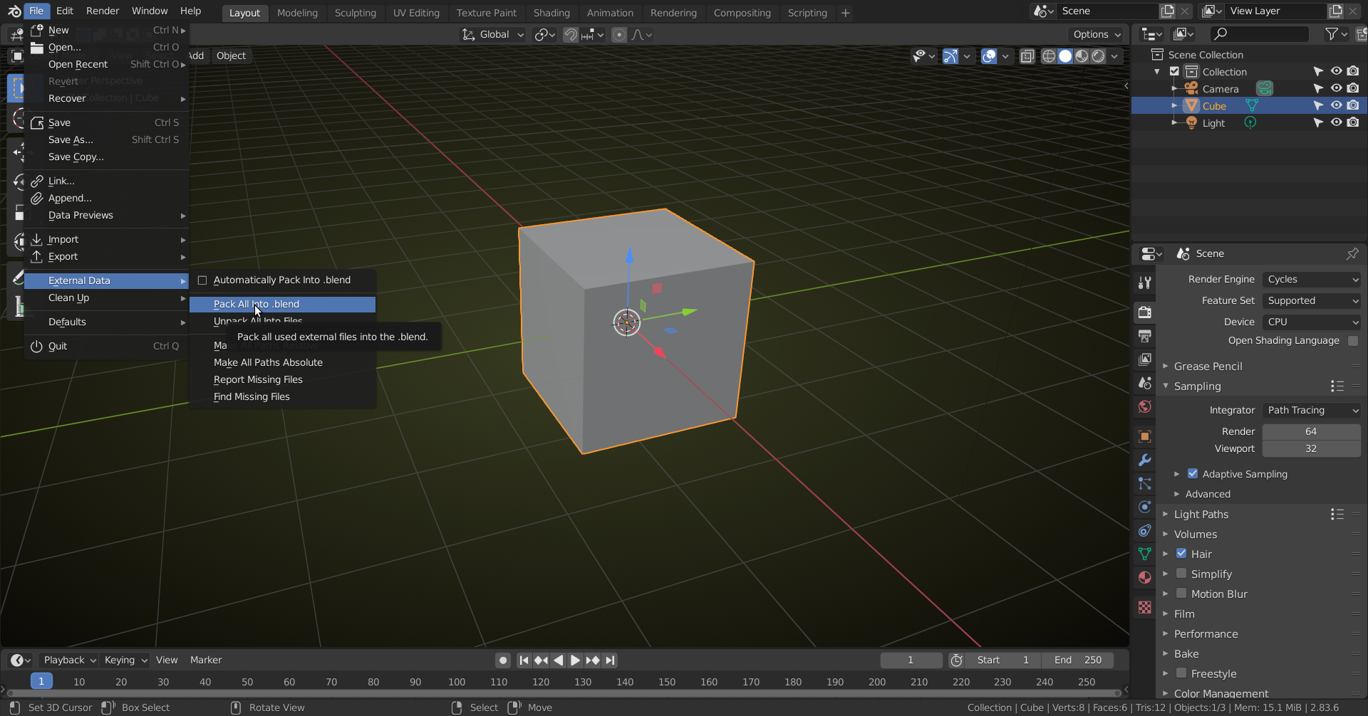

    It's Textures that are missing:
    Oh, yeah lol. I haven't had to pack textures yet :) Sorry. It  was just a wood and wall texture. If @jlampel wants them I can learn how to fix that, unless he wants to use his own, whatever works best.
    To pack textures is easy:
    Ahh cool! I will do that and add the new file, although it is a shading and materials course lol. Maybe he'll just make cool new ones ;)
