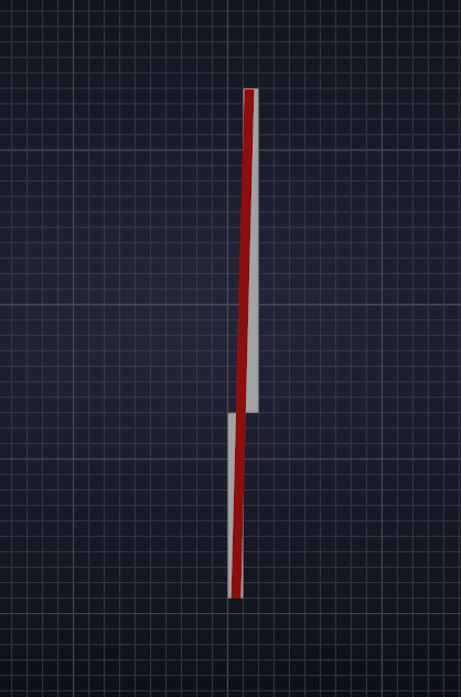

When doing the exercise I noticed that some of the lines weren't straight. I tried straightening some and found it very time consuming.
At the end of it all, does it really matter if small details like those are not fixed?

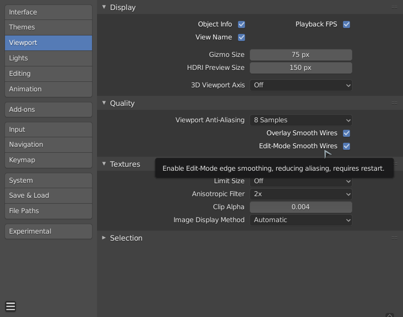

    Hi Jonathan, don't worry about that; those lines actually are straight, this is due to the fact that a straight line that is not completely vertical or horizontal gets 'split' like this when drawn on the screen:
    In your Preferences there is a setting 'smooth wires' also the Anti-aliasing setting might influence the look of your edges:
    As far as Blender is concerned these line are straight, only we might see some 'pixelation'.
    Some people prefer to un-check Smooth Wires, in order to get a visual clue when an edge is not completely horizontal/vertical.
    Again: an edge between two vertices is always straight!
