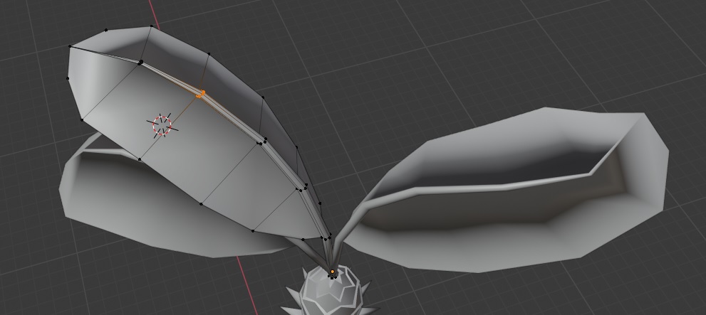

I'm in the middle of creating the leaves for the palm tree but when I try to duplicate the vertexes and extrude to create the leaf shape it just duplicates the vertexes but they're not attached to the branch. So it's just an edge of vertexes with no faces.
I already tried to create the leaf by just extruding without duplicating, but it has artifacts when I try to apply shade smooth.

    Hey thanks for attaching that blend file link. I downloaded it and just isolated one of your leaves. I think what you are talking about: is struggling to duplicate the "stalk" vertices for each leaf half and then you want to extrude them but you are finding that they are still attached to the "stalk" whereas in the @theluthier  video Kent seems to have the leaf separated. (See time frame 37:00 -ish for when he is doing that step.
    I made a short video regarding one of your leaves and noticed there are a couple of issues with the one I chose at random.

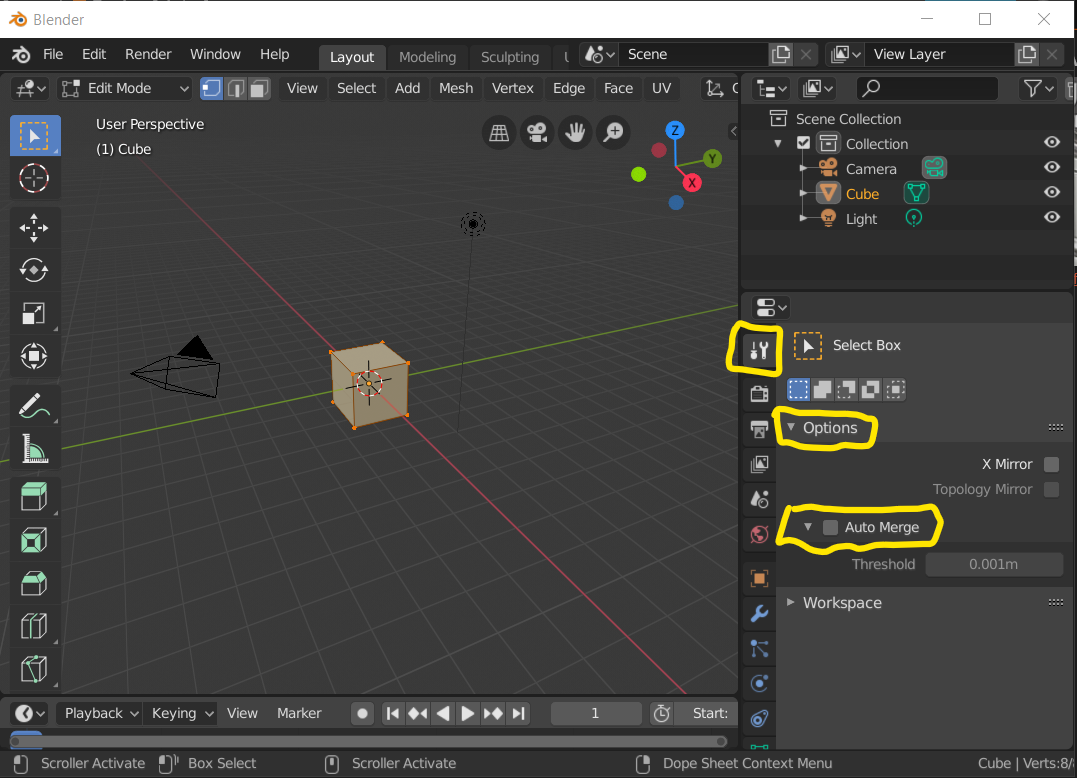

    Hey ddizzardy I figured out where the setting is for auto-merge!
    It is in the Properties panel in the "Active Tool and Workspace Settings" section. You got to open up the "Options" drop-down and there it is!  The (in)famous Auto-Merge check box. Make sure that is unchecked or it will wreak havoc on you when you don't want/need it.
    It is super handy for some stuff but I can't say I use it much. See picture below for more info.
    Also I forgot to state ddizzardy that you can change the merge distance when using Alt + M and then B. Sometimes I set it to a larger value like .01m or .005m when I want vertices that are "close enough" to merge together. You can adjust it also on the auto-merge as well. It is called the "Threshold"
