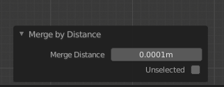

    Hey Sudeep,
    I am a beginner myself - especially with Blender 2.8 - but I remember Jonathan using 'Remove doubles' in older versions of Blender to deal with similar situations.
    In Blender 2.8 this functionality might have been renamed into 'Merge By Distance' (depending on your version I guess), but you can access it in 'Edit Mode' by either pressing F3 and searching for it or clicking on 'Mesh' >> 'Clean Up' >> 'Merge By Distance'.
    Select your overlapping parts or just everything by pressing 'A' in Edit Mode and use 'Merge By Distance'.
    This should remove overlapping vertices and with those your overlapping faces.
    Hope that helps.

  • Sudeep Singh(hellosudeepsingh) replied
    I tried this method, but the overlapping faces are still visible
  • bun-bun replied
    Hello Sudeep,
    I am sorry to hear that it did not work.
    Right now I am running out of ideas without seeing your model, but here are two more suggestions:
    1.) Depending on the distance between overlapping vertices, the default-setting for the 'Merge by Distance'-Function might not work for you. Try cranking up the value in the bottom left corner once you clicked on 'Merge by Distance'.
    But keep an eye on your model. Once your model is being deformed, the value is too high and the problem is somewhere else.

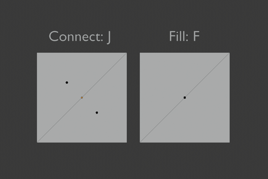

    thank you Tom, i think the problem is caused by pressing F unexpectedly, i still got confuse, what is difference between connecting two vertices by  pressing J and Pressing F ?
  • spikeyxxx replied
    Hi hellosudeepsingh
    If you connect two opposite vertices in a quad, for instance, that will make the quad into two triangles.
    If you 'fill' the two vertices it creates an edge between them, but leaves the quad.
    So, if you (accidentally) fill three vertices of a quad, you'll get a triangle and a quad occupying partially the same space.
    Something like that must have happened; thanks bun-bun for finding the solution!
    I didn't think of that;)

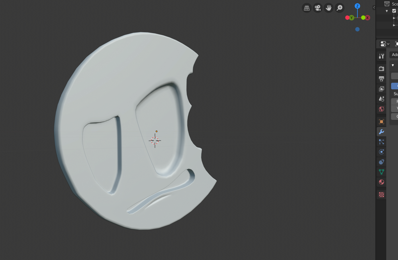

    here is another thing happening , plz help
    when i put tick on  "In front" the overlapping type  of effect is visible
    but when i dont put tick on "in front" the overlapping disappear
    what is the reason for that effect
    does my face overlap or that is effect seen due to "in front" tick
    ok
    first  under view-port display , put tick next to "in front "
    then under edit , we see the overlapping effect
    here is link to .blend file
    https://drive.google.com/open?id=11hXV4GChgmGmFULN5AAPNC9TvXjbQzA2
     Thank you Jan-Willem Van Dronkelaar and other crew for helping me , now finally on my right track to make 3d CG cookie icon

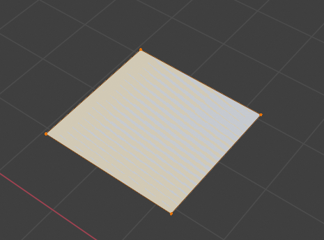

  • spikeyxxx replied
    hellosudeepsingh You have some flipped normals, but for the rest your mesh looks fine. (SHIFT-N in Edit Mode, with all selected)
    For the rest, this appears to be a bug or something with 'Display in front'. Even a simple square has this strange effect:
