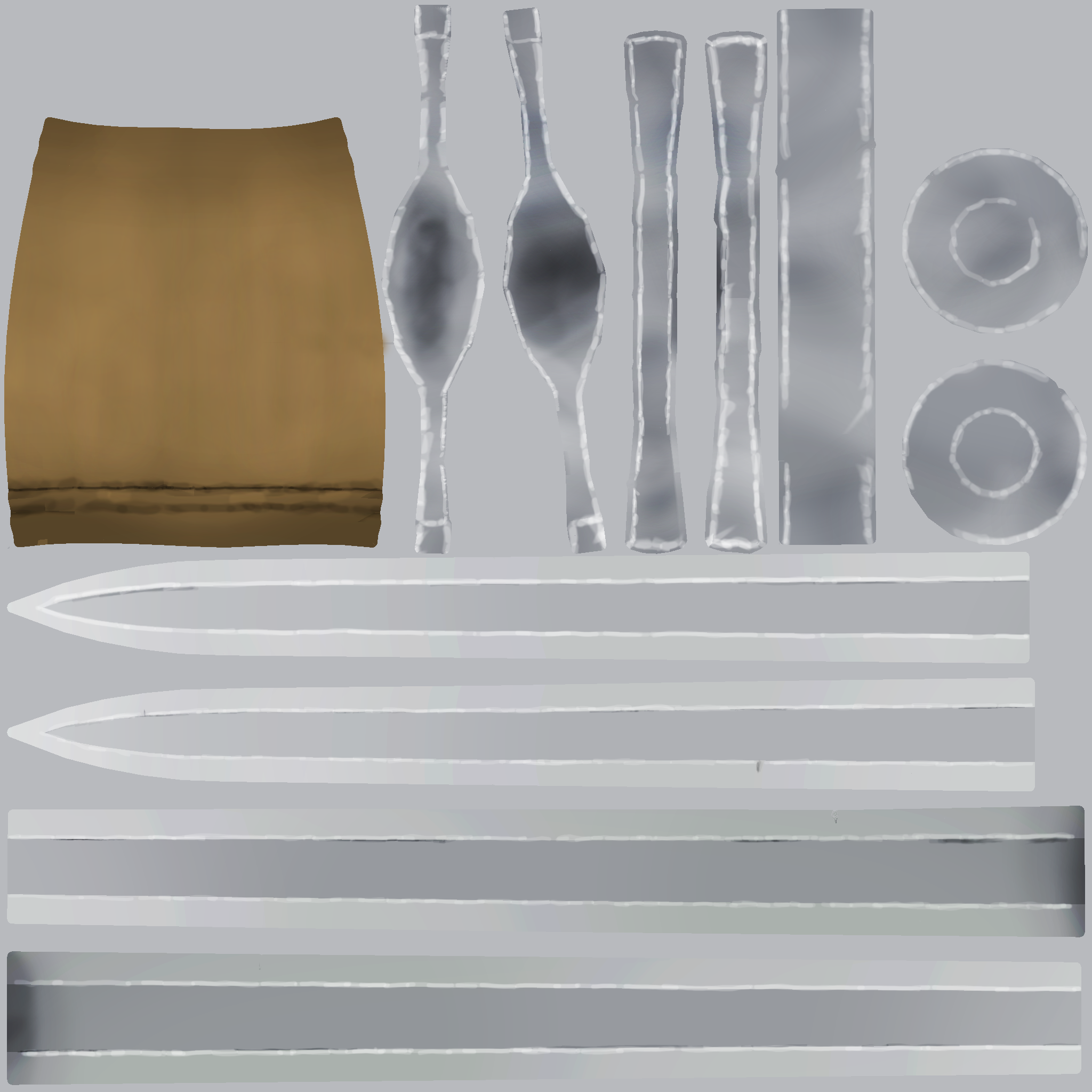

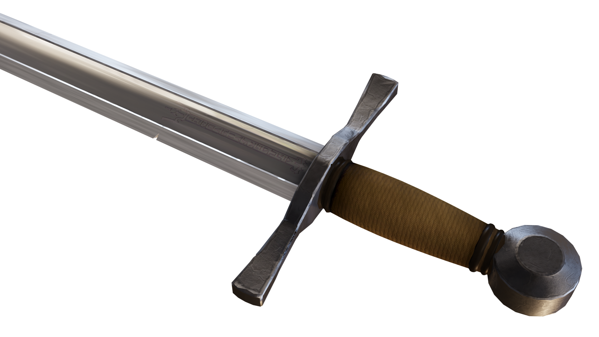

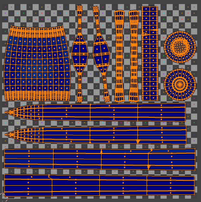

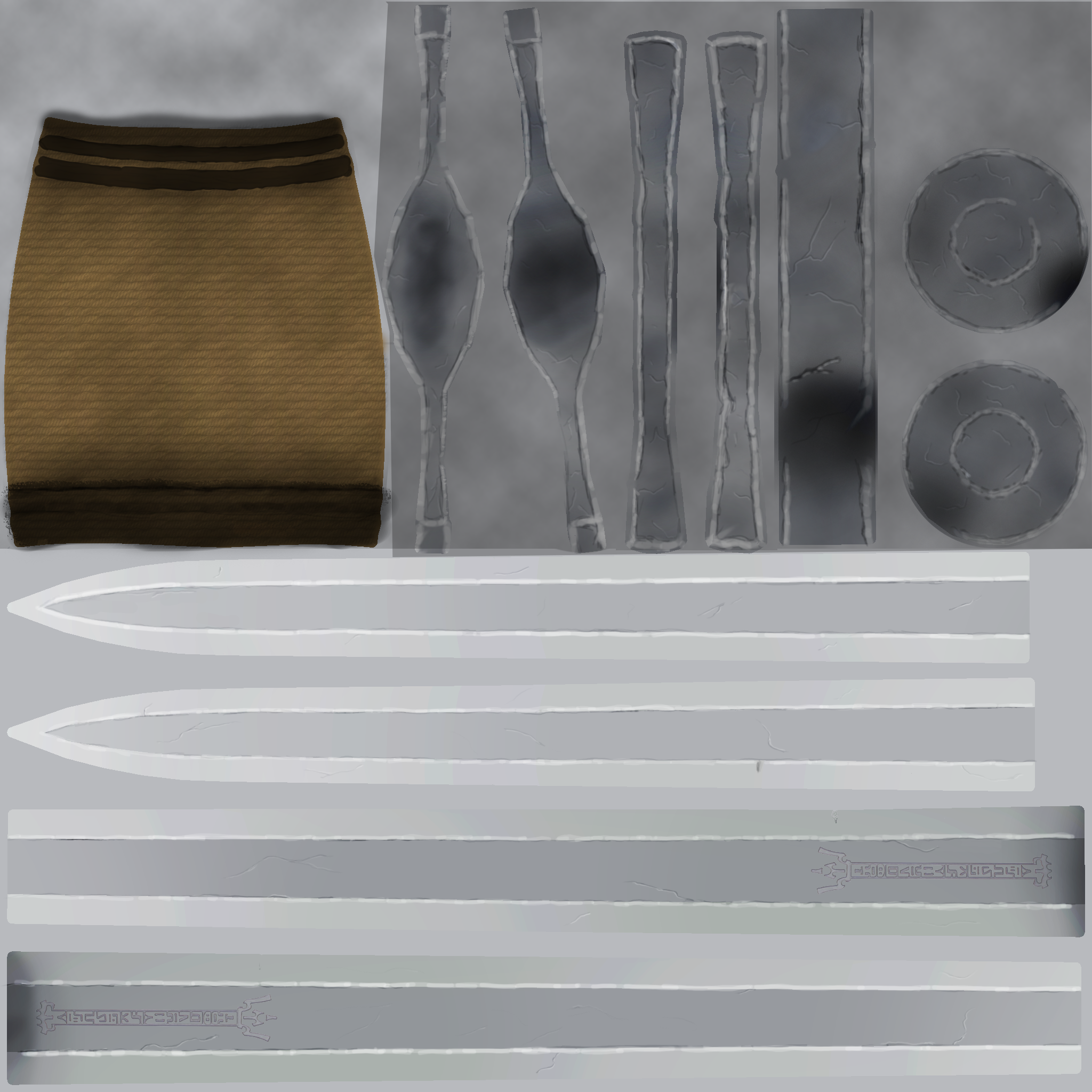

    I started off with doing the texturing for the sword.
    Painting done in Blender
    Added some detail in Photoshop using the UV export as a guide
    Here's the final result for the diffuse on the sword:

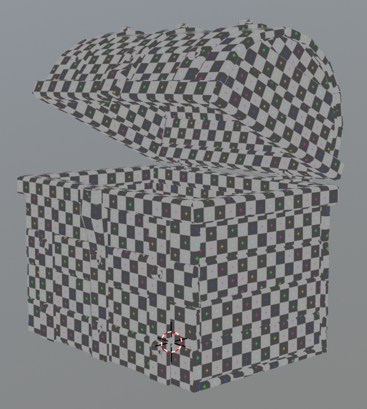

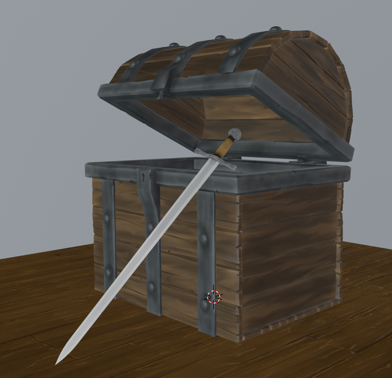

    Chest texturing:
    With DVC
    Final with an additional floor texture
    captainbedpan Awesome job texturing this week, Erik! The details on the sword are great: Thread/hemp-like handle, edge and scratch detail, the rune design - It's all really nice and well done.
    The treasure chest looks good, I'd say on par with the one in the course. But compared to the sword it looks under-detailed to me. You set the bar a little higher with the sword and I would have liked to see the chest match it.
    Still, you've done excellent work this week: It's an A+ from me 👍

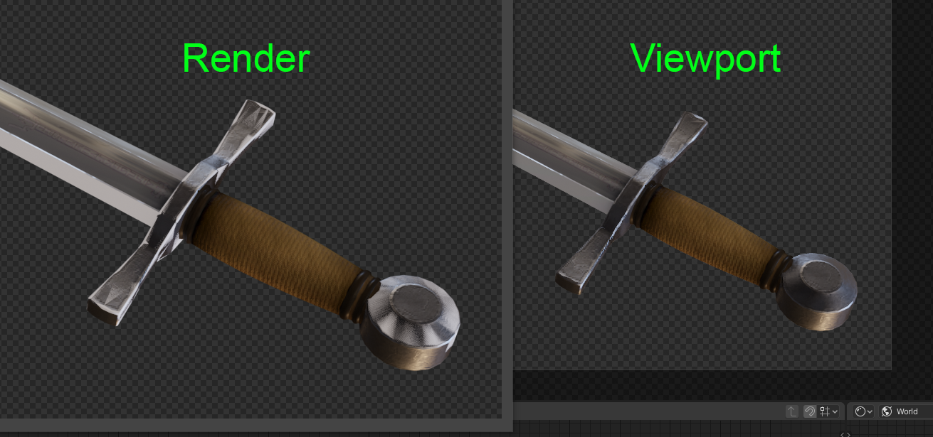

    Been working through shading my sword and I have noticed that there is a difference with the render and the viewport with Eevee. I know that Bloom doesn't come through the render and that we are to add a glare node in compositing, but this appears to be something else. You will see the artefacts on the guard and pommel. I have checked that there isn't extra geometry by using Merge by distance and no vertices were removed. Any help would be appreciated.
    captainbedpan The Viewport looks great!
    I can't tell from these images what is going on, but do you maybe have something hidden in the Viewport, that is still rendering?
  • Erik Sharp(captainbedpan) replied
    spikeyxxx Thanks Spike! I was rendering a collection instance, but forgot to turn off the original collection. I should have caught that.
    captainbedpan Don't worry, that has happened to me many times;)

    Homework submission week 3
    I have really enjoyed this course even though the work took me longer than I thought it would. I look forward to practising these techniques with my own ideas as others have, but I thought that following along initially would give me the best chance of success without too much frustration. Looking forward to the next class.
    captainbedpan This is a great final render! Everything really came around full-circle, Erik.
    Detail looks ways more consistent between the sword and the chest now. Whether you added more detail or it just came out well in the material, good stuff. I really like the golden illumination from inside the chest. My guess is you put a yellow lamp in there, seeing the bright reflection on the chest rim. That's an excellent choice to sell the golden-ness of the treasure 👌
    My only suggestion is to desaturate the floorboards so A) they don't blend in with the chest as much and B) the chest stands out a bit more:
    That's a tiny note though. It's an A+ from me this week 👏
