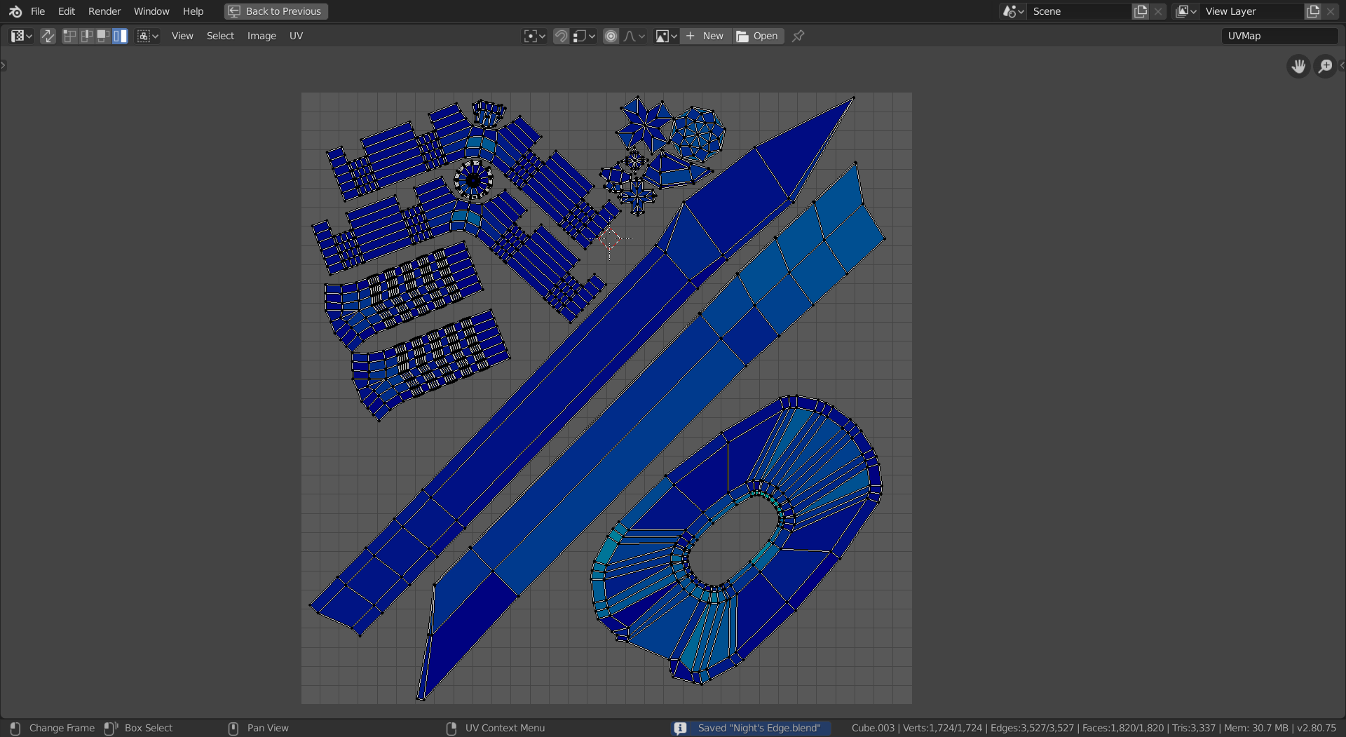

    Here is my final UV layout.  What do you think of it?  The gems were a pain to unwrap.
    Never mind, they weren't final.  They were close, though.

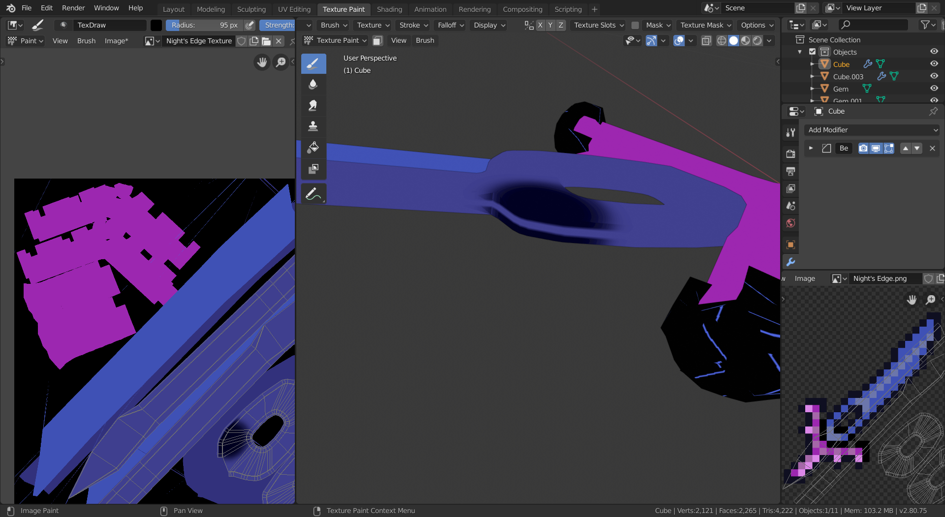

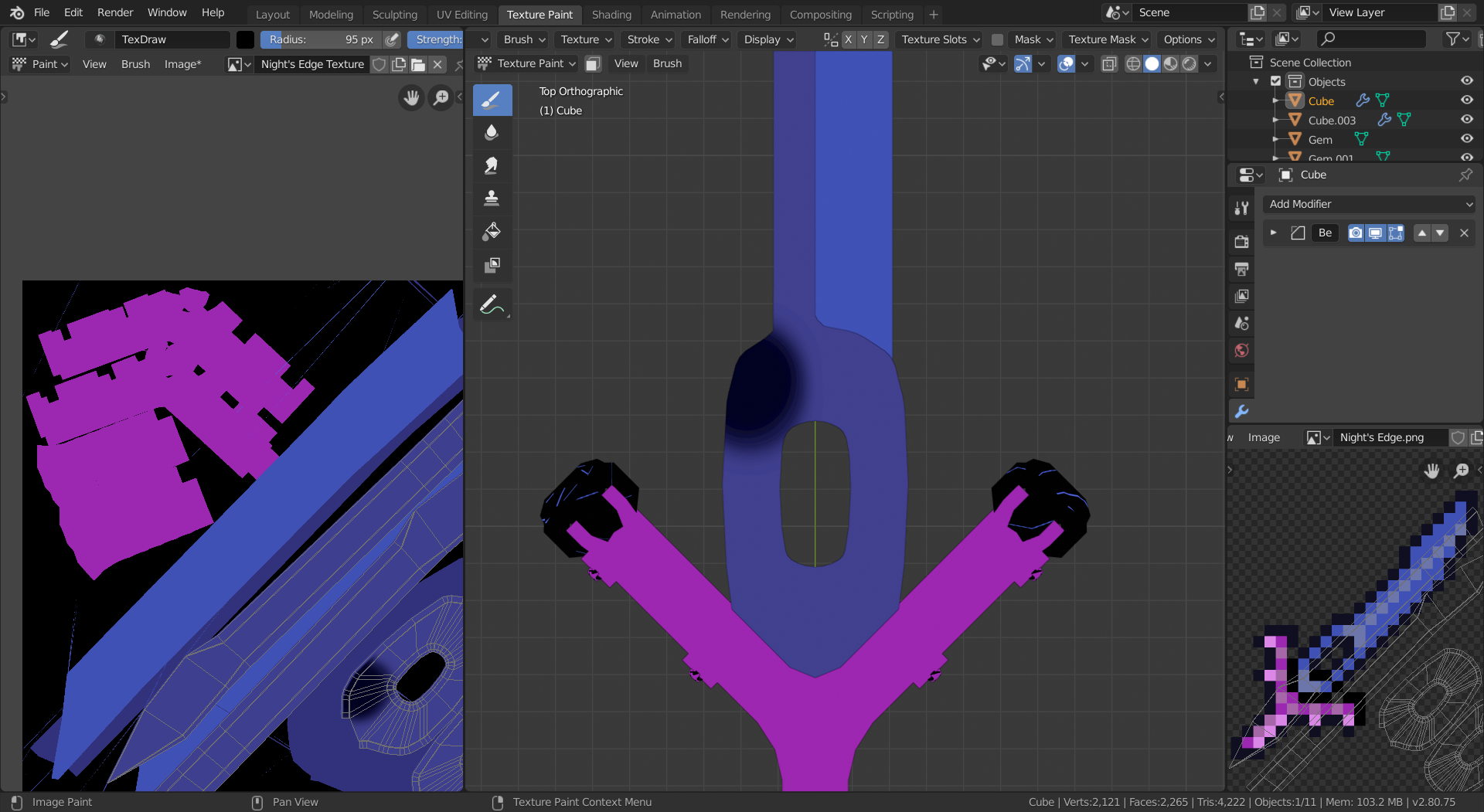

    I have a problem with texturing.  How do I paint over the edges?  Here is an example of what I mean.
    It looks fine from the top...
    ...but from the side it looks awful.
    How do I fix this?
    williamatics In the Tool Settings, under Falloff, try disabling Normal Falloff.

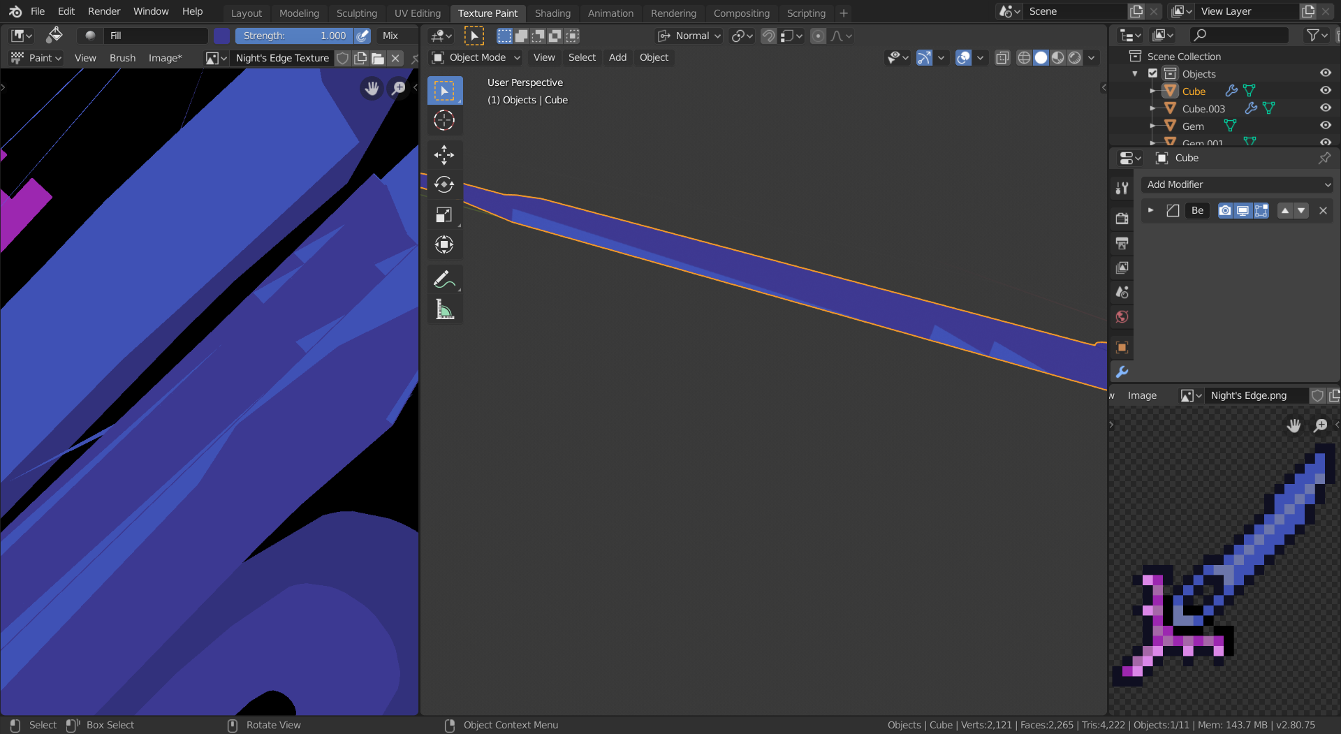

    spikeyxxx Thanks, it worked!  I have another problem, though.  There are three faces that ignore the fill tool.  Why?
    williamatics (Maybe try this in an incremental copy of the .blend)
    Select everything in Edit Mode and unwrap again. It is possible that some faces weren't selected when unwrapping last time...
    Make sure no UV's are overlapping. Set the margin high enough, so that you can increase the bleed value to 10 or so.
    If there are still problems, you could try applying the modifiers.

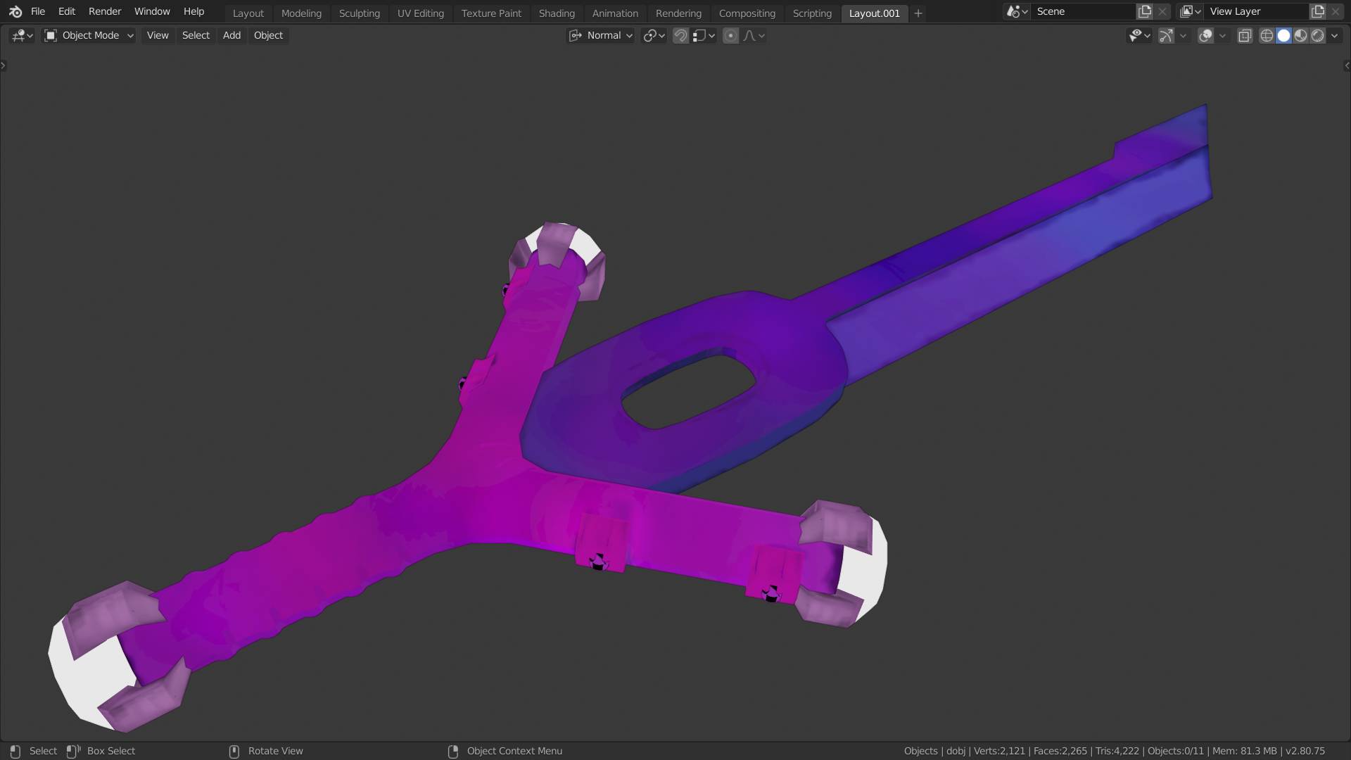

    I had a great idea for a really unique texture for the Night's Edge, but due to some problems I have been delayed.  (Thank you spikeyxxx and jjamesley for helping me.) That means I'll have to resort to an ordinary texture. Here is what I have so far. Now that I know what I'm doing I should be able to finish it tomorrow.
    Trying to make blue and purple metal look good will be an interesting challenge for next week...

    williamatics Nice job finishing up your texture! I knew this one would be a challenge, both the interpretation and how I could grade it. You're doing some good things here, like the color tone variations across all color as well as the edge highlighting.
    However there'es one thing that keeps me scratching my head: What is this sword made of? The texture isn't representative of metal, paint or wood. Perhaps it's plastic...so a toy sword? Since it doesn't currently read like a known material, it's difficult to relate to it and therefore ambiguous.
    Maybe I will see it plugged into material and it will make perfect sense. But for now it's not so clear. Nor is it clear from the source material...So it's a B+ in my book. Make me see the light with the shader!

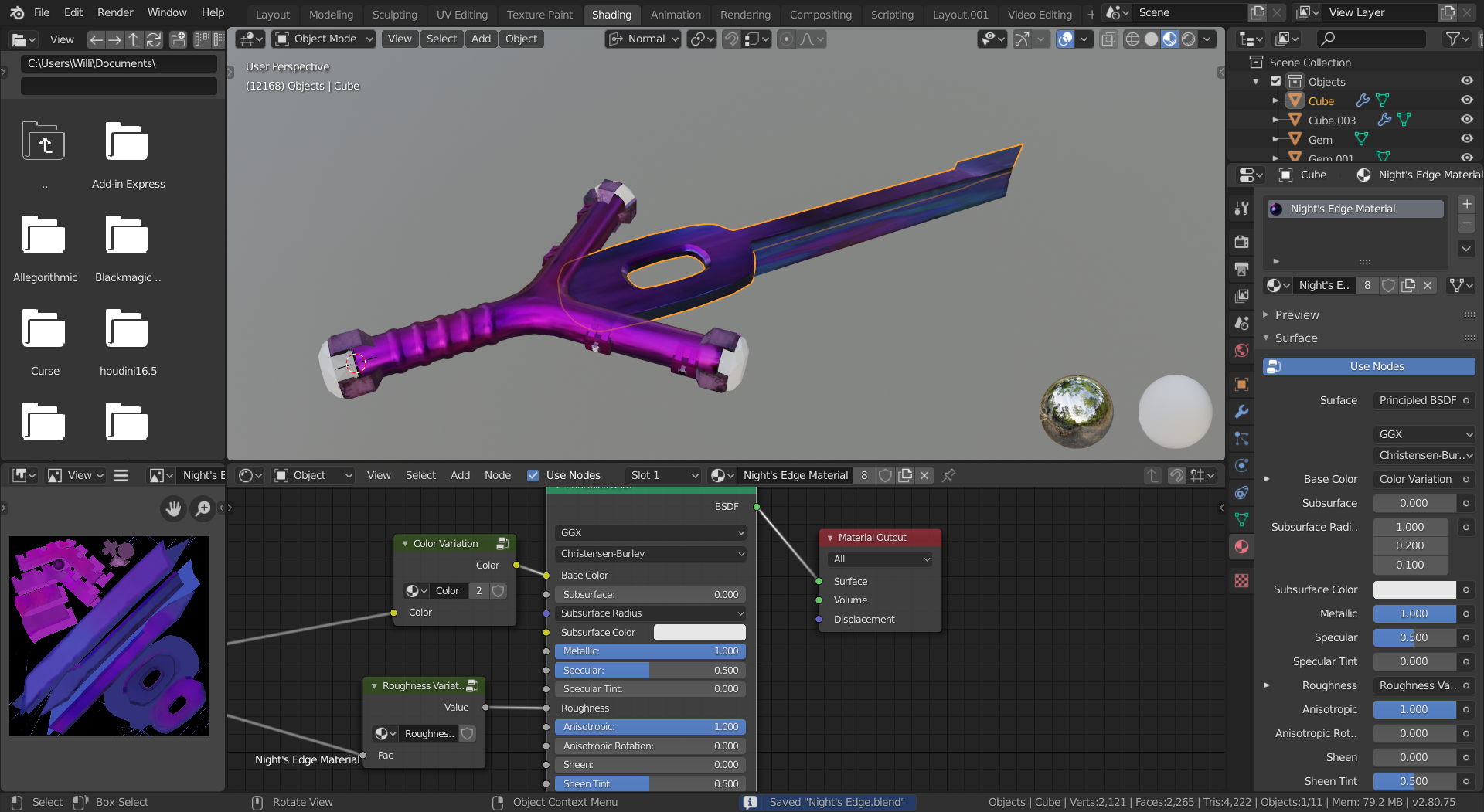

    I have no idea what I'm doing.  Could somebody please point me in the right direction?  I'm trying to make it look dusty.
  • Matthew Fricker(frikkr) replied
    williamatics I used this tutorial a couple of years back to learn how to add dust to a model. It should still be relevant as it is really just nodes and they haven't changed a huge amount.
    Hope it helps
    https://www.youtube.com/watch?v=ZmrCoGj9m2Y

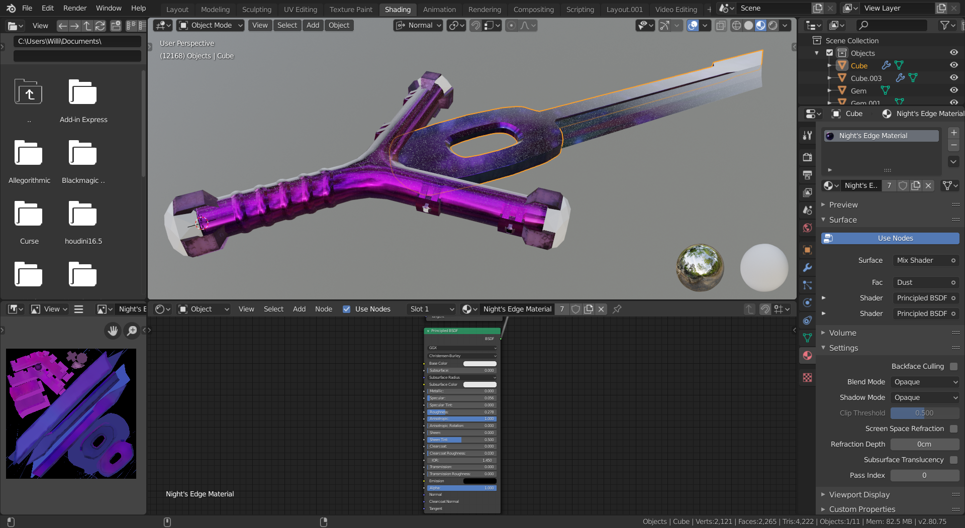

    frikkr I can't get it to look right.  What settings should I change?  Here is a screenshot of what it looks like and the shader that the dust is using.
  • Omar Domenech(dostovel) replied
