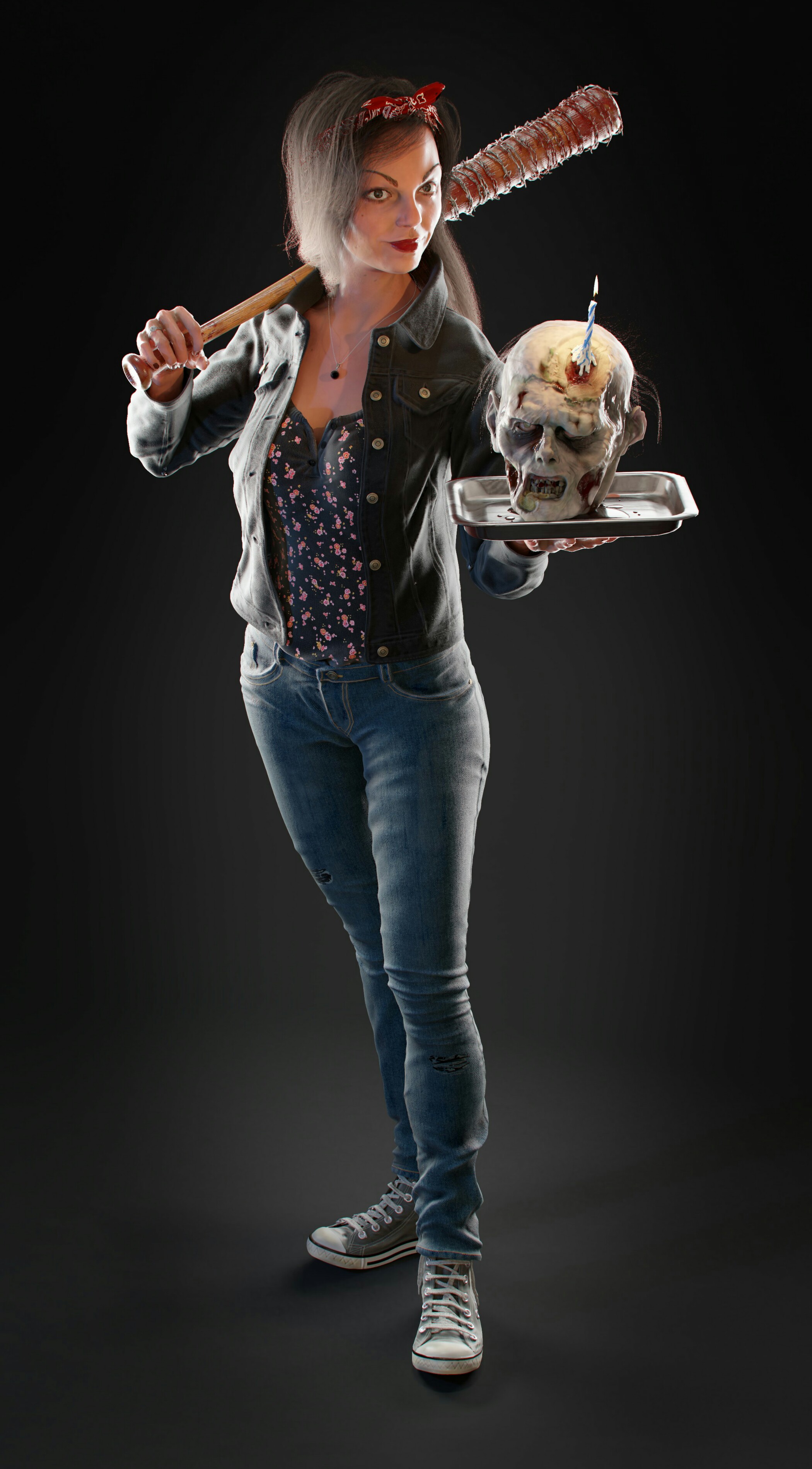

    some health issue kept me away for a while but i m happy to be here again
    i just finished a character project, and i wanted to share my light set up with the classe
    wish u like it
    i uses 2 strong  spot light as rims , 2 bleu fill light with a very low strength HDR , and a key ligut at the candel !
  • Jack (jack07) replied
    mmalhomsi Amazing as always my friend! It's like I can touch that zombie head!
  • Grady Pruitt(gradyp) replied
    mmalhomsi very nice!
    Wow, you went 110% on this render, mmalhomsi! Welcome to class :)
    So much texturing and modeling work in this image - Wow. You've done an amazing job. The strong rim lights on each side help the character pop off the background. Without that it's likely the dark coat would be lost. Good stuff. In general all the materials are well crafted; very believable and very tangible. A+ work!
    mmalhomsi Better late than never!  Good work.

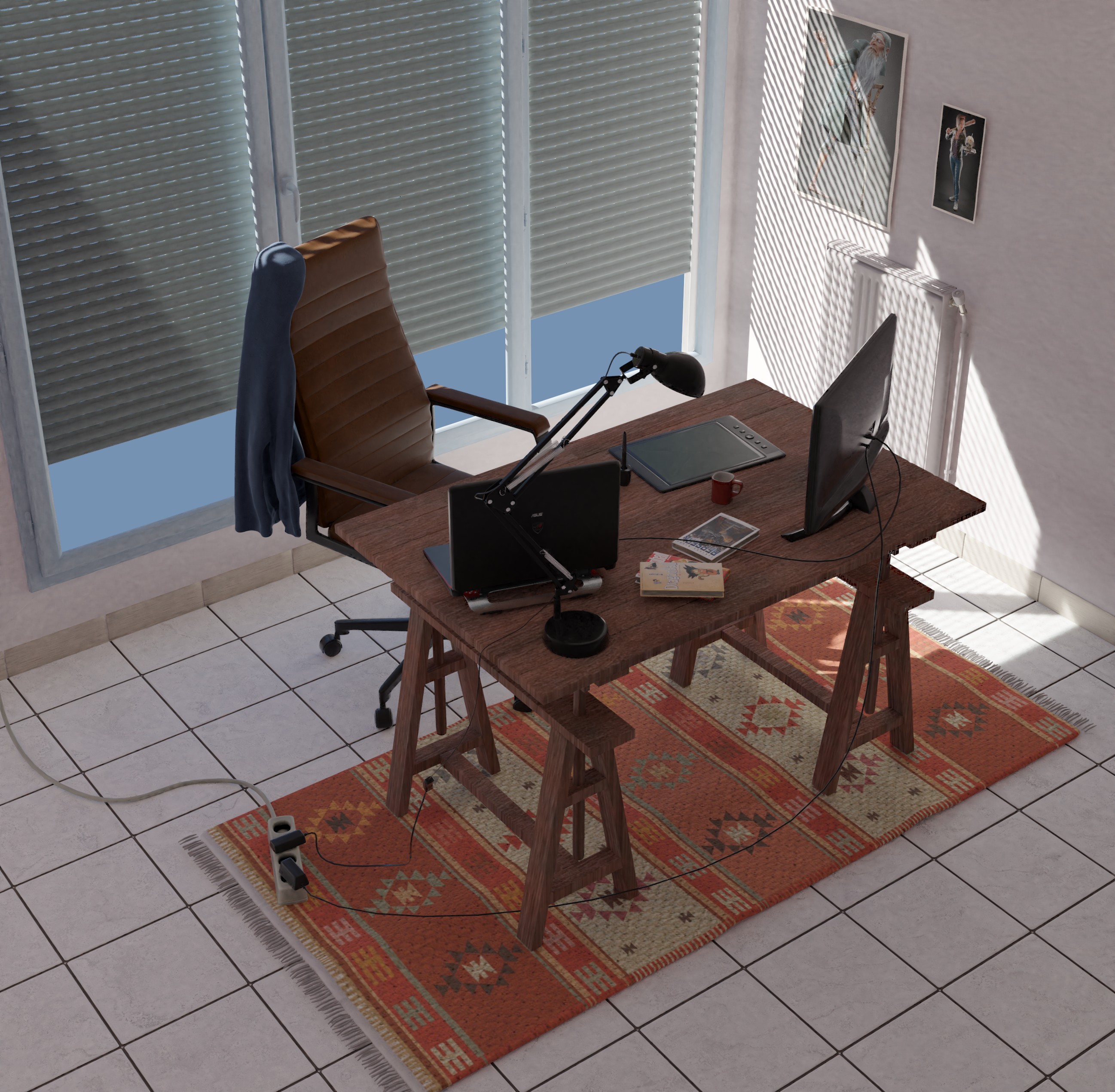

    Homework Week 4 submission
    I know Nothing about the arch viz stuff nor about photography , so i wasnt sur what to do ,
    i choose to model what i call my Blender corner , so i'm happy to share with u .
    it was tedious.. mesure every thing modeling..shading ..a lot of work for a mediocre result.
    i wish i have more time ton fine tune the shaders ( at least Breaking the reflection with some surface imperfections)
    render time was a pain ..thank u Kent @theluthier  for getting us out of our comfort zone !
    i'll be doing the light match later ..
    mmalhomsi I like your Blender corner! You got this modeled fast considering we only got a couple of days for each homework. Well done 😄

    You work fast! High quality models as always! I think that maybe a HDRI background and a different angle for the sun will give those models justice :P

    mmalhomsi Wow, yeah, that's a ton of work to build everything from scratch! I wasn't expecting people to do that this week but rather use one of my provided scenes or use an existing one of their own. Heh I do love your art on the wall!
    It's impressive you were able to do so much in a week's time and considering it's outside your comfort zone. You've earned an A on effort alone. I like the theme a lot and the models themselves looks great. Lighting is believable too. Interestingly there's still a lot of light getting through those closed blinds 🤔
    Here's a couple notes:
    • What's your camera focal length? My feeling is that it's too telephoto (too high in mm value) to be possible in a room this size. It's flirting with an orthographic vibe. I suggest knocking it down between 35-50mm to feel more believable.
    • I'd like to see more reflection on the tile and the wooden desk. Right now they both seem 100% diffuse. Reflection interest would be great for those materials. I don't mean high gloss but even a little.
