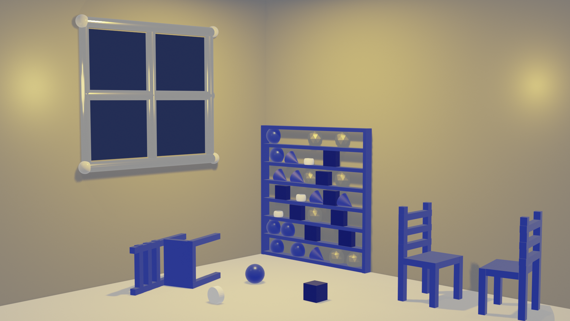

    This image is what i've made the first time i've done this exercice in the class of January
    And... this is my current level and my submission: (I dont know if i have to upload it into sketchfab or not)

    galledark  I feel your pain about primitives haha, but the improvement is very noticeable. I'd say the chairs could *possibly* be a bit too small but that could just be my eyes playing, also nice touch with the materials, makes it really stand out.
    galledark Good work, definetly seeing improvements, and yeah, having to work with just primitives makes things bit harder. but also more creative. :)

    O that good old edit mode. Can't really live without it... 😉
    You certainly improved, great work! Love the color and the lighting 😊
    galledark I like to see that you're taking this class again and showing us where you were in January. I definitely see improvement. Nice work, Yannis. It's an from me.
    And don't worry: Edit mode and Sculpt mode are around the corner 👌
    I agree; there's definitely improvement!  Good job!

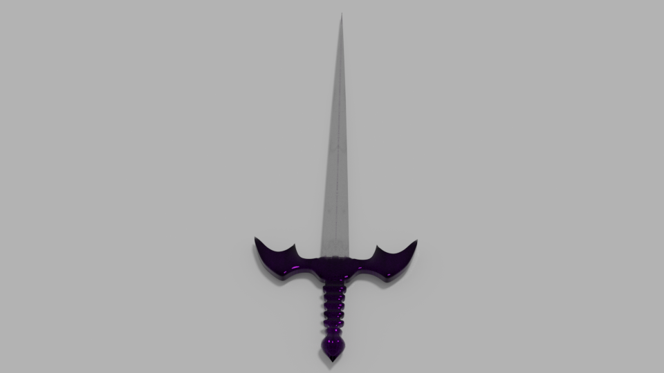

    8 months ago (in january) i've experienced the joy of edit mode toward a project: a sword.
    The name of this sword is Cigüe (it's a poison).
    Here was the sword:

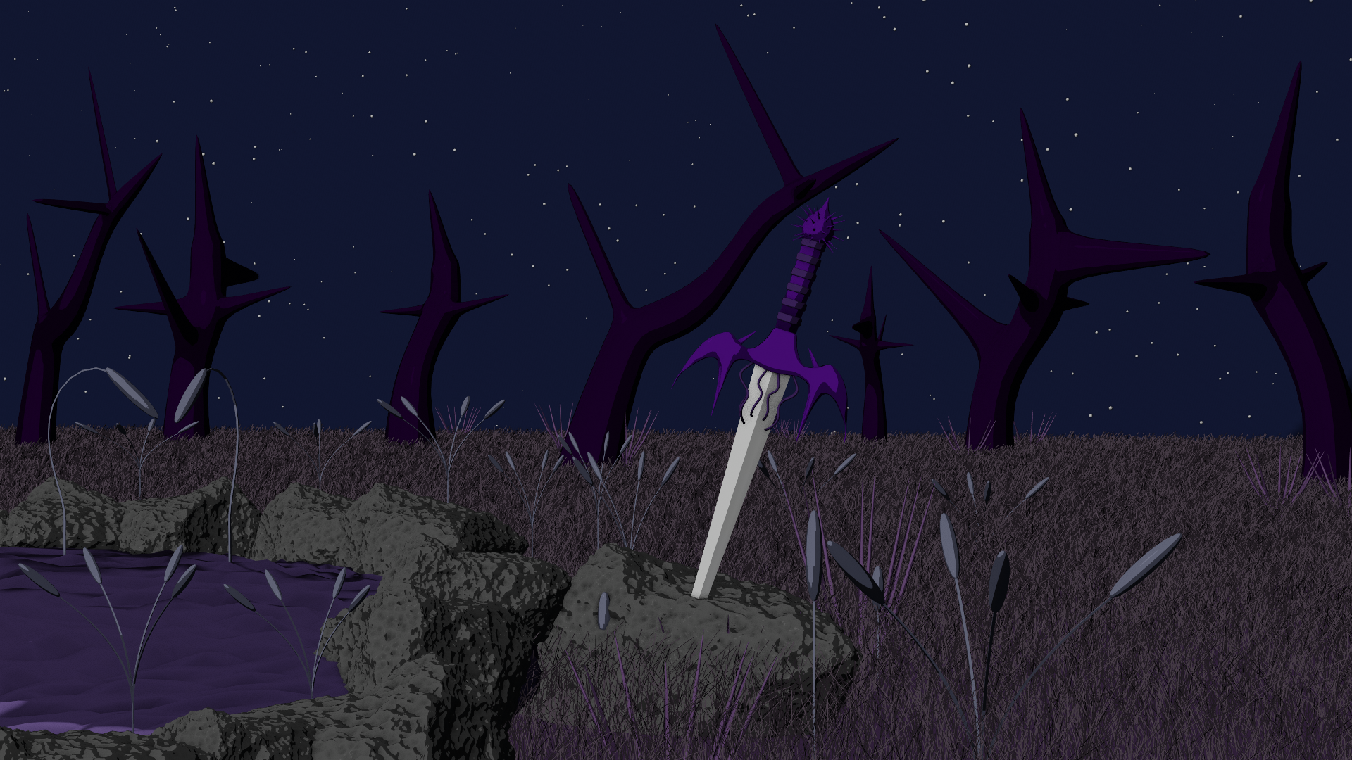

    I decided to re-create it again, but this time with some...improvements ^^
    This is the final render:
    I have to thanks ggolden-kitty  for his advices about matcaps it helped me to made this cartoonish style that i like a LOT ^^
    AND: the course of jonathan lampel about grass and particles... this tool is so powerful....
    galledark That's a huge improvement indeed, it's a complete landscape! That matcap works perfectly here. Nice little scene, really enjoy it 😊 How did you make the stars background? and the dents in the rocks?
  • galledark (galledark) replied
    ssmurfmier1985 Thanks miranda glad you liked it =)
    For the rocks i just followed this tutorial:
    https://www.youtube.com/watch?v=D3Lq9SOpzDM
    Its an icosphere edited with a subdivision surface (of 5 i think) and a displacement modifier.
    Just be aware that the effect of the displacement (as all modifiers) shows only in object mode. So i had to tweak the options of the texture in Edit mode and switch back to object mode to see the result...

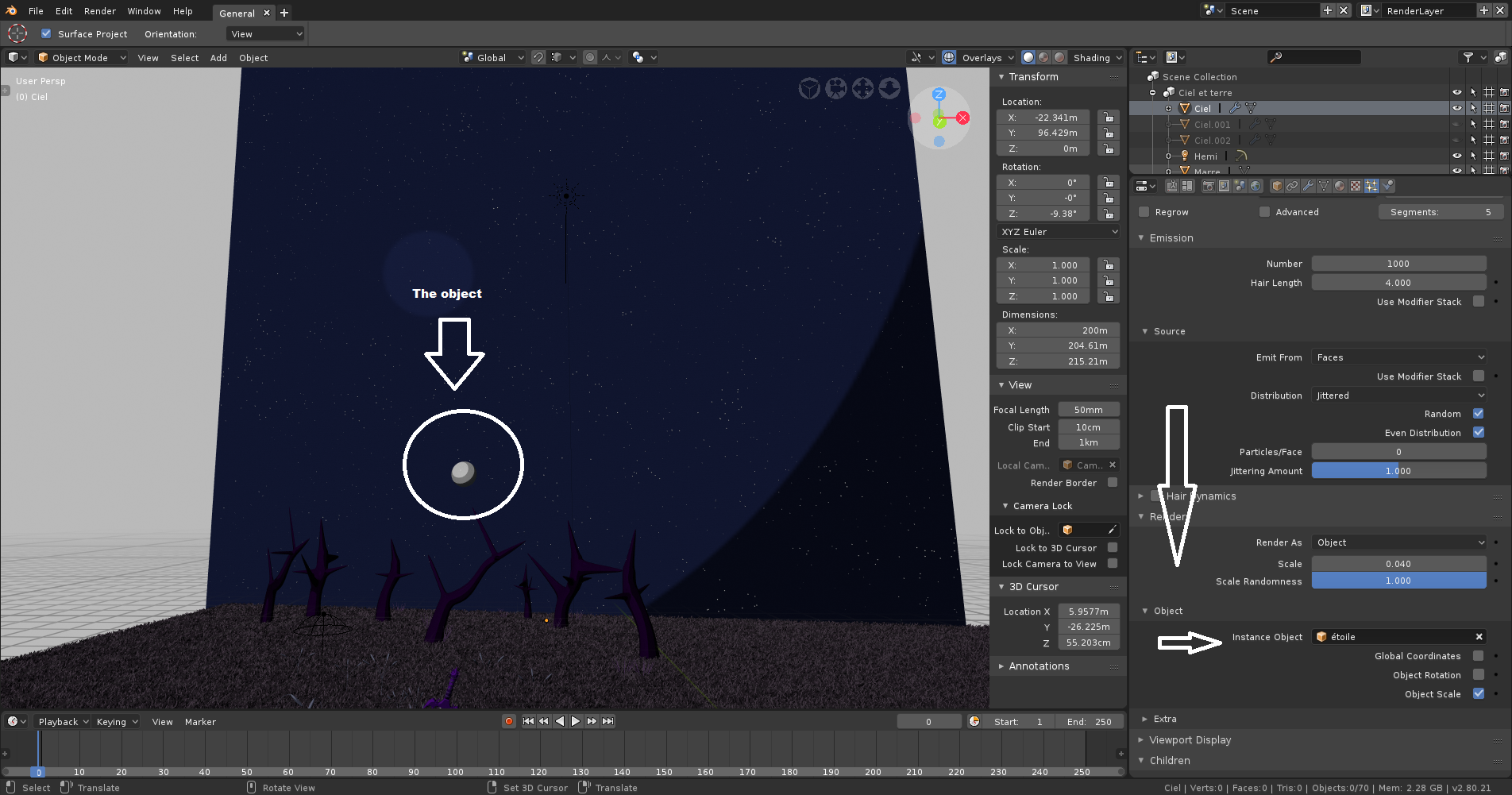

    For the starry sky it's just a plane with a particle system on it.
    I used the technique that jonathan lampel shows into the "creating grass in blender" course.
    In the chapter 2 "modeling with grass" he shows that you can use an object as a particle to create tons of instances of it ^^.
    I just took a sphere (with a emission material) and... POOF !
    (note: the sphere must be scaled a bit larger to see results with this matcap ^^)
    galledark Thanks for explaining! I'm gonna try that out myself when class is over 😄
    Neat!  I like everything except for the rocks and grass.  Those things just don't fit the style the rest of the objects have, so it's jarring for me.  Maybe it's too realistic compared to the more simple objects?  Or maybe the rocks and grass are too noisy compared to the rest of the scene?
    silentheart00 Thanks for your feedback :)
    i must admit you're right i didn't see it before but... The grass and the rock seems less "cartoonish" than the others objects (sword, plant, trees...)i dont know what cause this effect :o
    galledark Maybe the objects are just too complex overall?  Maybe try making a basic rock without the displacement, just a bunch of flat faces, and see if that'll work better with the overall style?  Don't know what to do about the grass, though.

    galledark Very cool approach to rebuild this sword into a full scene. And wow, you're rocking particle grass in there! Way to go all out. A+ 👏
    One minor note: Compositionally it's a little dark. Can be difficult to make out shapes clearly. The cartoony aesthetic is really nice though.
