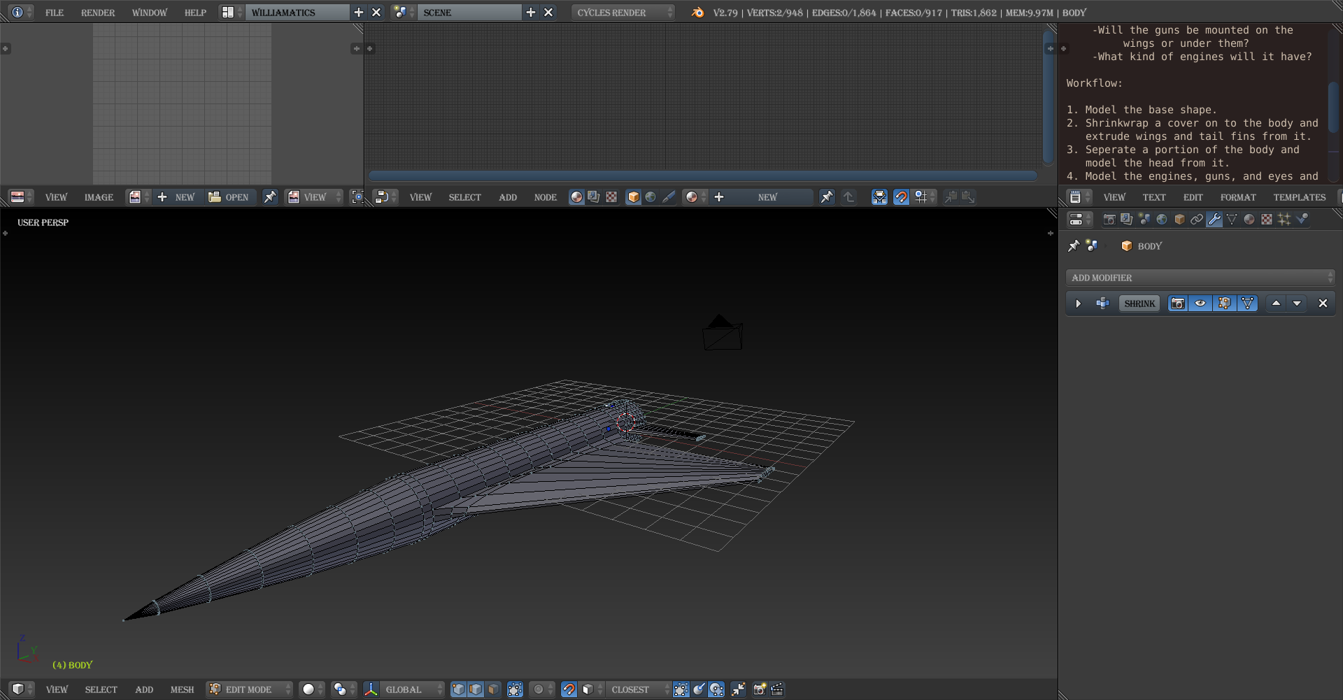

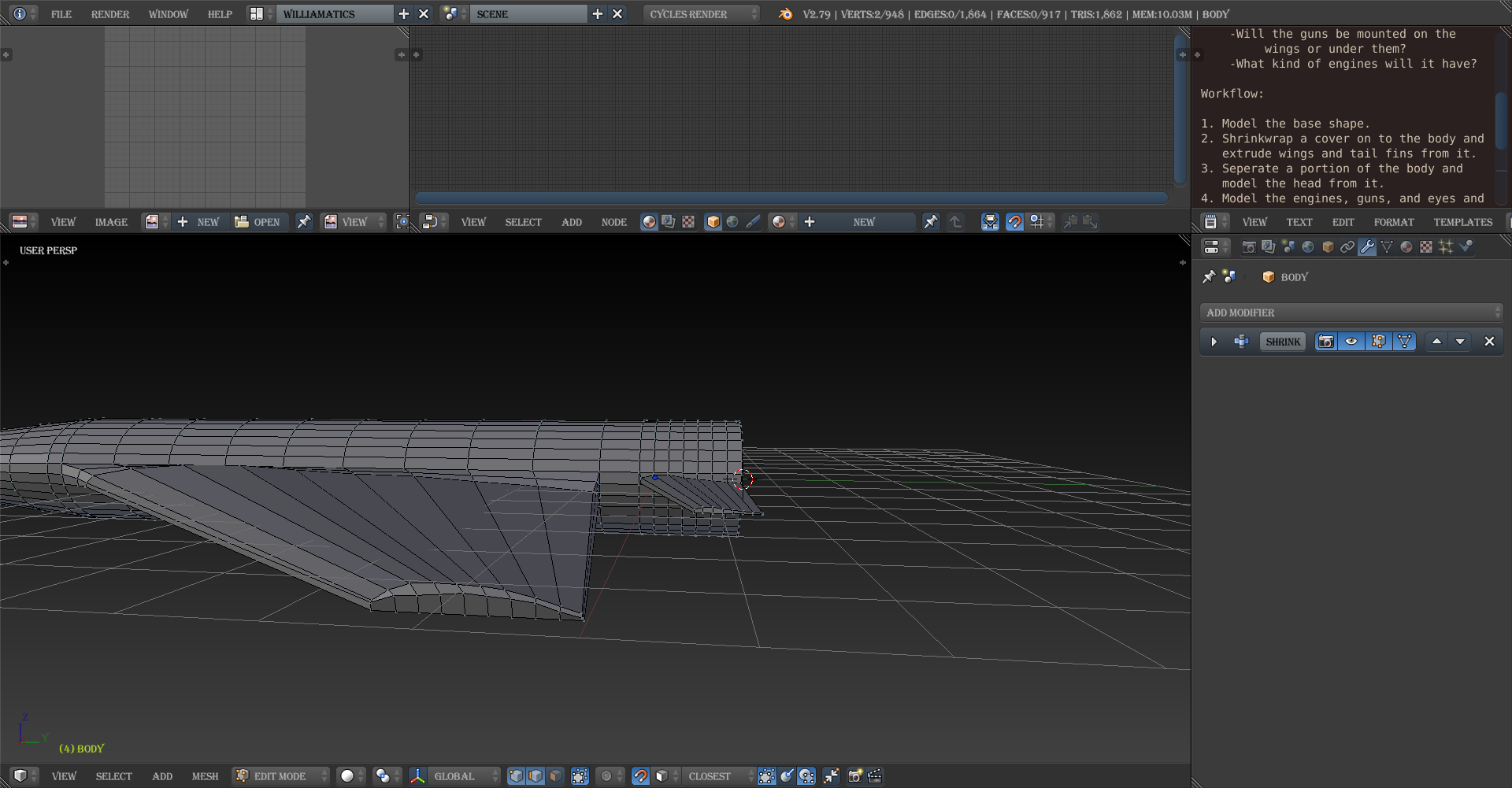

    I have a lot of trouble making protrusions and extentions, which is why I have put my robotic fighter jet on hold.

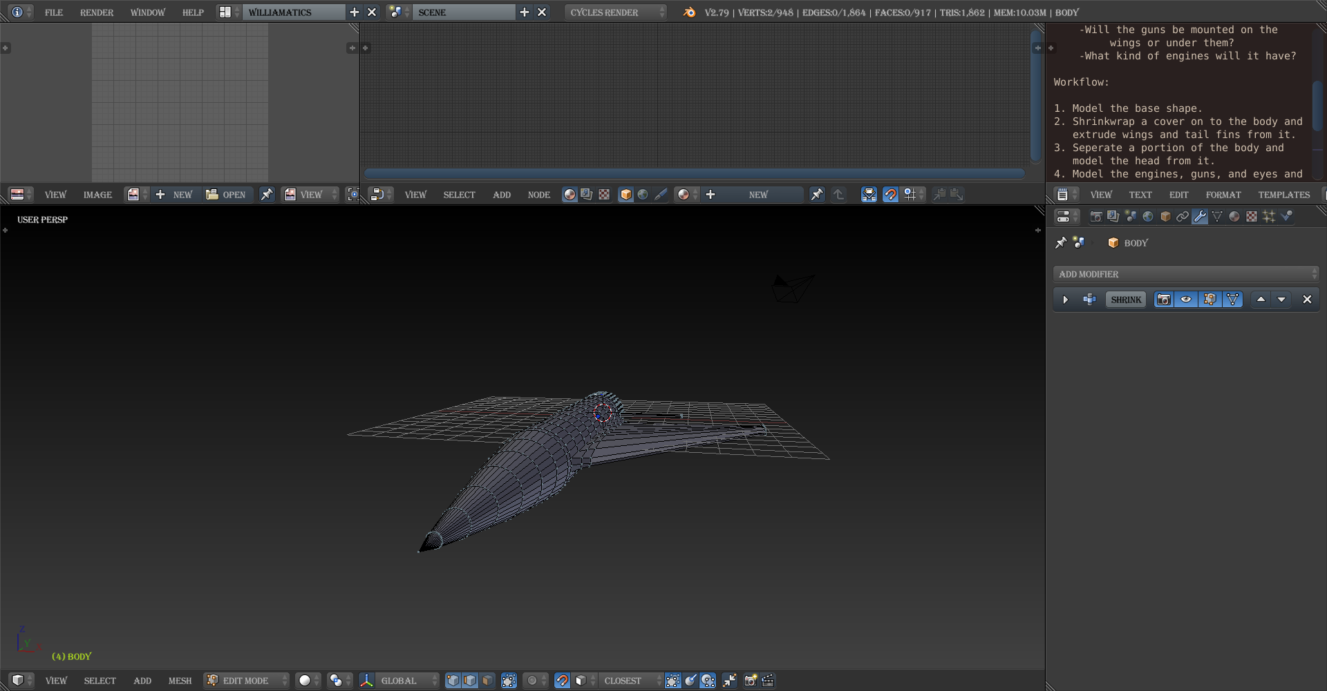

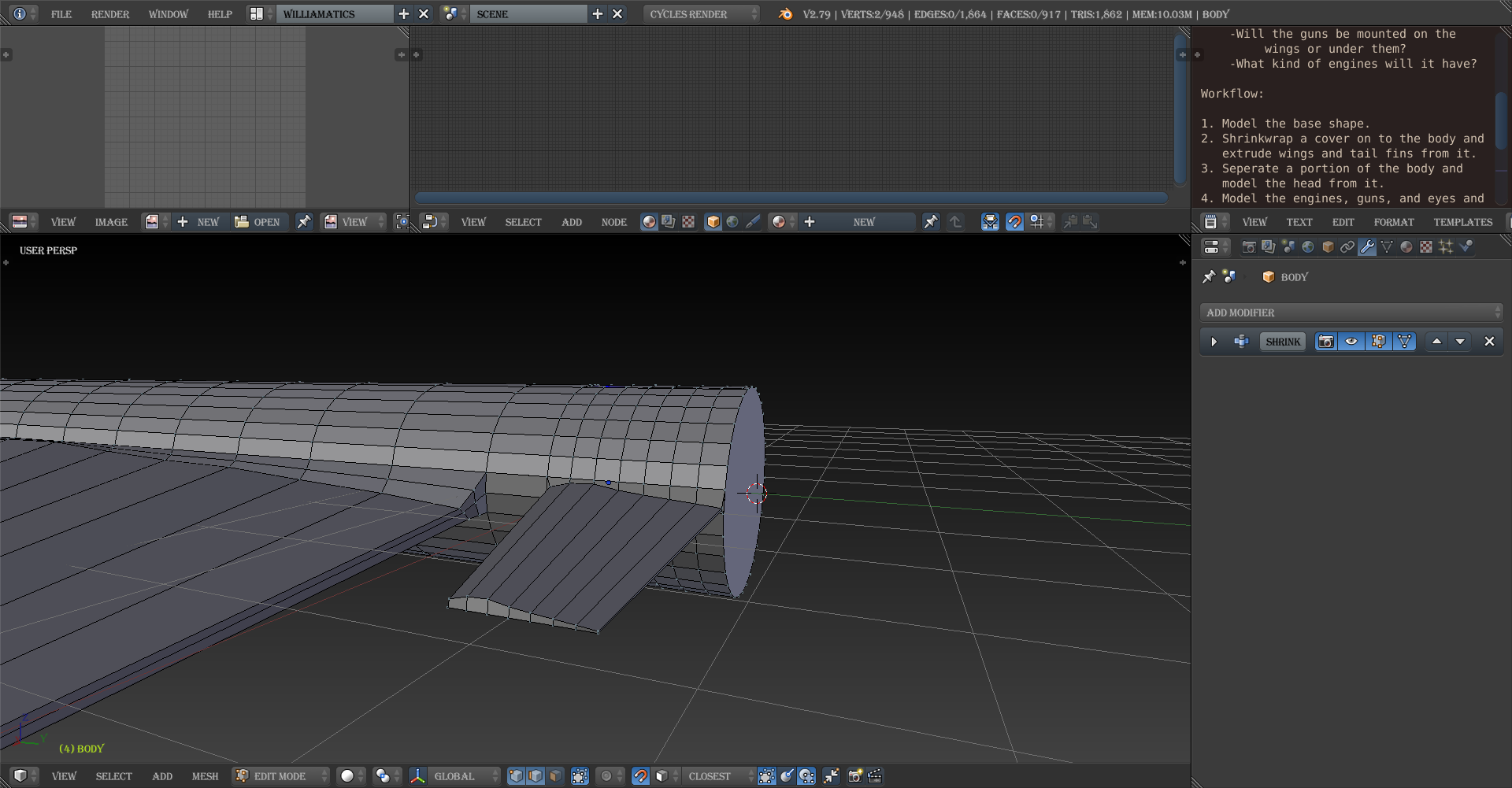

    williamatics Could you give an example of a specific protrusion that you're having trouble with? A reference picture with what you're going for as well as a screenshot of where you're at with your robotic fighter jet (sounds awesome!) would help me give a more practical solution.
    Here are the screenshots (I will delete the other half and add a mirror modifier later):
    I want the final result to look something like these, except with the cockpit replaced by a computer:
    I'm having a lot of trouble with the wings, especially the tail fin.
