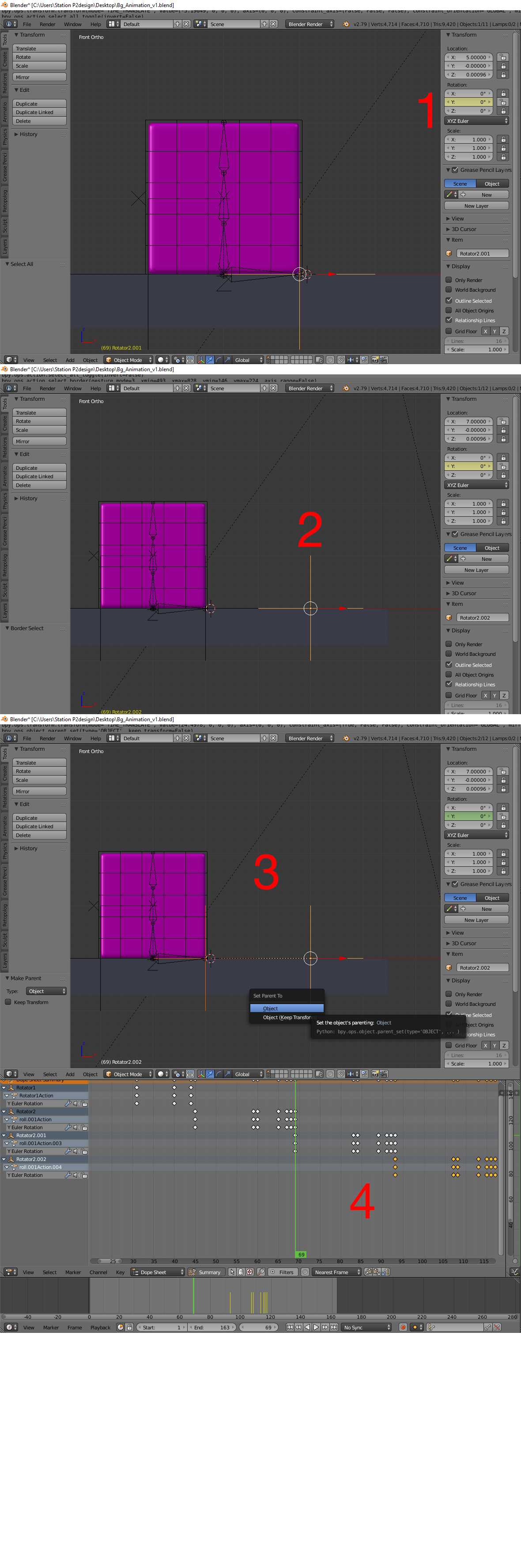

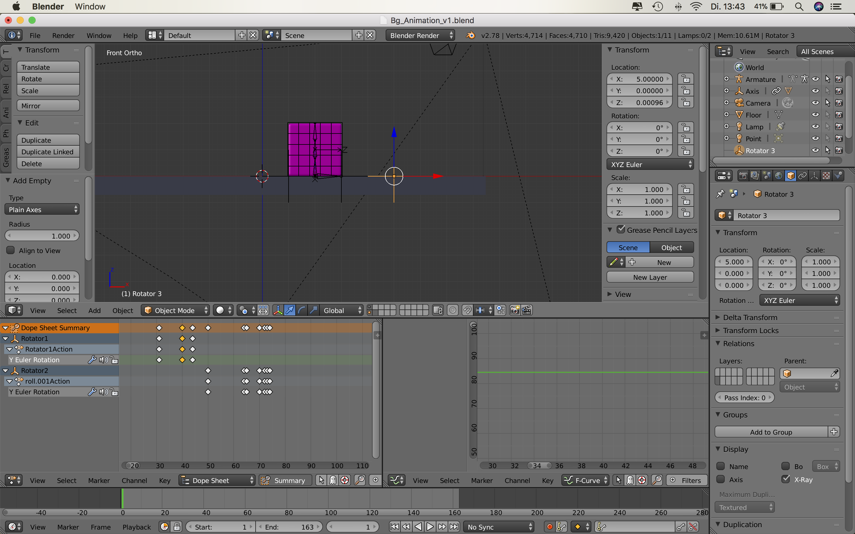

I create an Empty at my desired place :

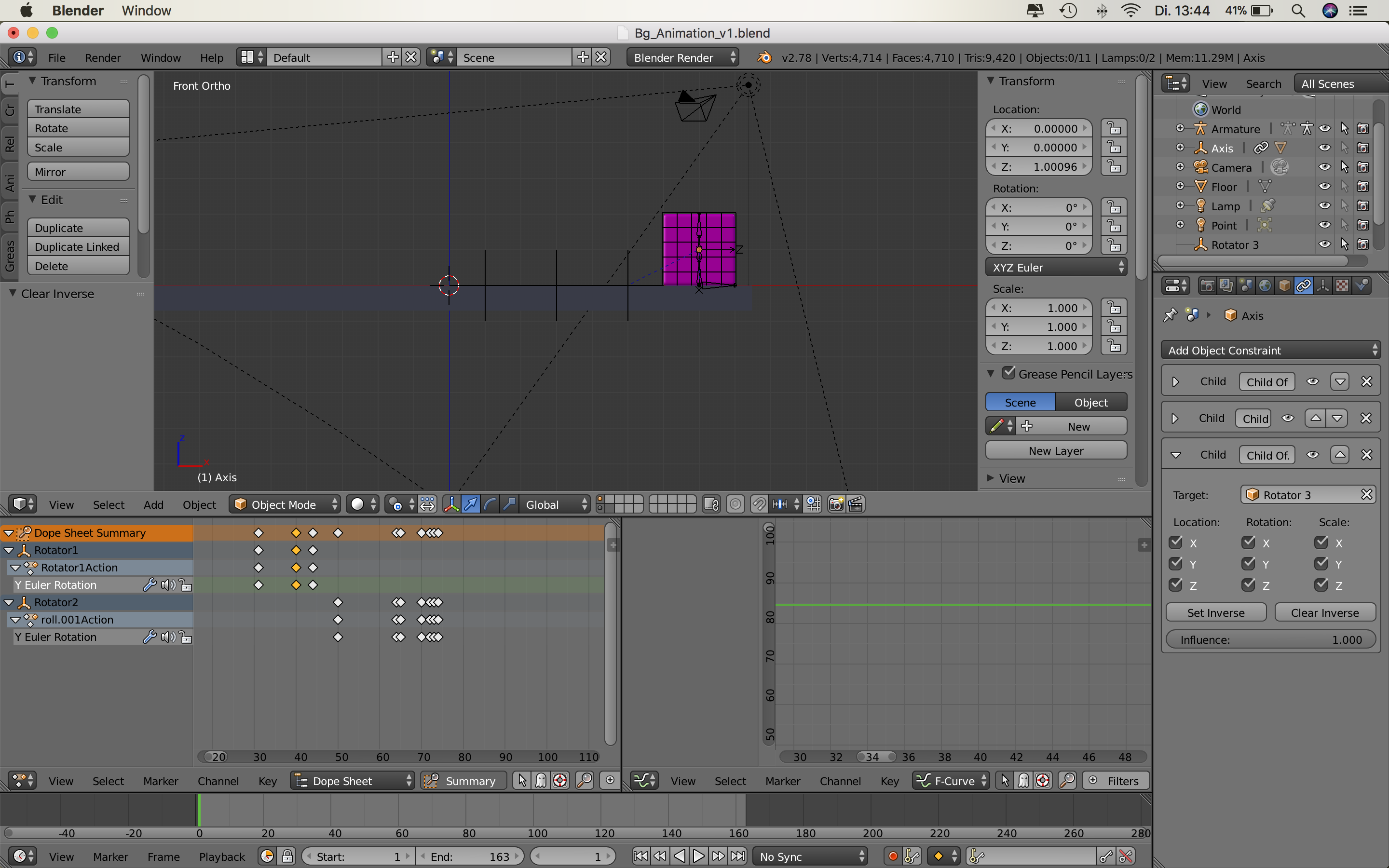

Then I select the axis Empty & create a new child of constraint:

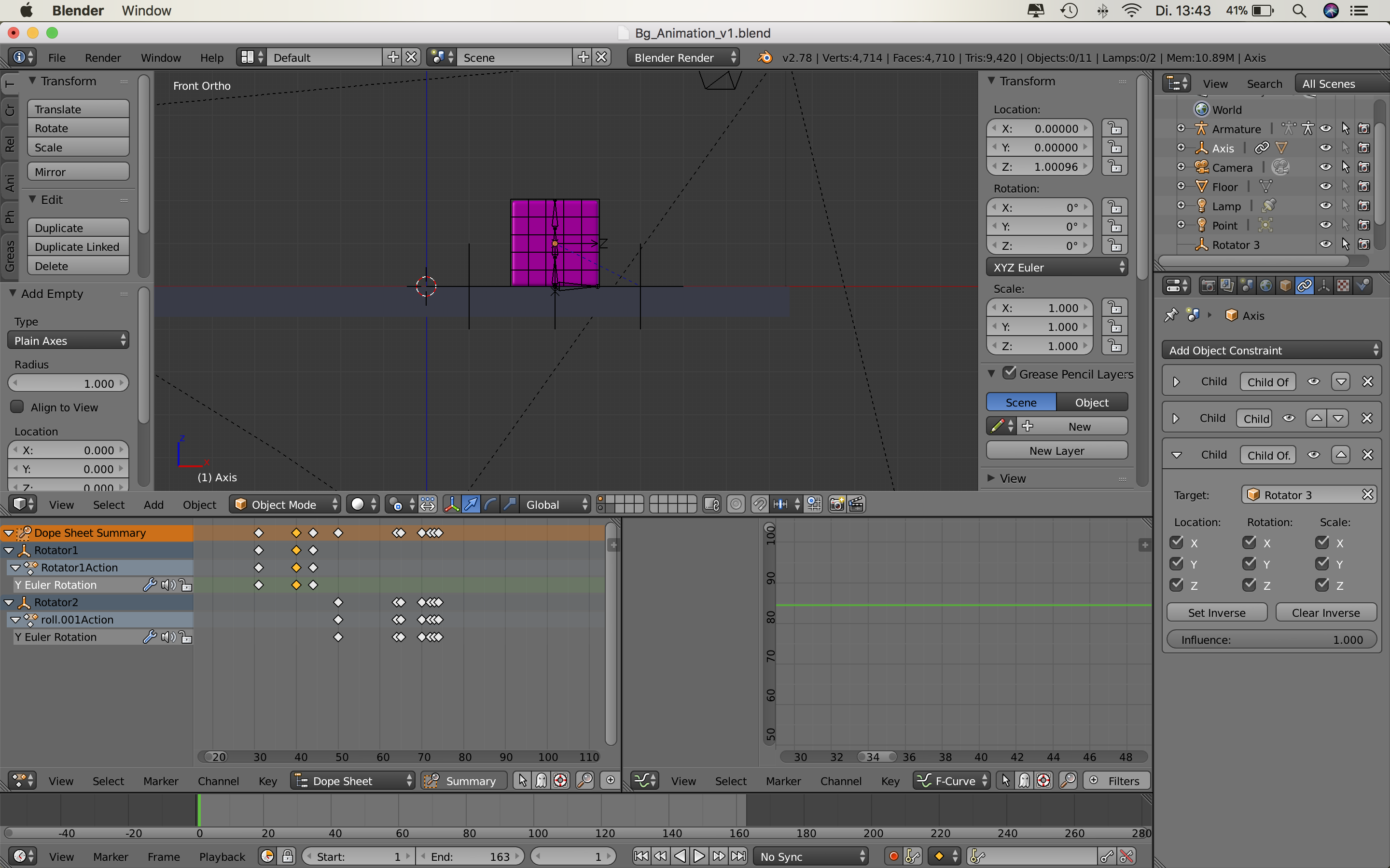

The cube is getting moved, but not too tragic until now. Now I press the "Set inverse Button":
Cube getts messed up. Dang, I press "Clear inverse":
Cube is on top again, but at a very strange position!!
