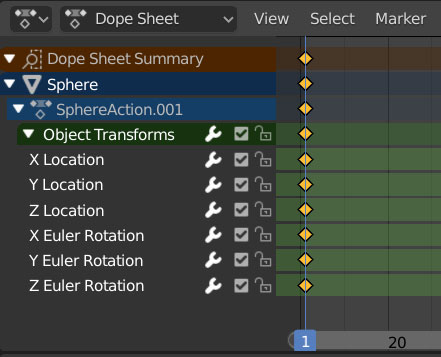

    Now, if you look at your Dope Sheet, you will see a column of orange diamonds at frame 1. Those are Location and Rotation values for your newly created keyframe #1:
