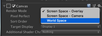

    The UI by default uses Screen Space, which means it'll display as an overlay for your device. This works fine for most traditional hardware such as a PC or consoles, but VR works off a two camera system so it can't be used in that way. Creating a HUD for VR means the UI elements will be in world space. These would essentially float in front of the player, or could be attached to other objects.  To change a canvas to world space you need to select it and on the "Canvas" component change the render mode to World Space as such:
    You can then resize the entire canvas just like you would any other game object and place it in front of your camera. You could also make it a child of the "eye" camera so that it's always moving with the head.
