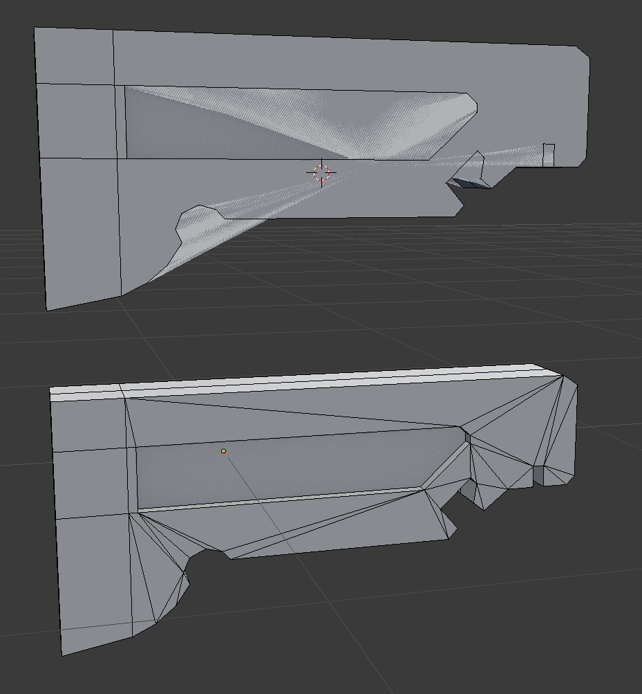

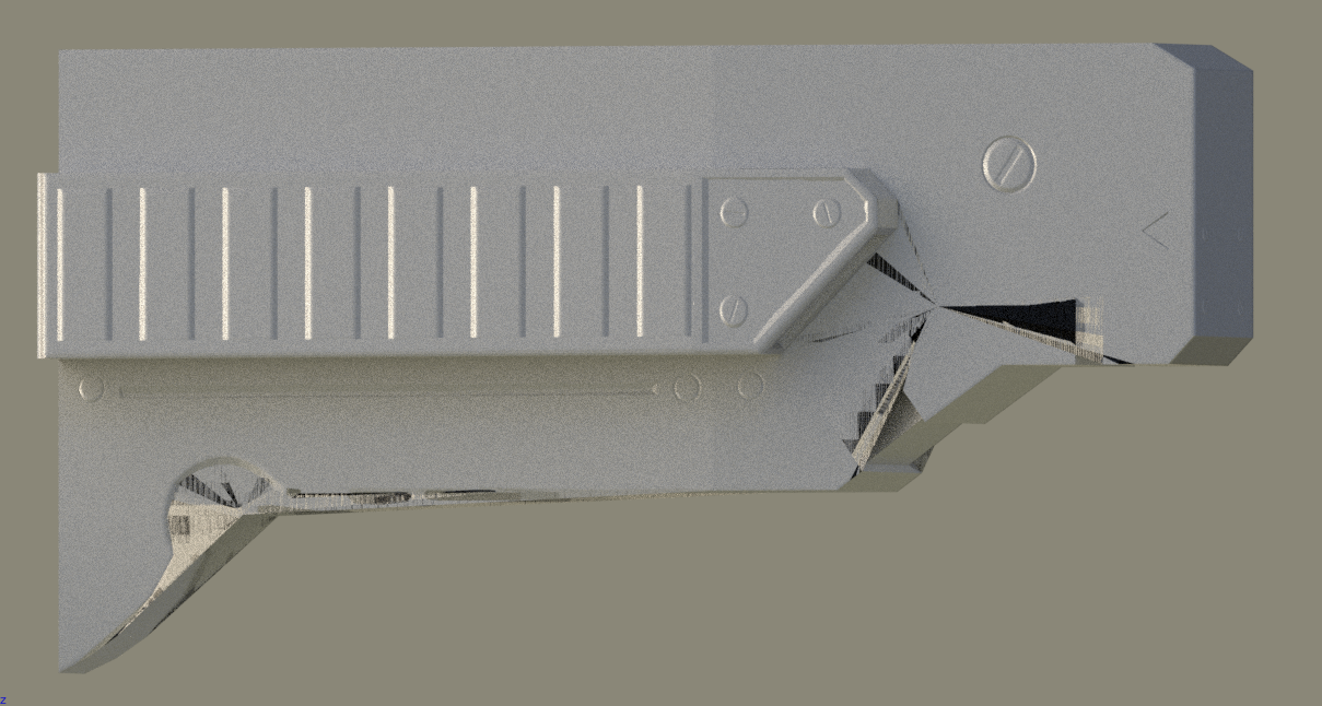

I didn't take modeling course yet, so this maybe not a problem for others.
Subdivision surfaces in the lecture worked good looking result,

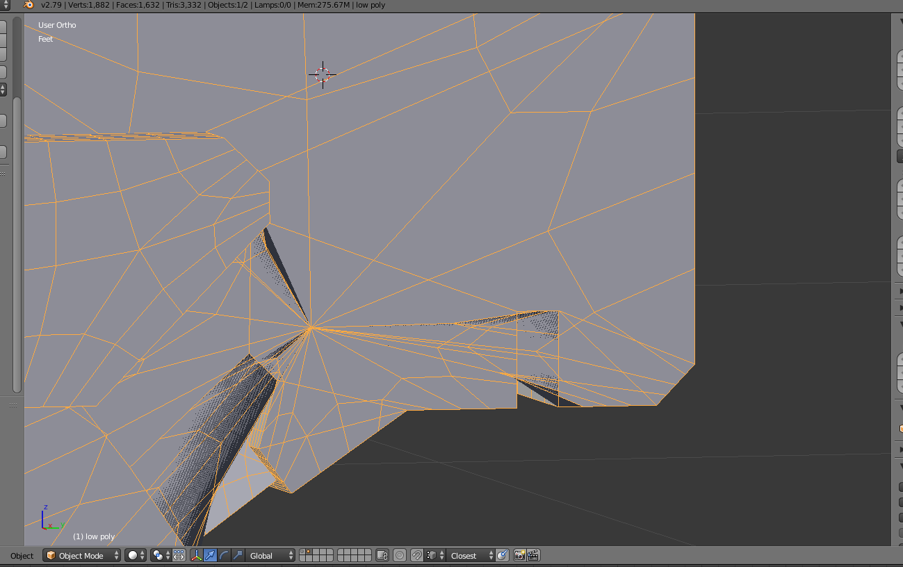

But mine is still get messy with groove. I tried to modify model but topology went bad.
It would be great if modifying progress were recorded.

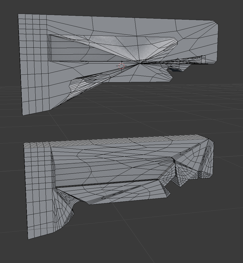

    Hey dduketogo , what's the in-subdivided topology look like in edit mode? My guess is that there's a big n-gon right in the middle there. N-gons are fine to have, but if they produce results like this, then connect some vertices with the hotkey J to tell Blender which way the subdivisions should be going. Or, you could press Ctrl+T to turn the whole face into triangles. Otherwise they'll all pile towards the middle like that which causes some parts to overlap. Hope that helps!
    This:
    Turns into this when subdivided:
  • duketogo replied
    Here is a result. I see how it works.
    The point is "cut ngon to triangles before modifier makes it ugly"
    Thank you.
