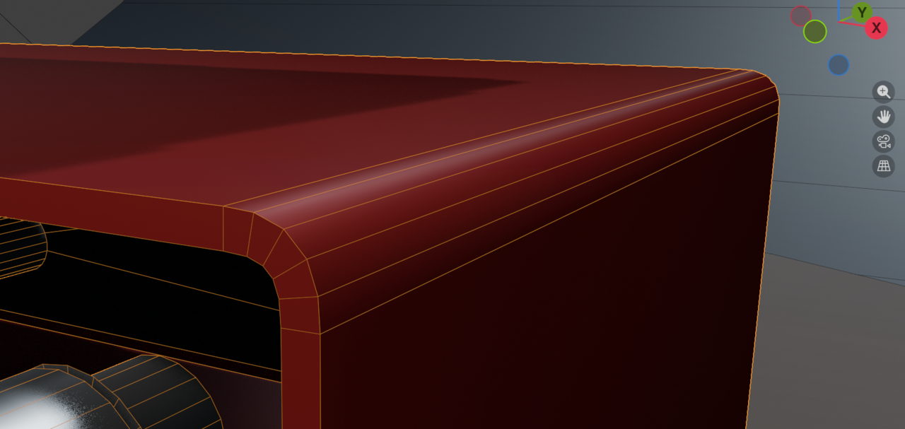

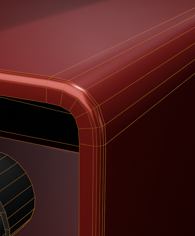

I have a box. Four of it's edges are beveled with multiple segments.
I want to bevel the front facing outer edge it's connected to.
Of all the things I'm aware of to tinker with, it always looks bad.
I have enough sense to presume that the normal averaging between the faces is probably insufficient to get a nice smooth transition. However I'm out of ideas.
I've fiddled with harden, miter outer/inner settings, adding more topology, and a bunch of other ideas. I'm a novice though, so I can only understand so much of what I'm doing lol.
Is there something fundamental I missed? Does this edge look fine to you? I can't help but think it looks terrible.

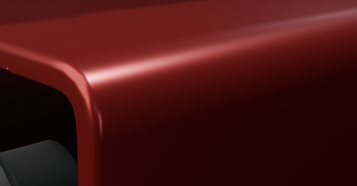

    Hi Jesse,
    You are probably just misusing that Matcap; there is nothing wrong with the Model, as far as I can tell.
    Use a Material (even a Principled BSDF will work) and look at it in Rendered View, maybe with an HDRI for Lighting. Use Auto Smooth Shading and play with the Threshold Angle, if necessary. It'll probably look perfectly fine then.

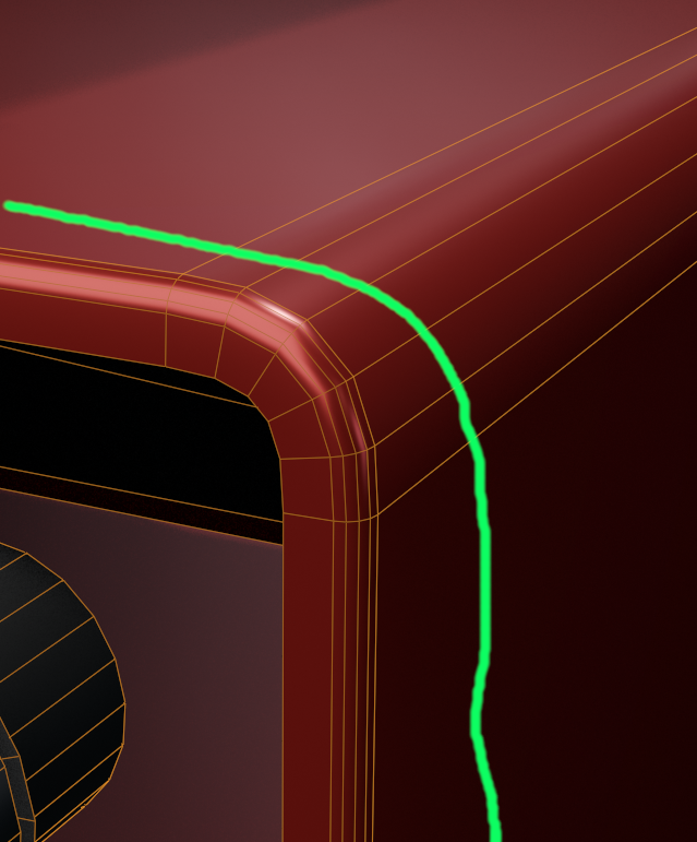

  • Dwayne Savage(dillenbata3) replied
    It's the normal calculation. You can reduce it by adding an edge loop and then slide it until has a smoother transition. you could also manually adjust the normals but that is hard then it sounds. Also make sure you don't have any flipped faces.

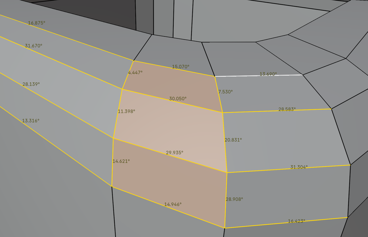

    Let me just add to what I already said:
    when Beveling like that, you automatically get 'weird', inconsistent looking angles:
    There's nothing you can do about it; that's (mostly) just 3D math. (You could get them more consistent, but that would lead to non-flat Faces.)
    But if you look at this too closely, and/or with an all-revealing Matcap, you might see things that you don't like and then you can't un-see them.
