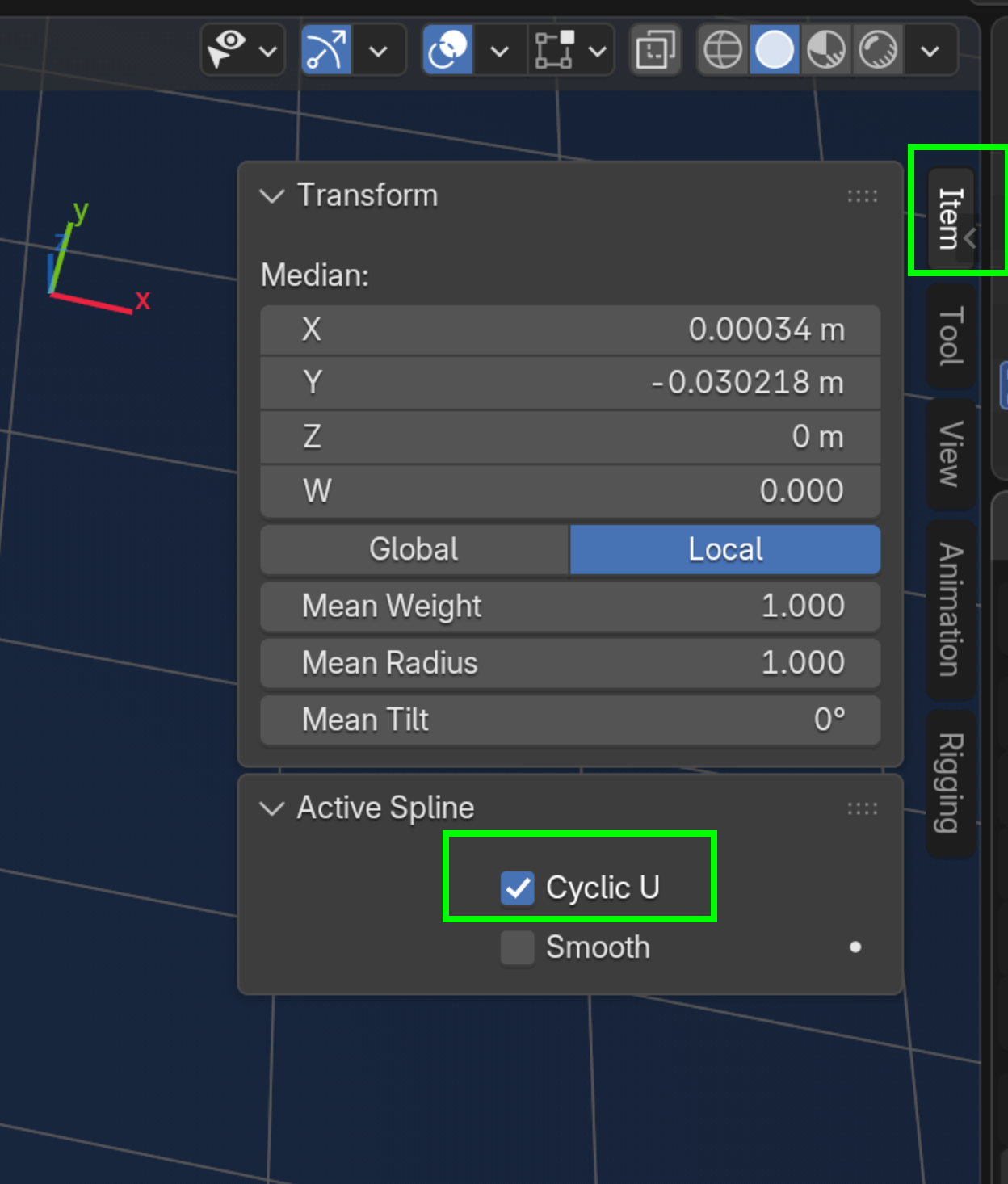

    Now, I haven't taken this Course yet, so I can't tell how you managed this (you probably took a part of the Mesh and Converted that to a Curve), but the fix is simple:
    Select the Curve and go into Edit Mode. Then in the N-Panel, check Cyclic U:
    I'll eat my hat if that doesn't solve it. Well, I won't actually eat my hat, that won't do you any good, nor me. Instead I'll see what else could be going on, so please let us know if this did the trick or not.
