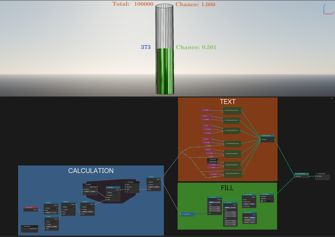

It isn't even because of how the random numbers are generated in a programming language, but with random numbers in general, they're not all gonna be different. There is this famous example, that in a class of 23 children, the chance that 2 have the same birthday is more than 0.5 (or 50% for barbarians).
Maybe it doesn't matter if two identity's are the same, when they are far enough apart in time (I can't remember exactly how the Identity is used here), but your way is certainly fool-proof.
Funny example, I will remember that one, thank you very much for the feedback
Woow Martin, That is cool! Thank you for sharing this interesting approach
