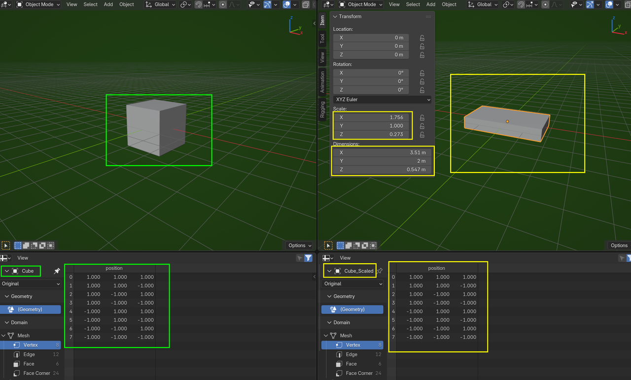

    First guess is you probably need to apply scale. In object mode, press Ctrl+a->Scale.
    Second guess is duplicate vertices AKA double verts. In edit mode, press A to select all and then press M->By Distance.

    yep looks like it was the scaling thing! such a weird problem. thanks for the help!

    Non-uniform scale causes so many issues :D So much, in fact, that if something is acting weird, it's almost always the first thing to check :D

    It's not weird, if you know, that Scaling in Object Mode, Scales the Object's Coordinate System, not the Position of the Vertices of that Object:
