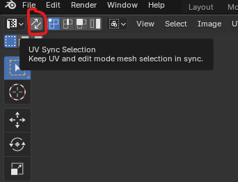

Question: I'm using 4.1 and am seeing something I've never seen before with UV islands in the UV editor. The asset has seams marked properly but when I Unwrap, UV islands are sharing verts with other obviously seamed-off islands. So when I try and reorient and rotate the island, those verts on the other islands move too which is undesirable. How to fix this problem or what am I doing wrong?

    I believe it might have something to do with UV Sync and you being in vertex select mode in the UV Editor. Try turning Sync off or change to face select mode.

    Agreed with what Omar has mentioned, that usually is a feature of the UV Sync option being enabled! Please let us know if that works, or if we need to do some more troubleshooting. :)
