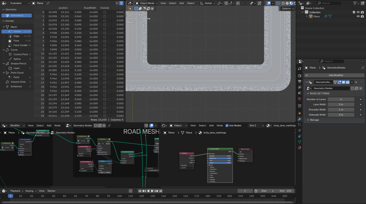

Hi! So I'm currently on Chapter 3 of BCITY (specifically Lane Colors). But I've discovered an issue that I can't seem to resolve for the life of me. My outside lanes are not evenly distributed (see image). I'm happy to send the file if anyone can help!

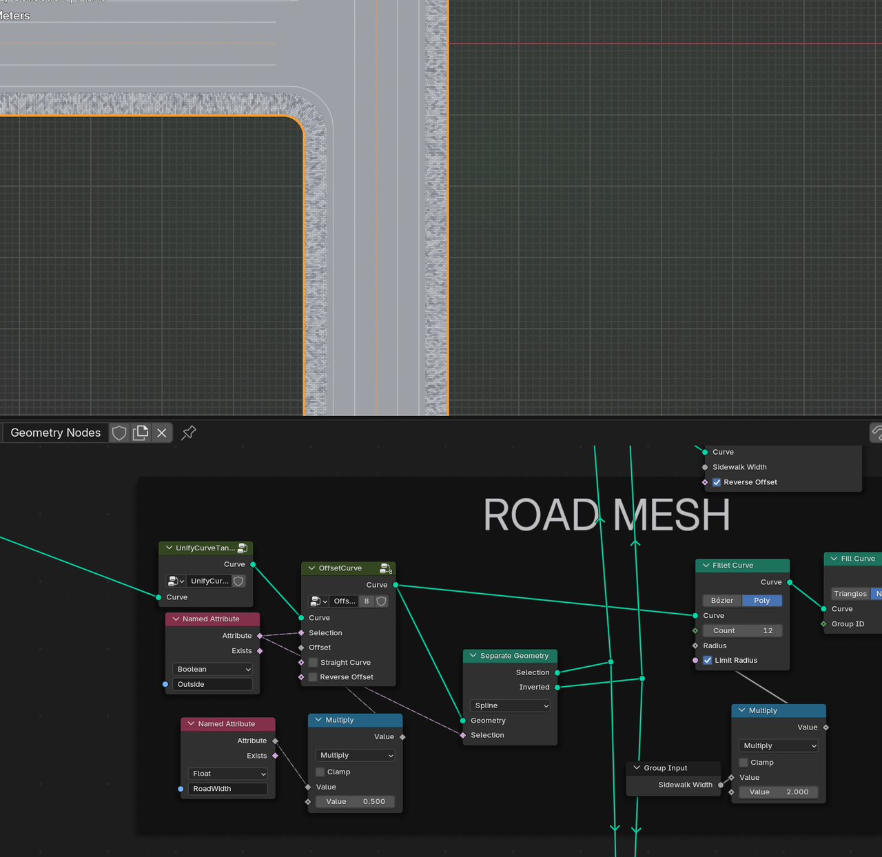

    sssingh27 Took a look at the file, on the OffsetCurve node inside the Road Mesh frame (the one after UnifyCurveTangent) you've got Straight Curve ticked. Untick this and it'll solve the issue!
    2 loves
  • Martin Bergwerf replied
    Sorry, I accidentally removed an Image from Mike's post, but this is what it looks like, with Straight Curve unchecked:
