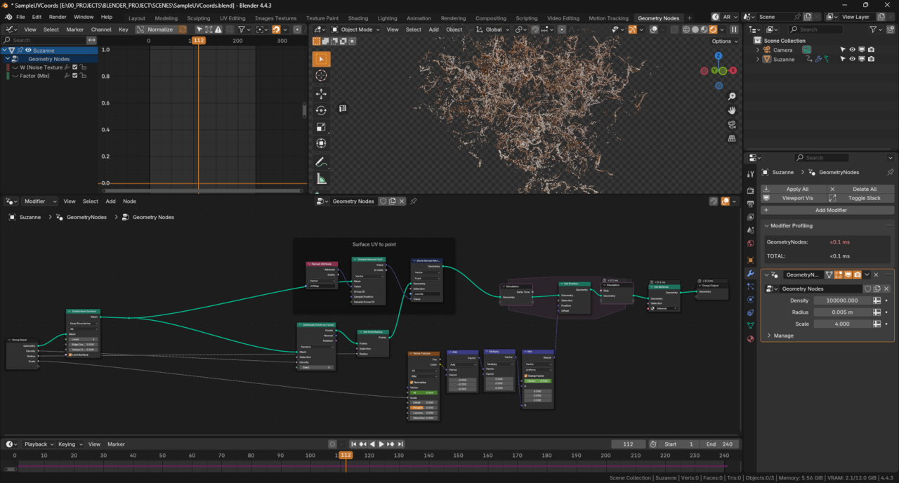

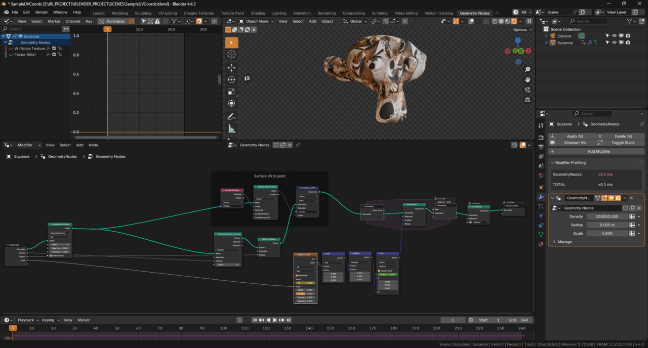

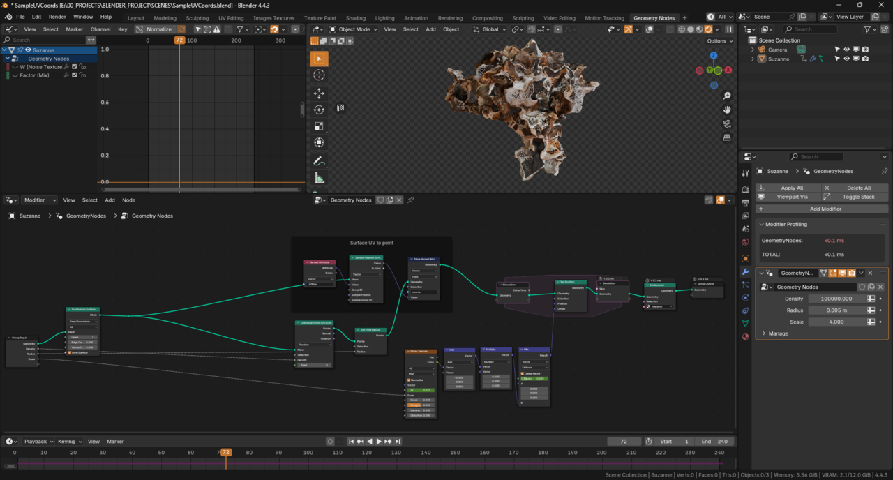

    I’m using Embergen for smoke simulation and planning to export particles as well. These particles originate from the ground and are triggered by a wheel interaction, simulating the smoke emission. Since these points already carry the UVs of the ground and move according to the smoke sim, I’m wondering : is there a way to use this to color the smoke based on the image / UVs ? Or is that kind of data just lost in the volume step ?
    Attached are a few screenshots from my current scene, showing the UVs remapped to the points.
