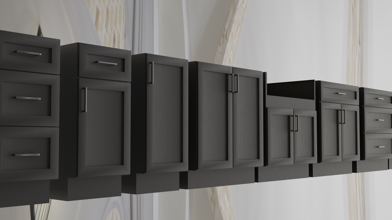

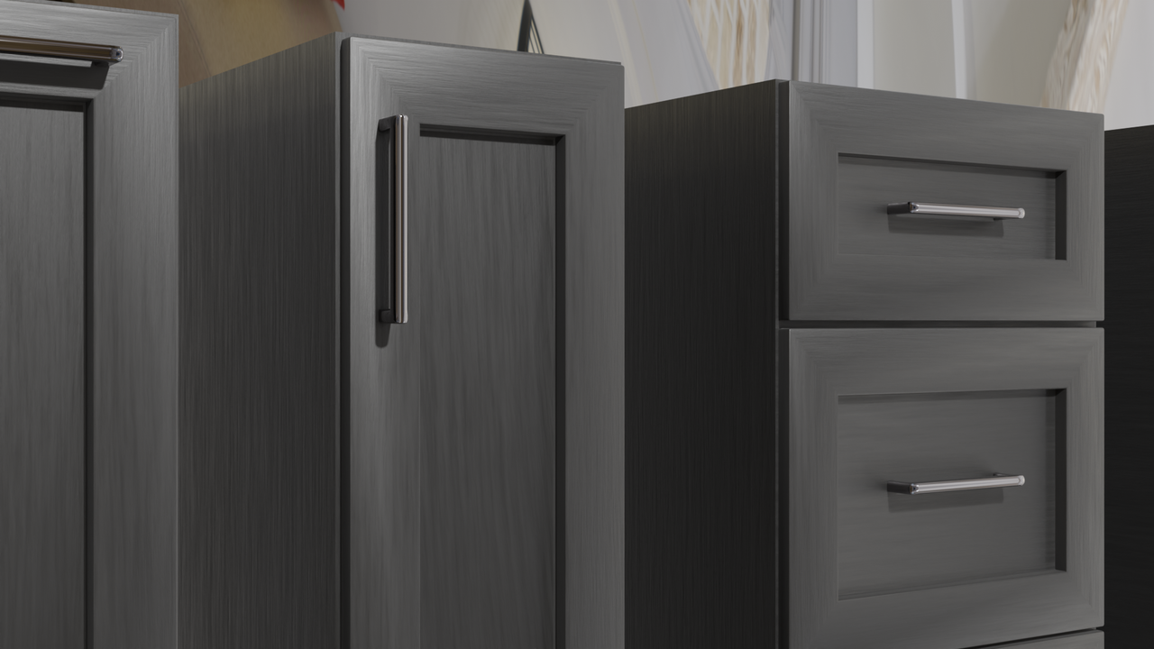

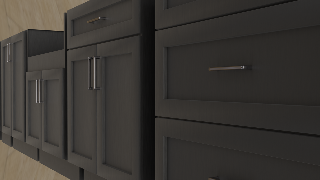

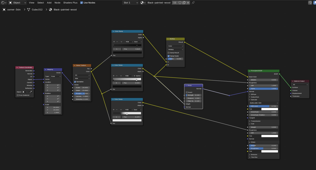

Hey guys and gals, I am working on a project, and I am trying to recreate a 'painted'(?) wood texture for some fancy cabinets. I feel like I am close or maybe there (doubt it). May I have some suggestions? I really need to do some more shader courses. Shading is certainly my weak spot in Blender.
Test Renders 1,2
My shader node setup

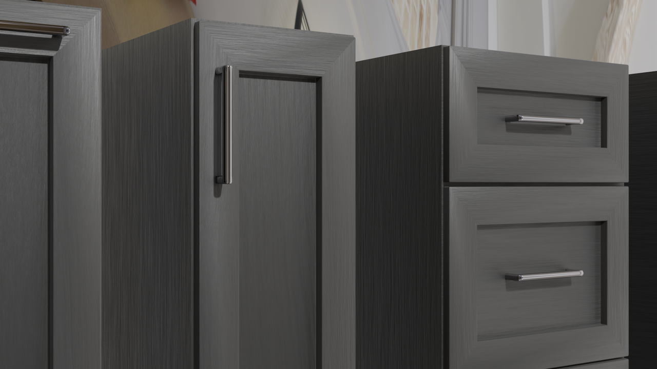

  • jason b(jasonbadum) replied
    The UV mapping does help drastically.
    This is with bump at 0.1
    This is with bump at 0.2
    The higher bump seems to offset the shininess of the material to give it more depth.
