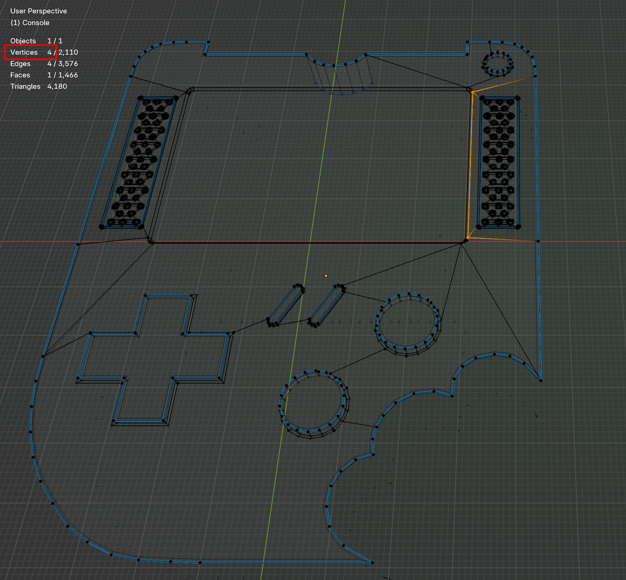

At Minute 17:01 I click F to fill and I lose the inner circle of the speaker holes.
This is driving me to drink... i have retraced my steps 20 times. And everytime --I come to minute 17:01 I click F to fill and I lose the inner circle of the speaker holes. What in tarnation am I doing wrong!?

    Hey gents.. TY for the replies. I should have included this screen capture that shows my selection prior to fill. I AM selecting the entire edge as you show in my revised graphic. (it's not letting me insert a picture. So please see here: https://aworkofmarc.com/1/f-to-fill2.jpg  The exact outline you edged in green is selected.  If you feel especially generous, here's the file.
    https://aworkofmarc.com/1/Game-Controller--V2.blend
    1 love

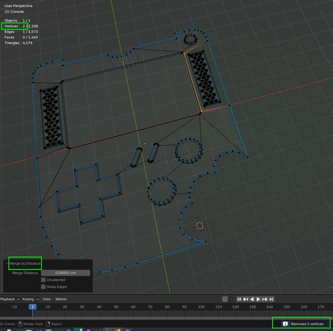

  • Martin Bergwerf replied
    Hi aaworkofmarc ,
    You have so-called 'double Vertices" here:
    If you M > Merge > By Distance them, you can Fill correctly (in my Screenshot, I have already Merged them).

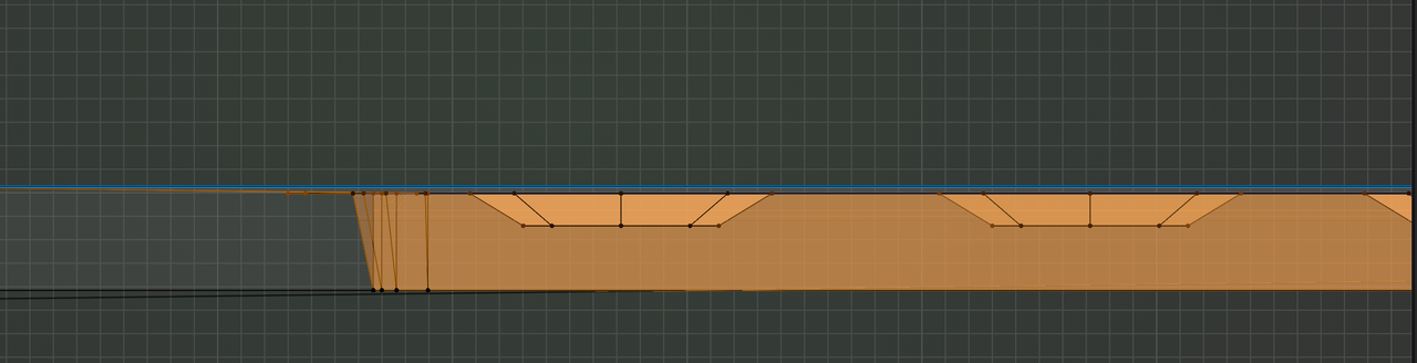

    But another thing, your speakers are lower than the top of the console:
    2 loves

    Arrrgh. And still I have the same problem.
    I've literally tried 20 times since the last message.  As seen here:  https://aworkofmarc.com/1/f-to-fill3.jpg
    1) the speakers are not below --in fact in this attempt I even left them slightly above the console to make sure!
    2) on none of the 4 vertices selected are there double vertices that need to be merged. They fill fine... but when I try to selct all the edges to do the 2nd face fill, I can't select all the edges in one go.. and when I fill I get the exact same outcome as before.
    Normally I'd have given up by now entirely but now sheer aggravation propels me forward. Any ideas?

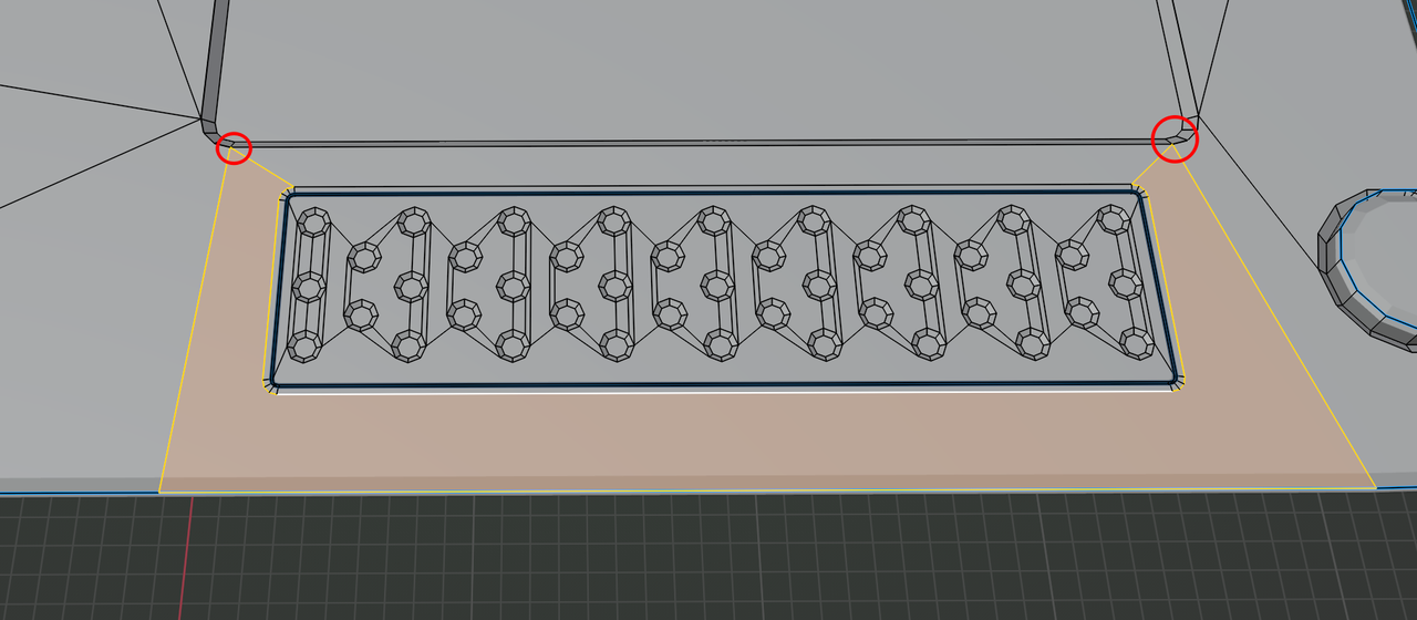

    Hi Marc aaworkofmarc ,
    In your new upload, you still have 'double Vertices':
    and after Merging:
    Then switch to Edge Select Mode and the correct Loop will be Selected, so the Fill works as it should.
    1 love
    "...-in fact in this attempt I even left them slightly above the console to make sure!..."
    That is just as wrong as having them below!
    (That has nothing to do with the Selection and Filling; just something I noticed and that might give some Shading problems later on, so it should be fixed.)

  • aworkofmarc replied
    Martin Broooooo! Thank you SO MUCH for hanging in there with me. Finally! Got it! As it turns out the fist 6 + times trying since the last time... I kept forgetting to check for multiple vertices with the XRAY ON, thus never finding the multiples. You have the patience of a saint :) TY! I learned a lot tho, I did the preceeding steps so many times I can do them in my sleep now. hahah.
