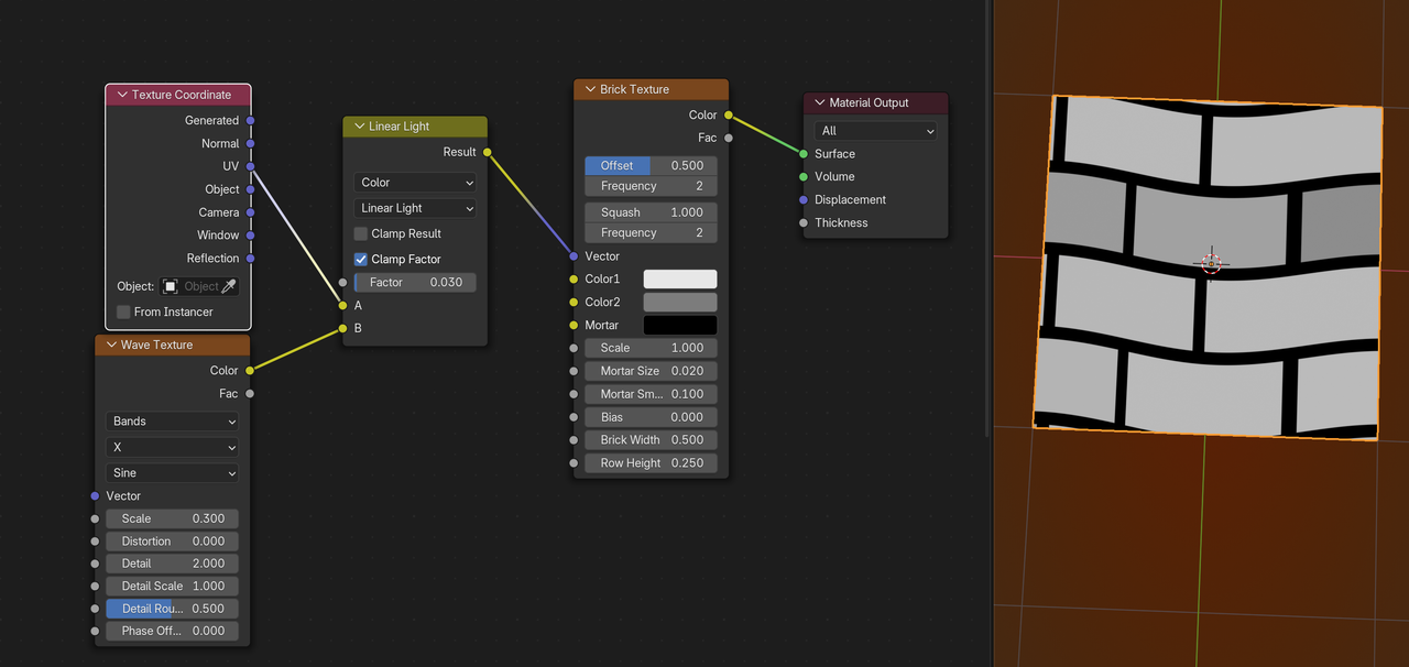

    Hi Rory,
    Yes you can!
    It is common to use a Mix Color Node, set to Linear Light for that (but there are other ways to distort the Tecture Coordinates):

  • Martin Bergwerf replied
    Oh, I don't remember where. It's a pretty commonm technique; I think the first time I saw this technique of 'warping' the Texture Coordinates, was in procedural wood Lesson (by Bartek Skorupa) of Shader Forge: https://cgcookie.com/lessons/wood
