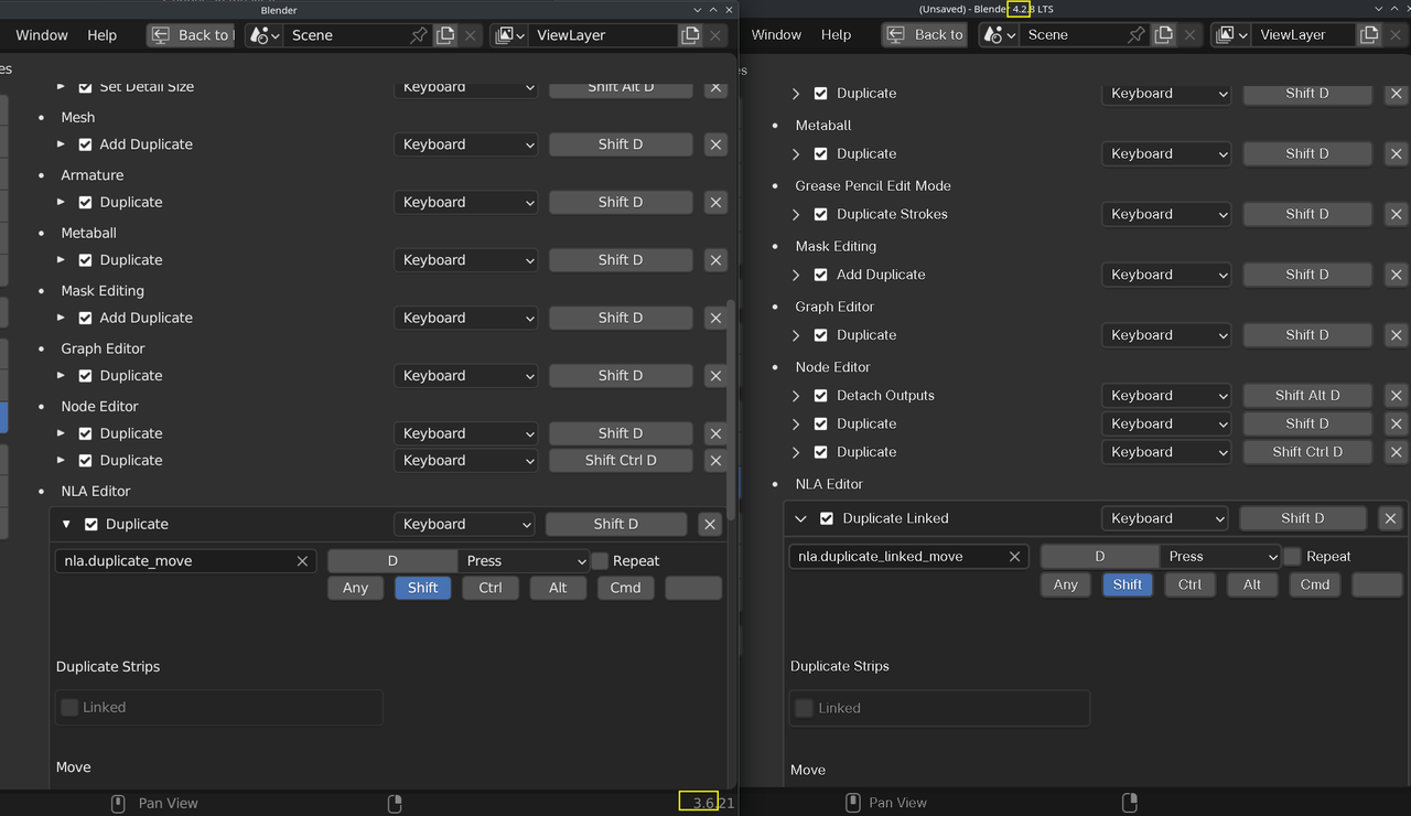

  • Dwayne Savage(dillenbata3) replied
    I think that was a mistake. looking into it. It appears that the change happened in 4.0 when they made a lot of hotkey changes. People don't use the NLA that much or don't use those hotkeys. You can click key bind button and search for D. Then scroll down to NLA Editor expand both then switch the Modifier key use.
