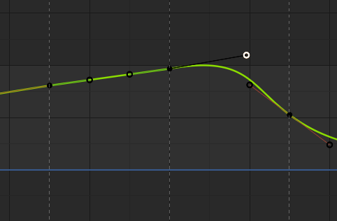

    Hi Brandon, not sure if I get your question right. Don't worry about the rabbit hole, this topic is hard and takes time (i'm still not though the complete bundle and I'm still struggling after a long time.) But for overshooting an action (making an action delay it's end a little, you can either move the keyframe a little or even better, use the bezier curve to slow the end (making your curve continue a bit in the direction it was going past the keyframe before going back the other way. My feeling is that this helps you give you more granular control.025-04-11 072939.png

    Sebastien is correct.
    If you want to offset the animation, you can offset the keyframes in time - or you can rotate your handles to delay the extreme poses.
    (There is a use for both situations)
    Hopefully this sheds more light on it.
    You can see that the keyframes align (yellow rectangles)
    But this sine wave is offset in time simply by rotating the handle accordingly.
    I have hidden the handles because it makes it made my annotations less clear.
    Here is the version with the handles.
    Hope that helps.
