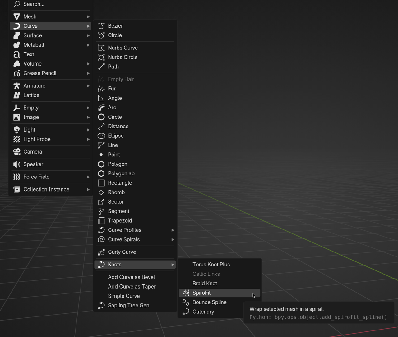

    And I just remembered, there is an even better start Curve than the Spiral, for not cylindrical shapes, using that same Addon:
    3 loves
