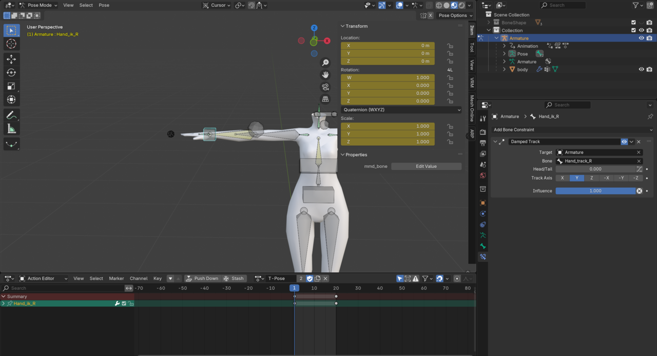

Previously, I found that when moving the IK, the wrist angle looked weird. So, I added an extra bone (a circular bone) at the end of the lower arm for the IK to track. This way, the wrist stays naturally straight.
However, this caused a problem. Disabling Damped Track fixed it.

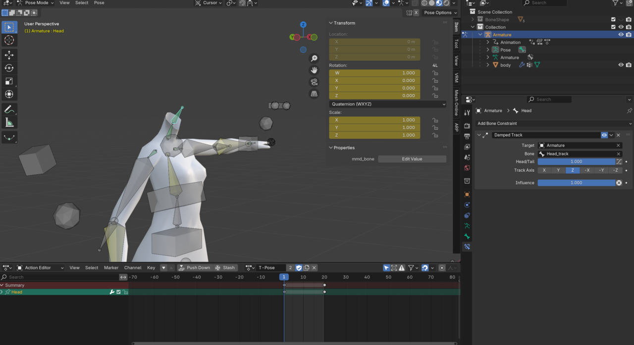

But I also used Damped Track for head movements to make turning the head easier, and this seems to cause animation issues as well.
Is there an alternative method to achieve the same effect?
