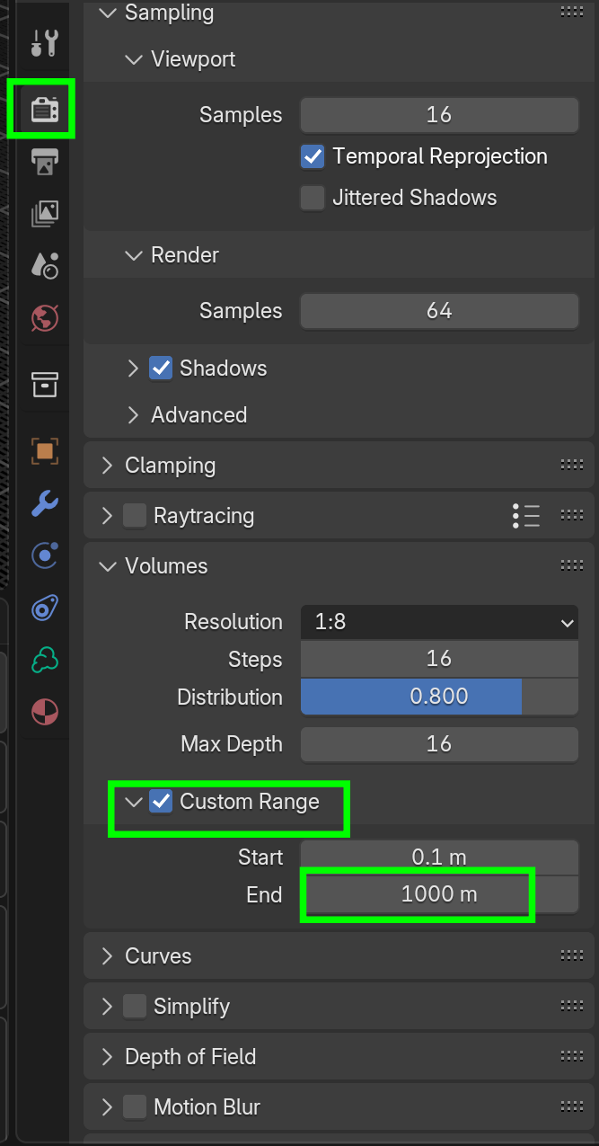

    Hi kchow ,
    First, Render Preview always uses EEVEE.
    You can go to Rendered Shading and see it with Cycles, or change the Render Engine to EEVEE and go to the Render Properties > Volumes Tab and change the Custom Range, or disable that altogether:

  • Martin Bergwerf replied
    Solution
    Also, make sure that you don't get a warning like this:
    2 loves

  • Keswick Chow(kchow) replied
    Thank you very much Martin and Omar,
    This is it!  I got the visual.  I have not used vdb before and did not realize there is a "Data" properties and that the vdb file have to be linked correctly there.  And the "File - ExternalData- Report Missing Files" did not show any problem!
