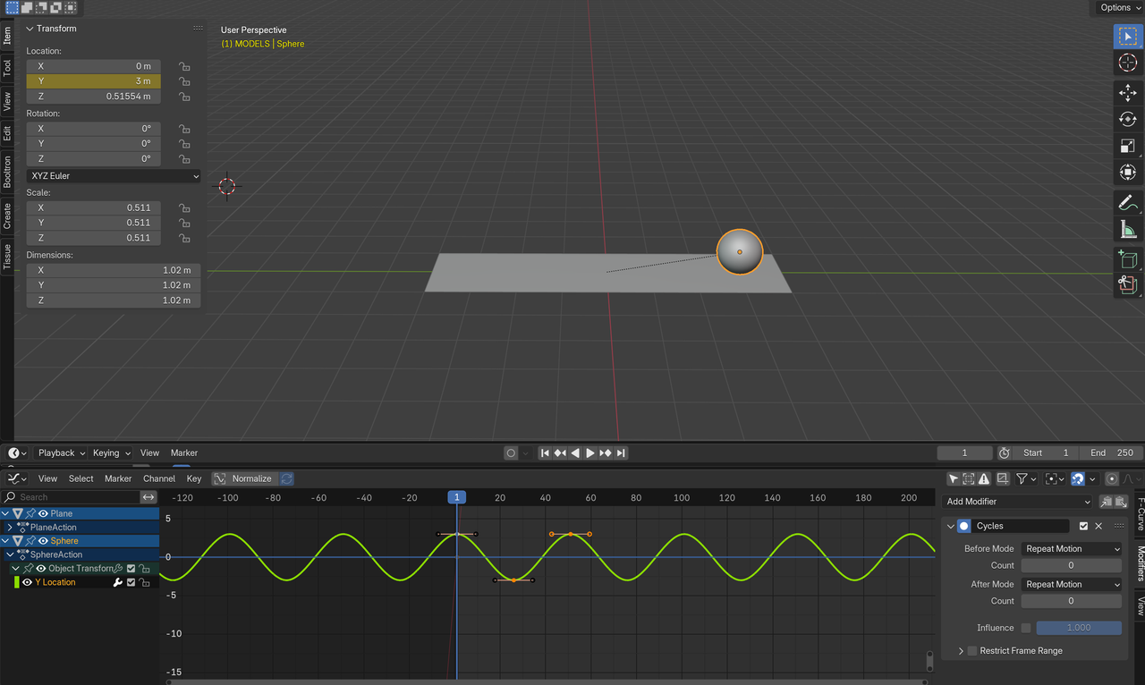

    Hi BBlendash,
    What I would do, is Parent the Ball to the 'Rectangle'. Give it a Left/Right Animation and give the Rectangle a Rotational Animation.
    You should be able to figure out the rest yourself.
    (Maybe look at the NLA Editor?)

  • Martin Bergwerf replied
    Don't use an Array Modifier. Simply Offset the Animations for the Copies.
    1 love
    You could also use Drivers to Offset the Animations, dependent on the X-Location of the Objects.
    1 love
    With the Array Modifier, you have just one Object. That's why you can't Offset the Animation easily.
    What you want will probably be 'easiest' with Geometry Nodes, but it's not something straightforward anymore that way.
    You'll probably want to somehow use the Location of the Copies to control the Offset, but I'm not sure how that'll work exactly.
    2 loves
    HI BBlendash ,
    I've been thinking about this and came up with something that might work for you (still a little bit of work left for you to do 😉):
    Here is the .blend file, so you can look at what's going on and play with it:
    https://drive.google.com/file/d/1XKs1Gybs81GVnx82SYdDqSFs8FZwkjkT/view?usp=sharing
    Hope that helps you on the way.
