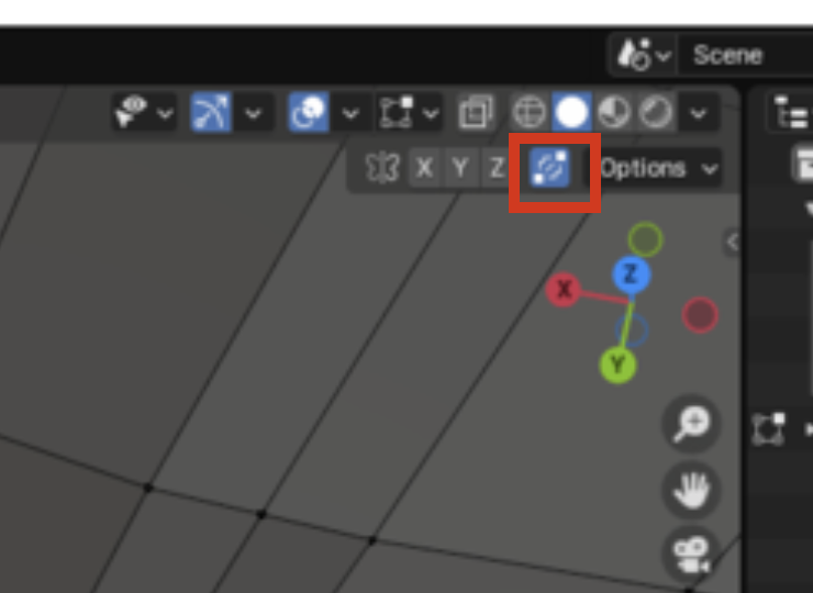

can l mask some verts so they are not effected by auto merge ????

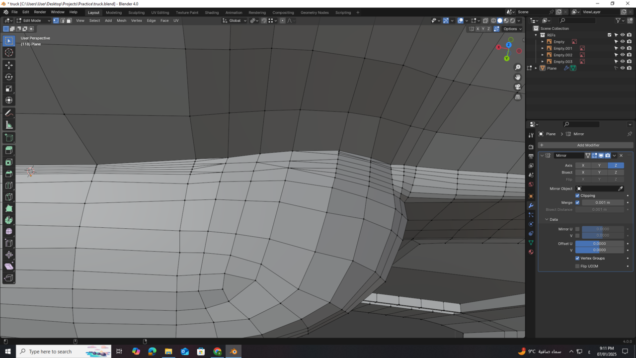

    Can you give us more details? Maybe some screenshots to see what may be going on. Most likely the merge threshold is not high enough, meaning the vertices are not occupying the same spaces and are ever so slightly away from one another.

  • Ahmed Wael(Ahmed Wael) replied
    lĀ  wish l was able to mask these verts to not be auto merged

  • Omar Domenech replied
    Those vertices are too tight to have auto merge on. You should turn it off and try to clean that area dissolving some edge loops.
    Also you can select those edges that have been merged already and with Control + XĀ  delete them, then selecting two opposite vertices, join them with J to reset that whole area.

  • Martin Bergwerf replied
    Hi Ahmed,
    Auto Merge can be dangerous (I personally rarely use it), as you have experienced by now. You cannot Mask Vertices, but what you can do, is Add a Weld Modifier and use a Vertex Group that is affected by the Weld, or invert that and have a Vertex Group not be affected by the Modifier.
