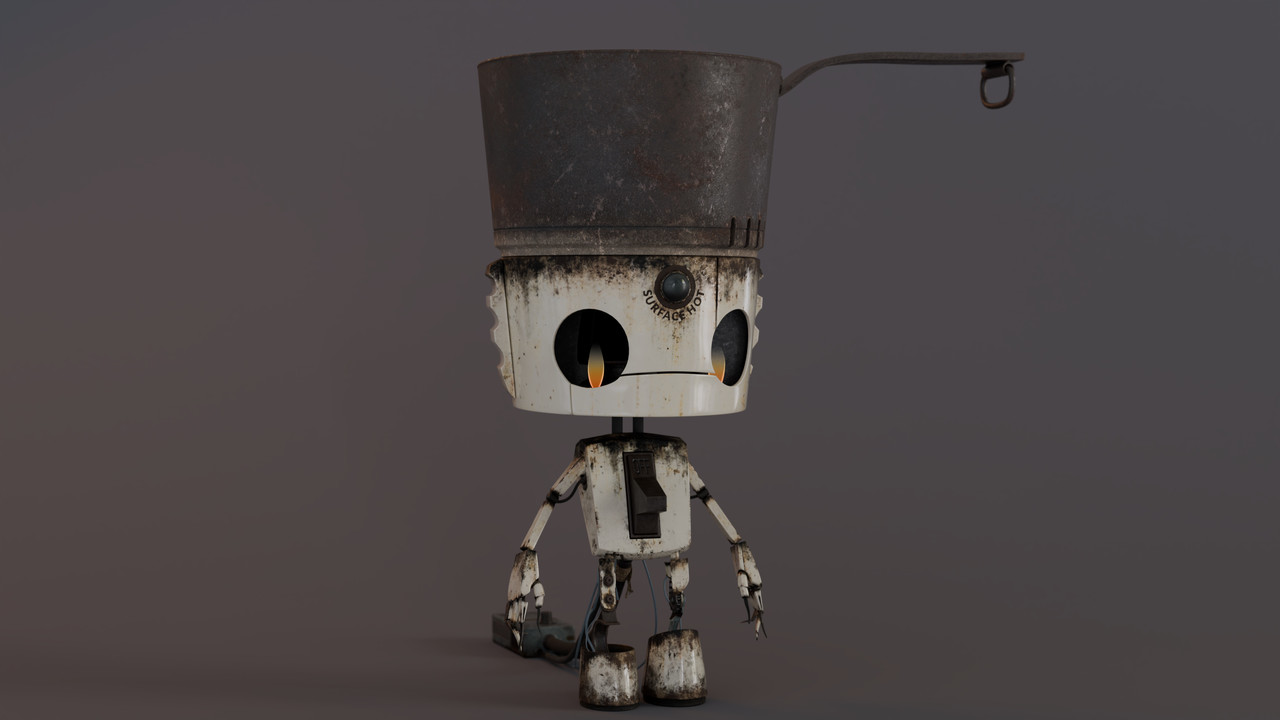

    It has been "a minute" and a rollercoaster of ups and downs (a lot of downs). This is a quick render on a plain, one-colour background with a bit of depth of field and some lights. To be honest, I am anxious about posting him to the gallery and submitting my work for grading. While baking texture maps on the smaller parts, I realised I ran really short on pixels. Therefore, I might render him partially with raw material setups for some parts and leave others with baked textures. I thought that posting him here first might help me feel less anxious. It is okay to give your thoughts if you have any. Thank you!ead_first_render.jpg

    That looks awesome, Guna!
    The only critique I have is that the flames look rather stylized and that conflicts a bit with the rest of the model.

    It is looking super great. You should totally submit for grading and post it on the gallery.

    Martin, now that you've pointed out the flames, I think that's exactly why the model felt a bit off. They really conflict with the rest of the piece—it almost feels like 'the lights are on, but nobody's home.' It will probably take me a couple of evenings (in a best-case scenario) to give the flames some liveliness and integrate them into the rest of the model.

    One last quick render before spending hours and hours perfecting the final renders. The difference is striking! The flames now = no more 'dead weight walking.'

    Yesss!
    So much better! Looking awesome now!

  • Omar Domenech replied
    Looking super good. Love the grunginess in the texture.

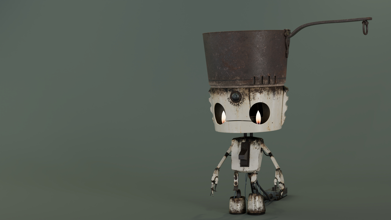

    The first render that I am actually happy with. At first, I tried to wing it. However, feeling completely defeated, I watched the Fundamentals of Lighting course. This is what I was able to come up with in the end.nal_final_render.jpg
