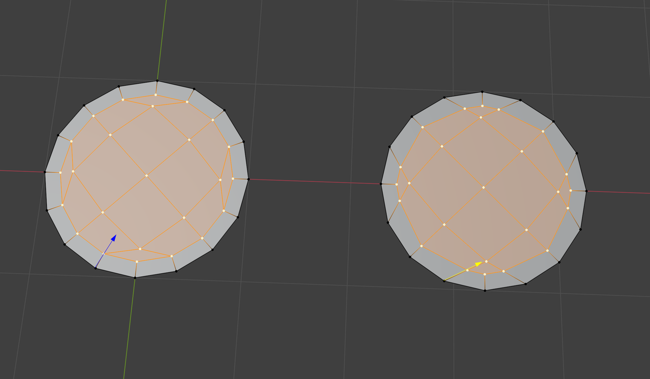

    I don't think your issue has anything to do with Edge Rail (which I, I must confess, have never used). What Edge Rail does, is best shown in an example; the left Inset is 'normal' (slides the new Vertices along the Normals) and the right Inset has Edge Rail enabled (new Verts slide along existing Edges):

    In regards to edge rail: That option is only really useful, when insetting an uneven surface. Without it you would push the faces out a bit, blender trying to average out things. Enabling edge rail in that case would keep faces flat.
    As Martin said that should not have anything to do with your issue here.
