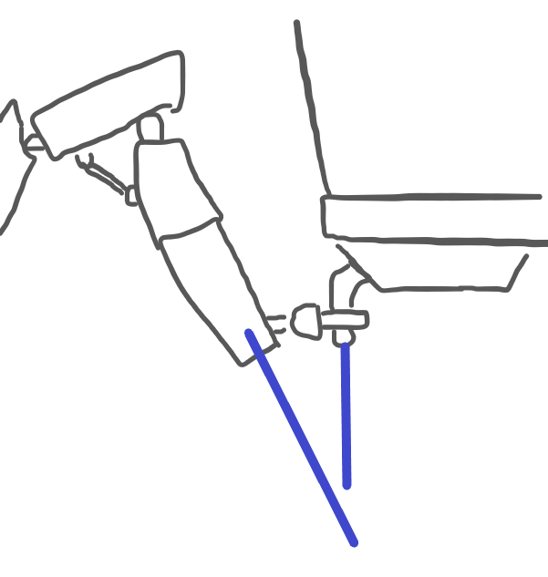

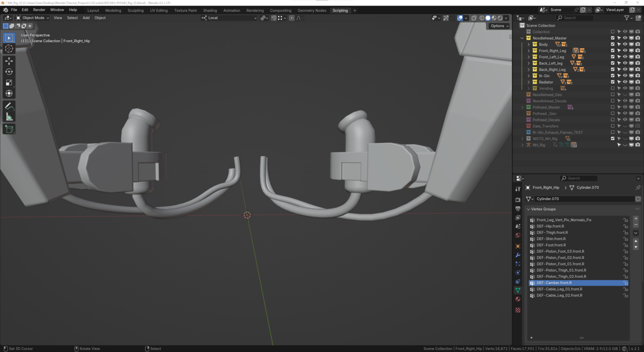

I mentioned that the cables underneath Noodlehead were posing to be rather tricky for me during my first attempt at them. The main reason is getting them to bend and stretch with the legs correctly - the mesh was distorting in all kinds of unappealing ways. I'm adding a screenshot of the cables that will need to interact with eachother to some degree.
You can see that the ones ontop are, well, sitting ontop of, or 'looping' over the others. It would be easy enough to bone them up, but getting the mesh to not clip might prove tricky (tbh, I won't know until animating them). I was thinking I could create tweak bones to adjust them as they move? My only concern (again, on having not animated yet) is that it could unintentionally look like a spaghetti monster having a dance party. (Again pt.2, I assume it's up to the animator to do a good job and not have dance parties underneath robots)
I was on a discord call with Phil Osterbauer and a member called John the other day, and they suggested I try a spline IK setup?
I have a suspicion I'm falling back down the path of overcomplicating things by trying to get these cables to automatically follow the legs without having to do any animating on them>
Additionally, and you've mentioned this to me before, but it is a riggers nightmare to have to rig a posed model. Would these cables be considered "posed". Ie, could a workaround be that I straighten the mesh (see the rough sketch below where the blue lines are the straight cables) and add my bones, and then move them into place with pose mode and then apply the pose as the rested pose?
(edit: I did a very quick test, and while it applied the bones to the rest pose, the mesh jumped back to it's initial state so I'm not sure if this would work?).
I'll start trying things out and report back with how I go. My initial attempts with the "super bendy" and "bendy chain with twist" setups sort of worked. But when the last bone (attached to a leg - so in that case it would have been a MCH rather than a control bone) moved, it only moved the end section of the cable as opposed to moving the majority of it.
