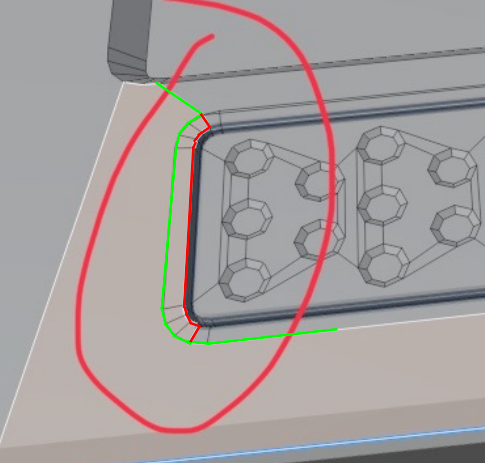

    Hello, thank you all for helping! I have been trying to mess around with it for the last hour but no progress.. I tried to check if any vertices were overlapping or duplicates but that didn’t seem to work either.. I’m confused and wanted to show you guys something else I noticed that I feel like is causing this problem.
    In the picture, every time I try to select the faces that aren’t beveled on the speakers it selects all the other faces on the game boy.. these faces are combined together and they are not supposed to be I’m pretty sure. I circled it in red. Maybe I have to fix that?
