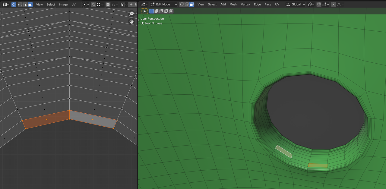

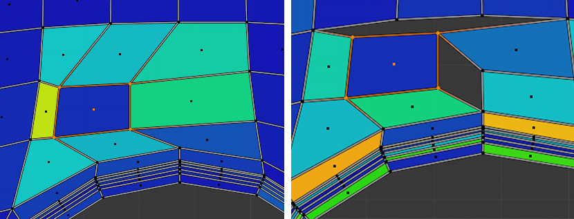

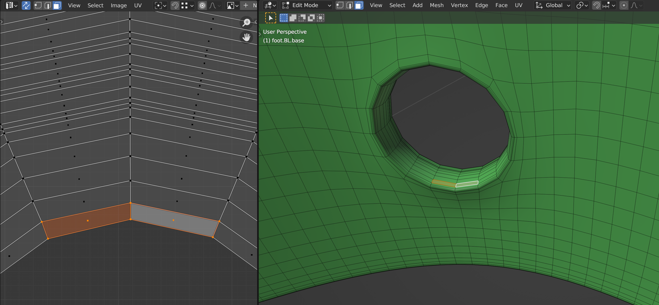

    Here are Faces 363 and 364 in one of the 'wrong' ones:
    and the 'same' Faces (363 and 364) in the 'original':
    That is not the same Topology.

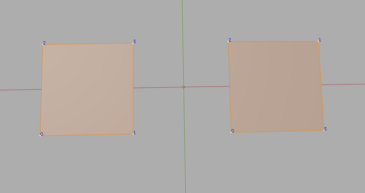

    To stress the point:
    These two Planes have different Topology!
    In the left Plane, the Vertex 0 is connected to Vertex 1, in the right Plane Vertices 0 and 1 are not connected.
    1 love

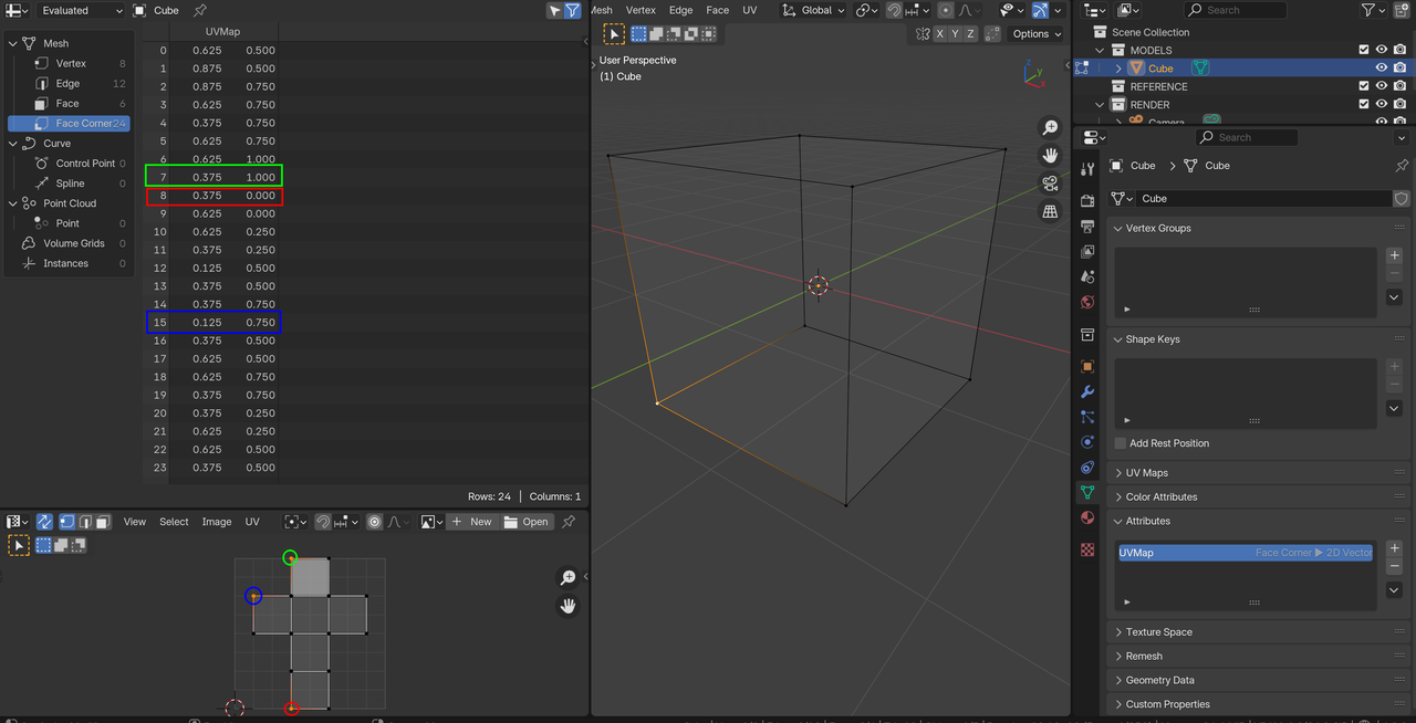

    Topology is not about where Vertices are in a Mesh, but how they are connected. The same way, as Vertices and Edges and Faces are numbered (have Indices), Face Corners are also numbered. When Unwrapping a Model, Blender assigns 2D Coordinates (U and V) to each Face Corner. A Cube has 6 Faces and each of those Faces have 4 Corners, so that is a total of 24 Face Corners. The default Unwrap for a Primitive Cube in Blender is this:
    See how that one Selected Vertex corresponds to 3 Face Corners, which get 3 (in this case different) UV-Coordinates.
    In your case, some Face Corners, that were 'in the same place' in both Meshes, got different Indices, because of how they were made/duplicated.
    The safe way, is to Duplicate Objects in Object Mode, then all the Indices are in the same place for the original and duplicates.
    This is way more, than you need to know in your normal 3D life, but it might be good to have seen it once.
