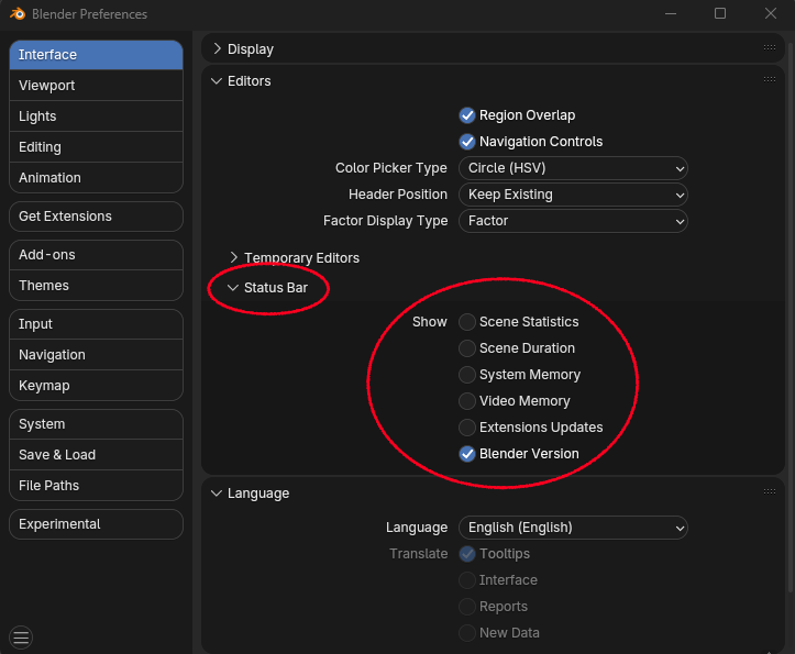

  • Adrian Bellworthy replied
    What else is on the status bar?
    If you have lots of info, you can try disabling some in the preferences to give more room.

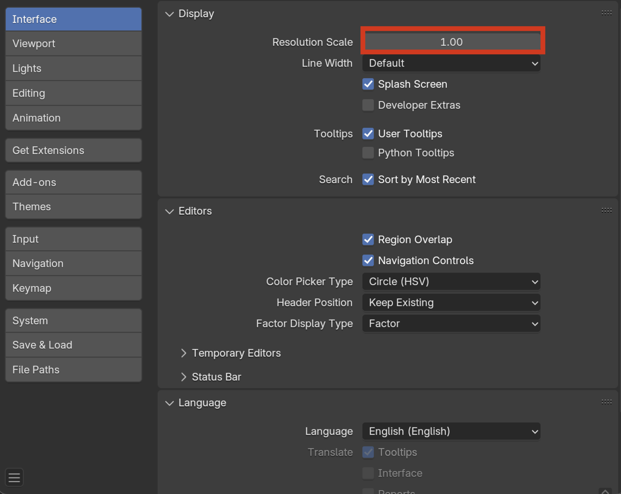

  • Omar Domenech replied
    Setting down the resolution scale to 0.8 should work:
    Keep in mind it will make all the elements in your UI smaller.

  • zharnite replied
    I'm using 4.2.1 LTS on Windows. I have Proportional Editing turned on, so it's showing me more options.
    Setting the resolution down works, but it's a little hard to see haha. I was curious if there were better solutions, but maybe not.
