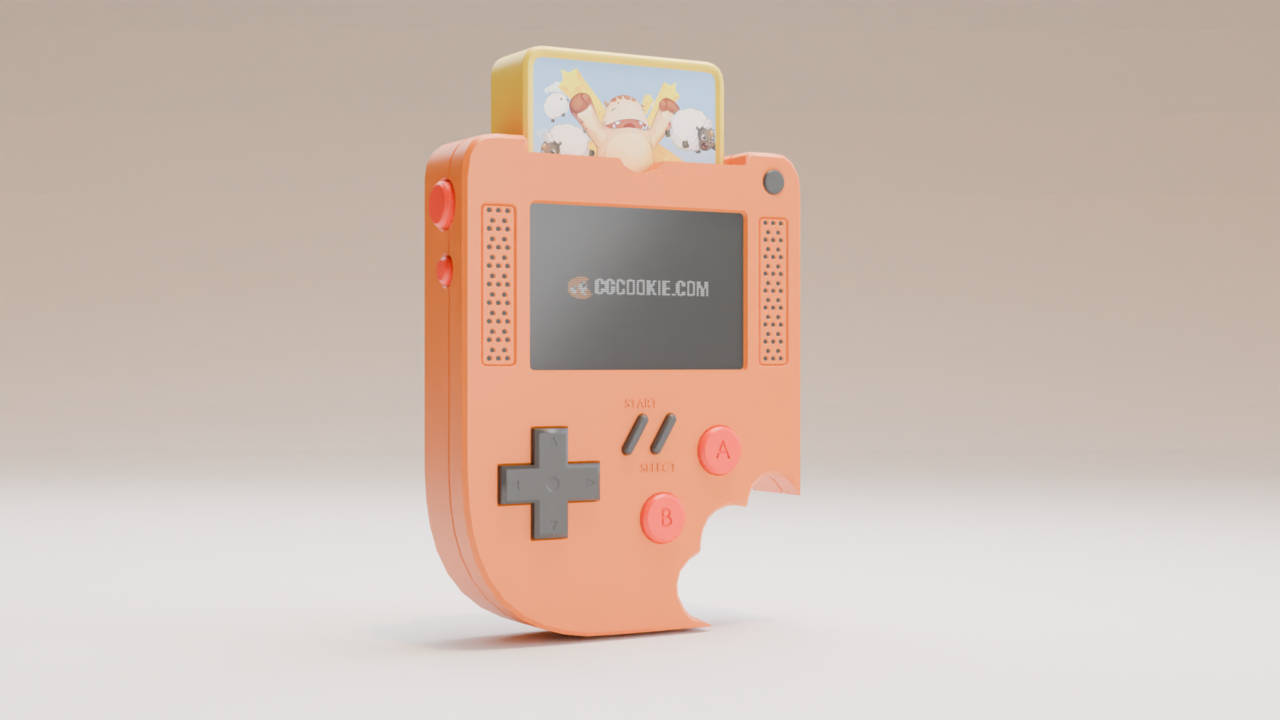

[Press Start] My render looks quite washed out.
Question Materials and Textures
My colour codes for the pad and everything are the exact same. So are the values for the lights and I matched the distances best I could. Any ideas why it looks like this?

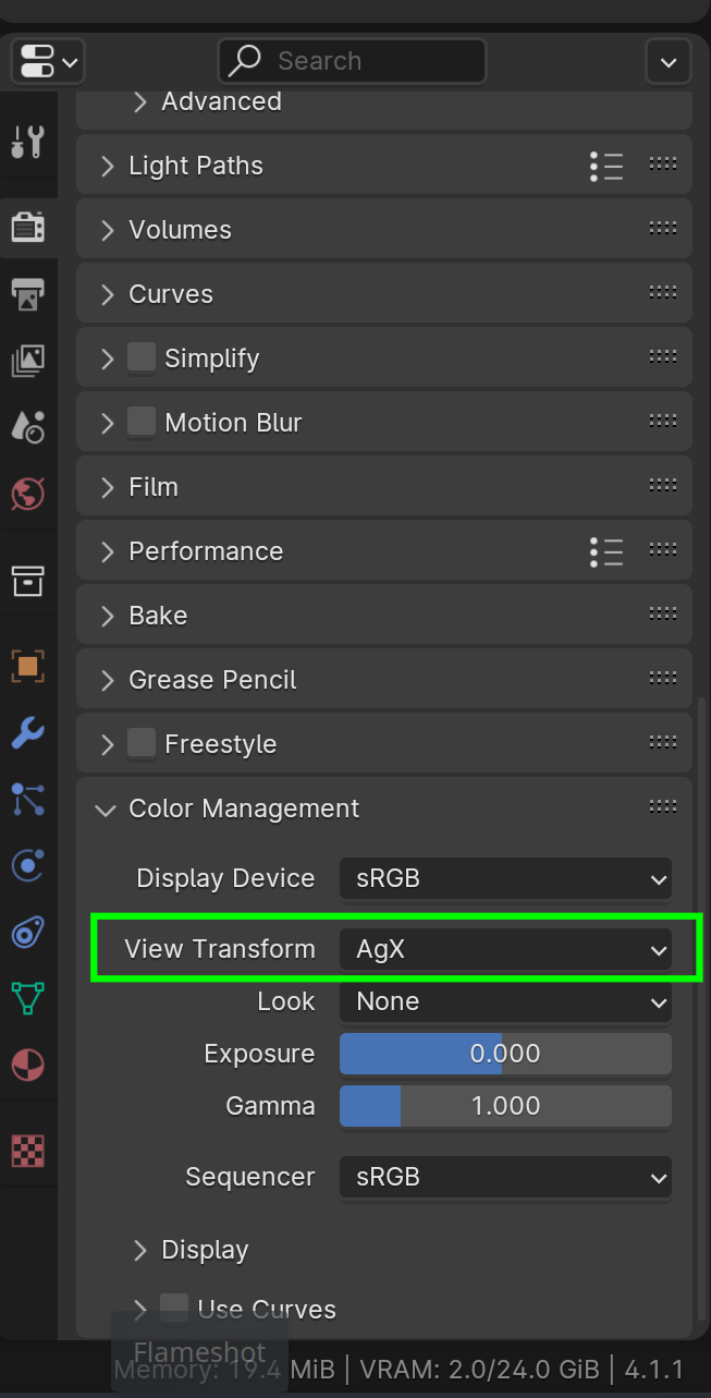

    Hi Thomas fflyinggoatman ,
    It's a really bad habit to copy the values you see in a tutorial! Use your eyes to get the colors you like.
    In this case, it might be, because you are using a different Blender Version than the Course.
    For instance 4.1 uses AgX by default (instead of Filmic):

  • Thomas G(flyinggoatman) replied
    Thank you! I only am copying values so I can see the resuits and understand how a + b = c, if that makes sense?
    Then I can come back and try to adapt the findings into my own colours and styles.
