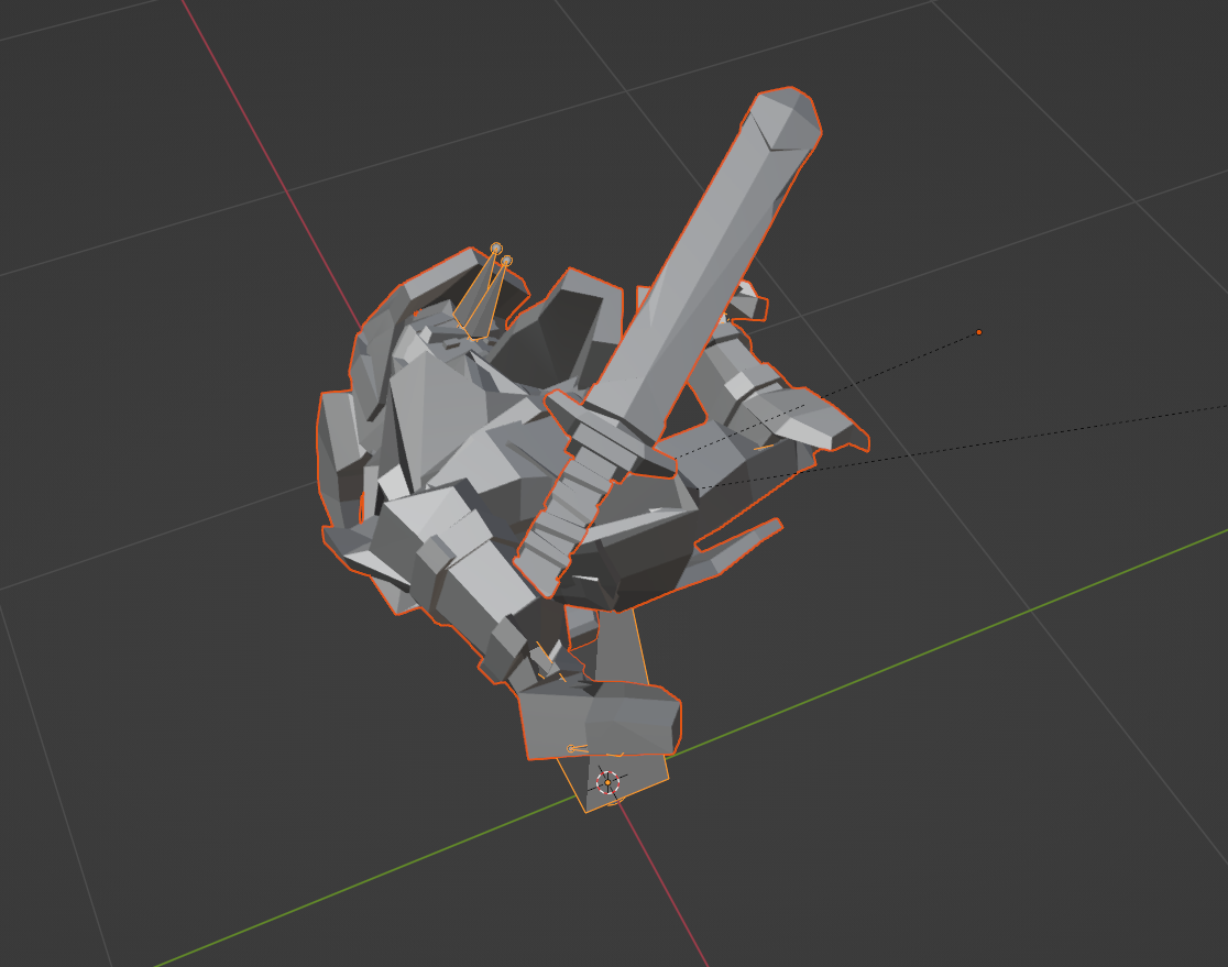

I have an FBX file with a Knight character and an Idle Animation defined on it. The Knight Character looks upright in the FBX File as shown below.
When I import the FBX file into Blender, It looks mangled as shown below:
What settings do I use in Blender for the character to appear upright as in the FBX File?

    I downloaded the model you supplied,
    The model imported OK for me with the default settings, however the bone orientations where a bit messed up.
    The best setting I found is, all default, except under Armature enable Automatic Bone Orientation.

    The Manual Orientation is disabled, and the Automatic Bone Orientation is checked, but still I get the following
    I was wondering if you had an opportunity to import from the provided FBX file and if so, could you please send a snapshot of the import settings that worked for you. Also the version of Blender.

    I have no experience with Import/Export, but I tested your .fbx in 2.93, 3.0, 3.1, 3.3 and couldn't get it to work as it should.
    But in 3.6 all was as you'd expect (default settings, with auto bone enabled):
  • deepakj replied
    Thank you so much Martin. I've tried various import settings but it didn't cross my mind to try a different version of Blender. I just tried it with Blender 3.6.0 and it works.
