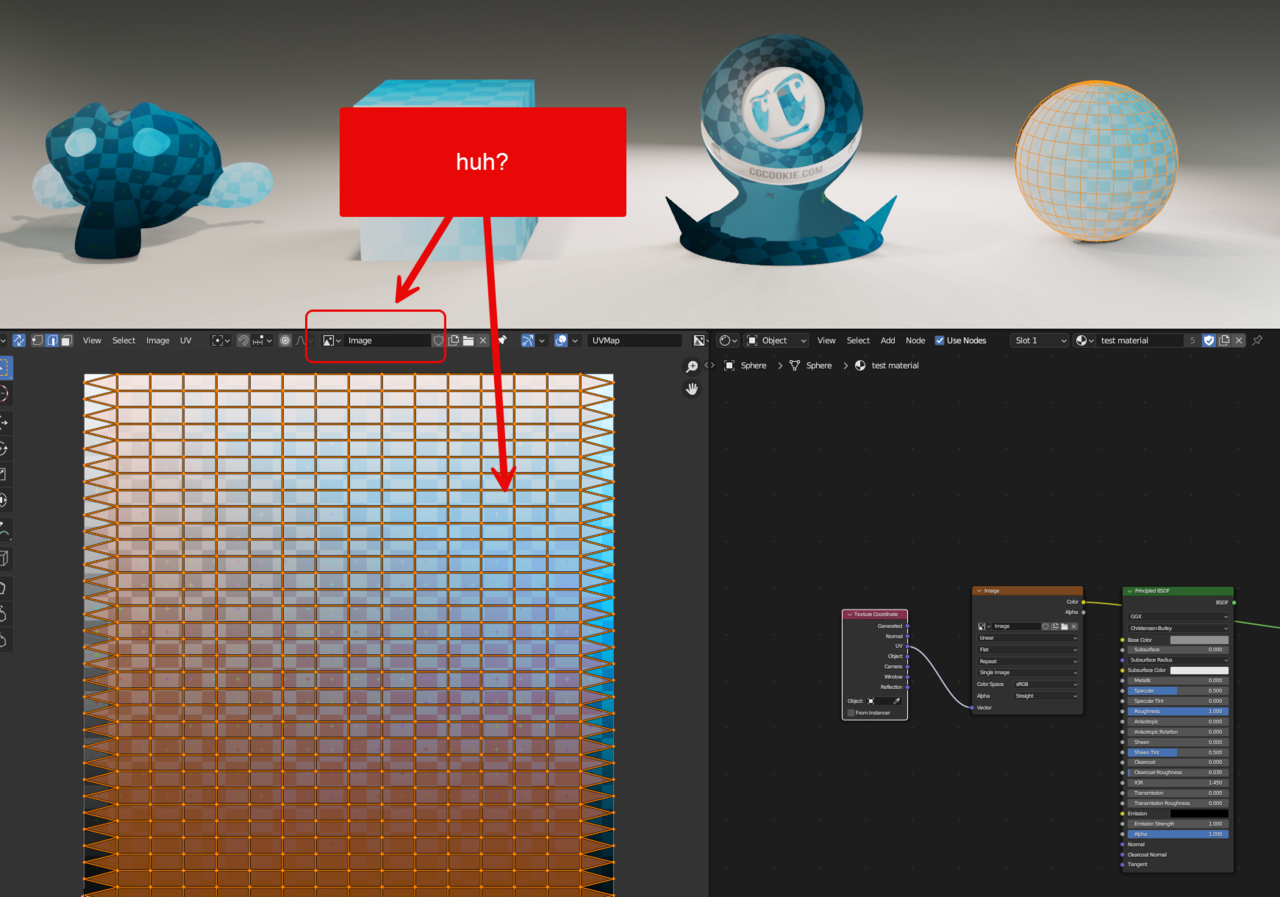

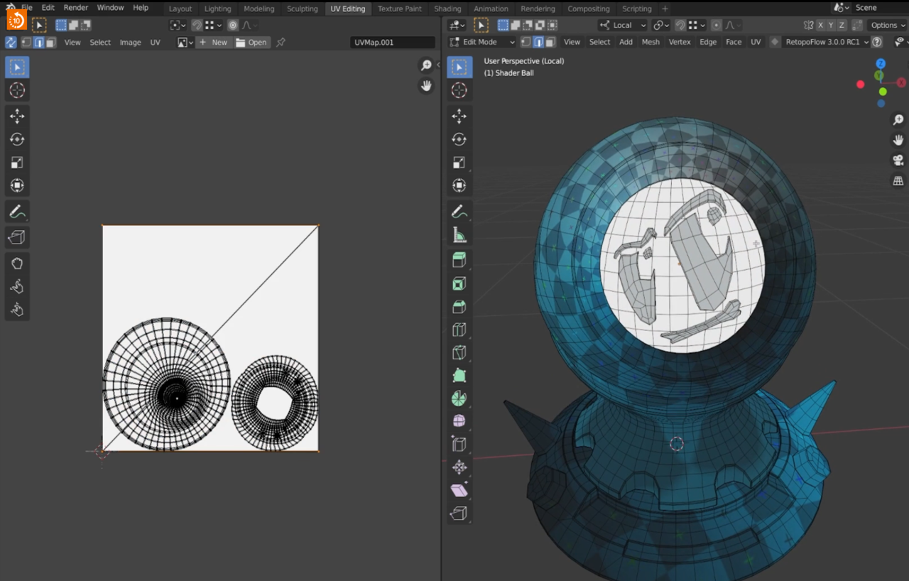

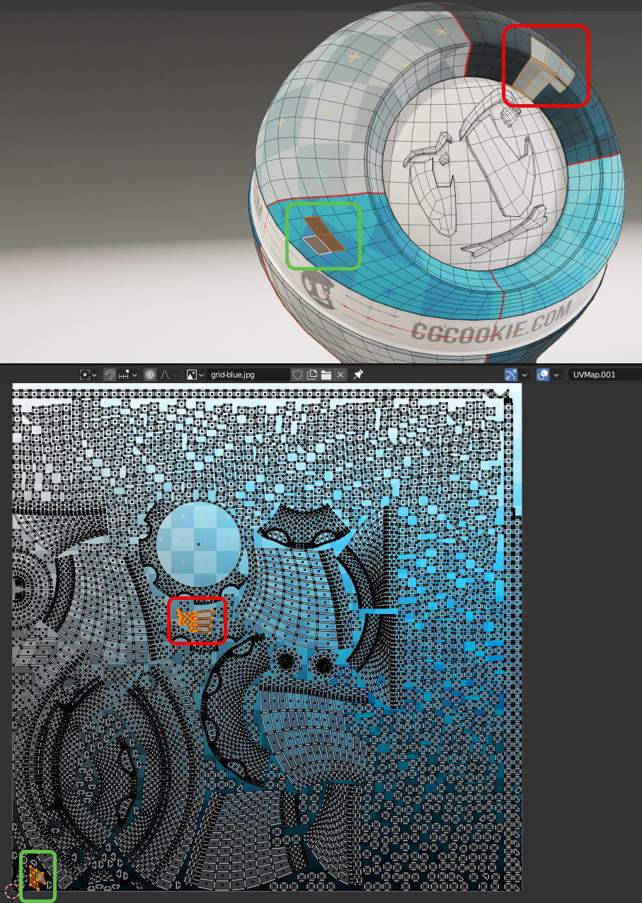

It's not loaded in as an image and if you click on any other object and clear the seems the blue grid stays in place. Even if I delete the blue grid from the UV editor it stays in place!

    Hi thehomme ,
    That's the UV Unwrap of the Sphere, it shows when in Edit Mode and Vertices, Edges, Faces are Selected in the 3D Viewport.

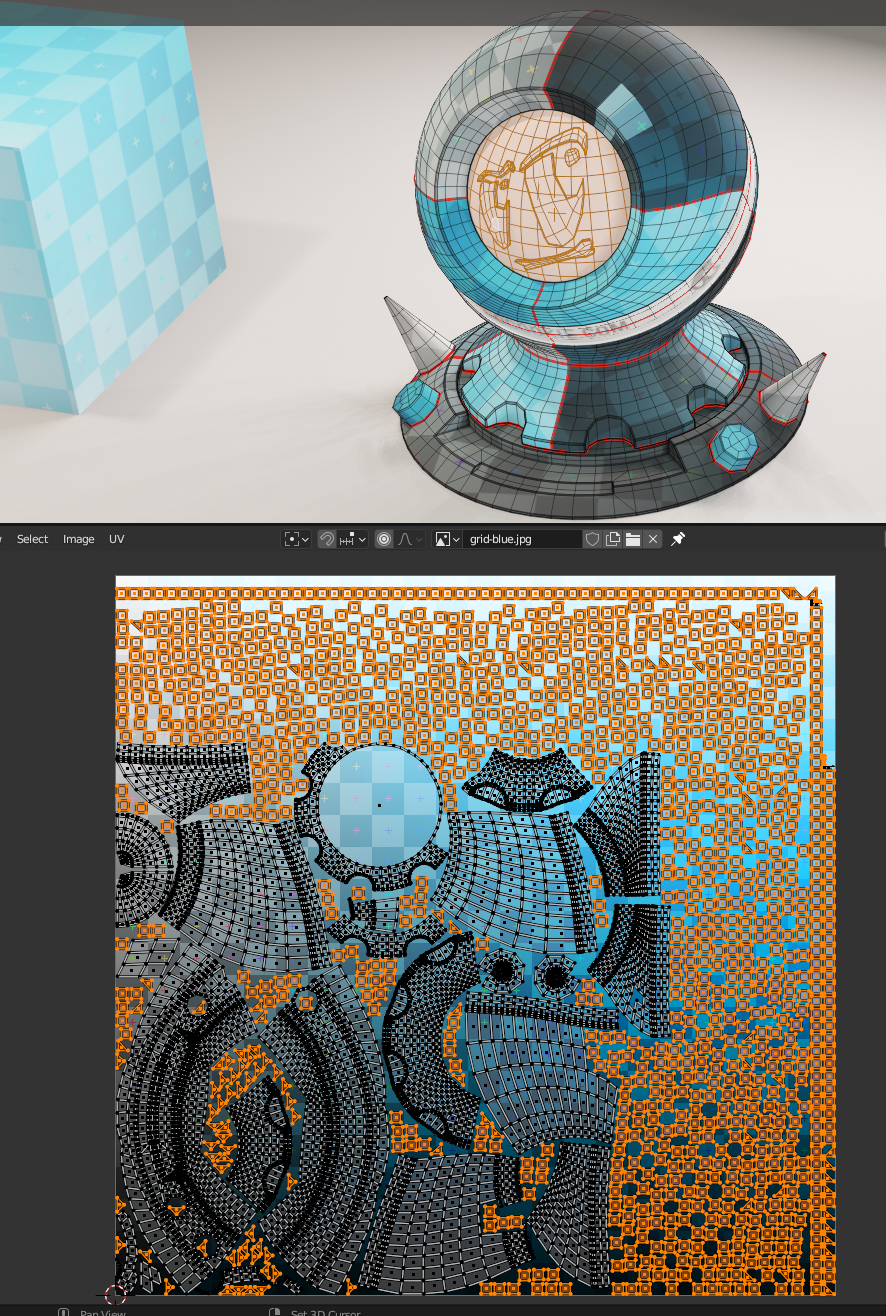

    Yes I know this what I don't understand is why the blue grid stays displayed when the image is blank (the blue grid has been cleared)

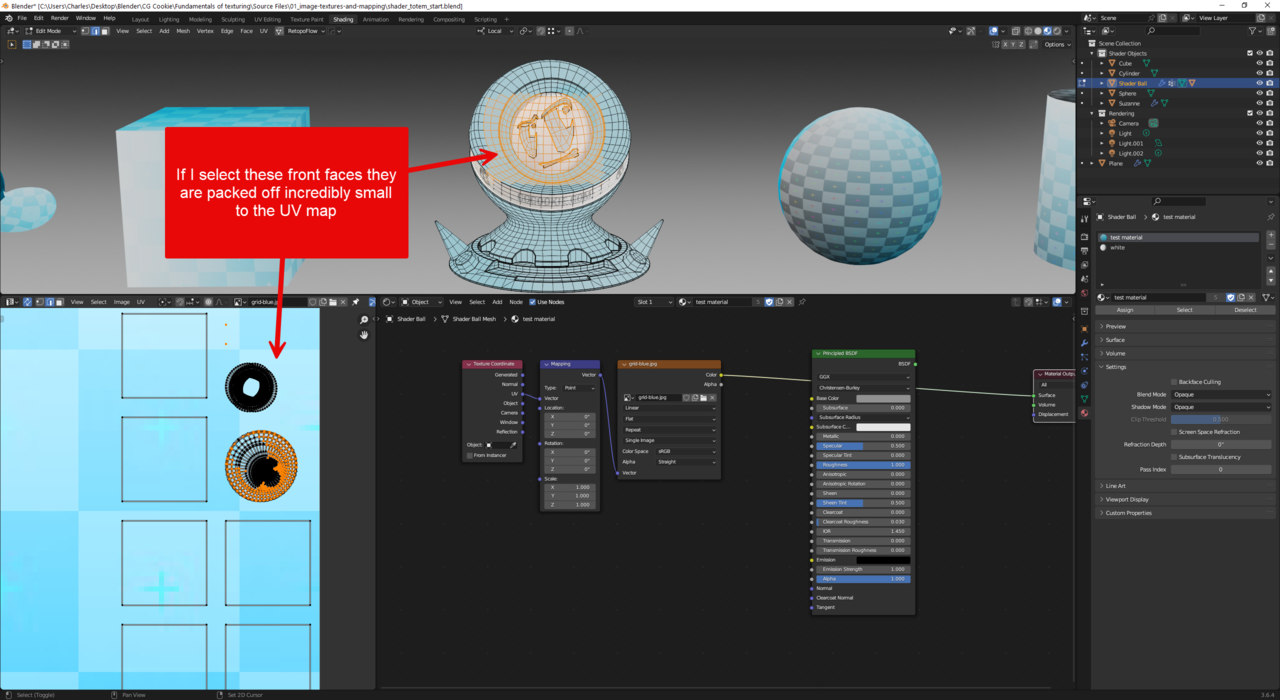

    and prior to and related to this... where does the orange square come from for the shader ball
    I'd also posted to a previous question but my shader ball doesn't conform to the user journey shown in the video.
    To start with I get this
    [can't upload image...why is this button so buggy]
    and then after picking all the different unwrap methods and finishing on plain unwrap I get this
  • Martin Bergwerf replied

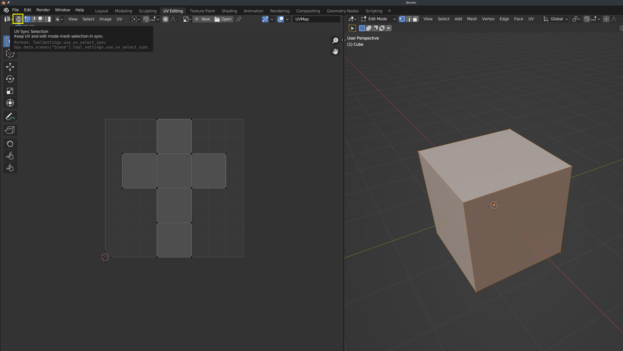

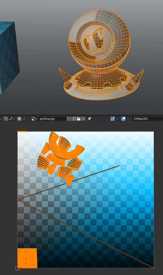

    If you have UV Sync Selected, the Unwrapped and selected Mesh shows orange, otherwise it shows grey, unless you Select things in the UV Editor:UV.png
    If you Add a UV Sphere and don't Unwrap it explicitly, it comes with a 'default' Unwrap as seen in your first Screen shot.
    The background shows the Image called Image. That must be the same as the blue grid.

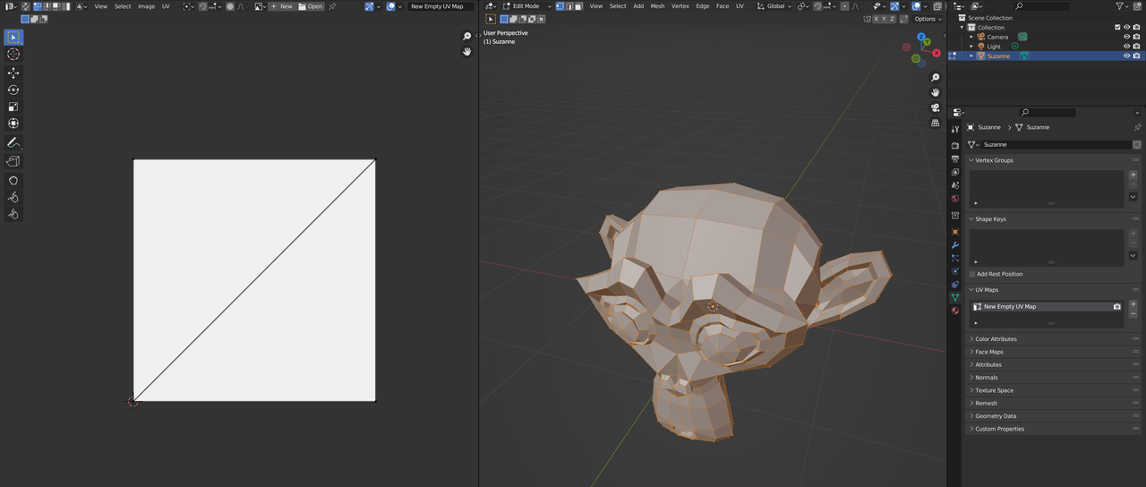

    The shader orb, probably has a UV Map added to it, but isn't Unwrapped yet (hence the Square):
    (I called it an empty UV Map, which probably isn't quite correct, the main thing is, that it isn't Unwrapped.)
    The Material confusion, is, because you have one Material Selected, but the other Material is Assigned to it:
    About the weird Unwraps, I am not sure, might have something to do with the Live Unwrap, but anyway, you should Add Seams to the model to get consistent and predictable results.

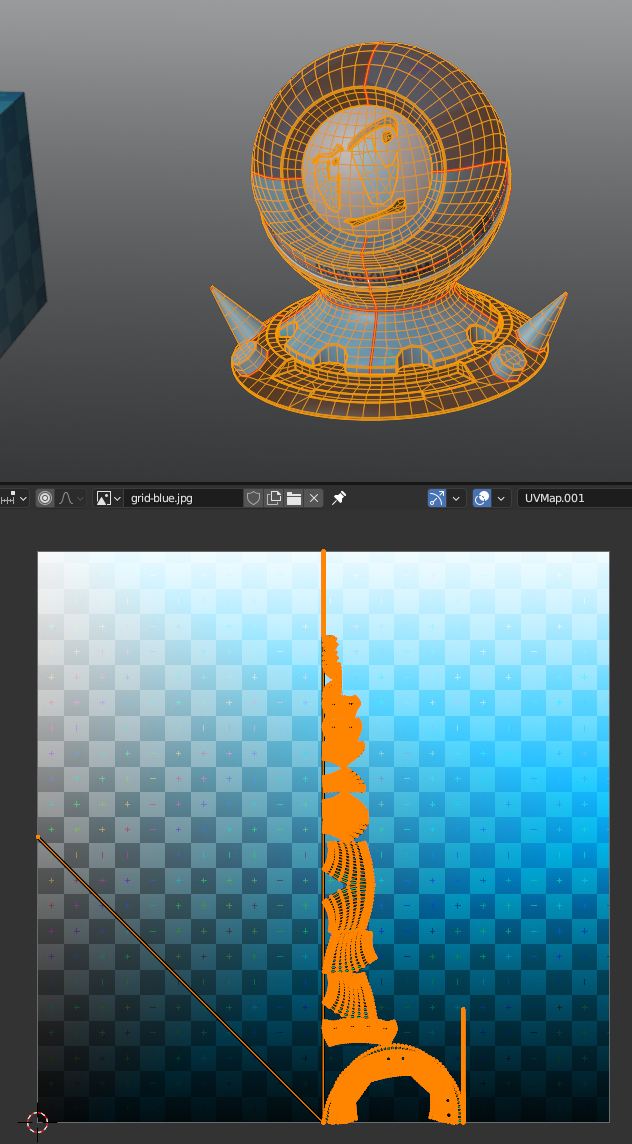

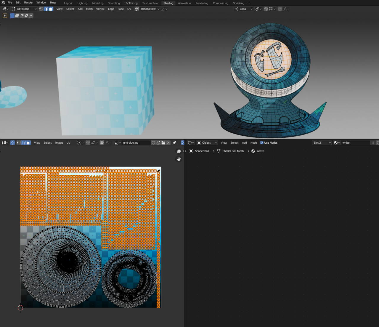

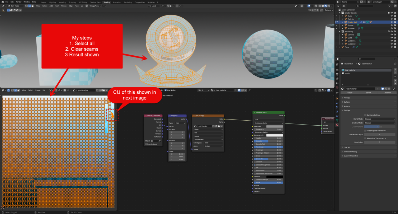

    What I don't understand is why when I replicate JLs steps precisely I get shown a different result. (I opened the blue grid as the image background to the UV)
    Could I have some sort of cached unwrap/packing setting from messing around without knowing what I'm doing? Someone else posted with this exact same issue so I think the answer must be something simple. The confusion is not my lack of understanding of the *concepts*
    If I Select All edges of the shader ball and UV>Unwrap>Unwrap I get this
    [edit: which I can't upload cos the button again actions the pop-up image URL and not your media library]

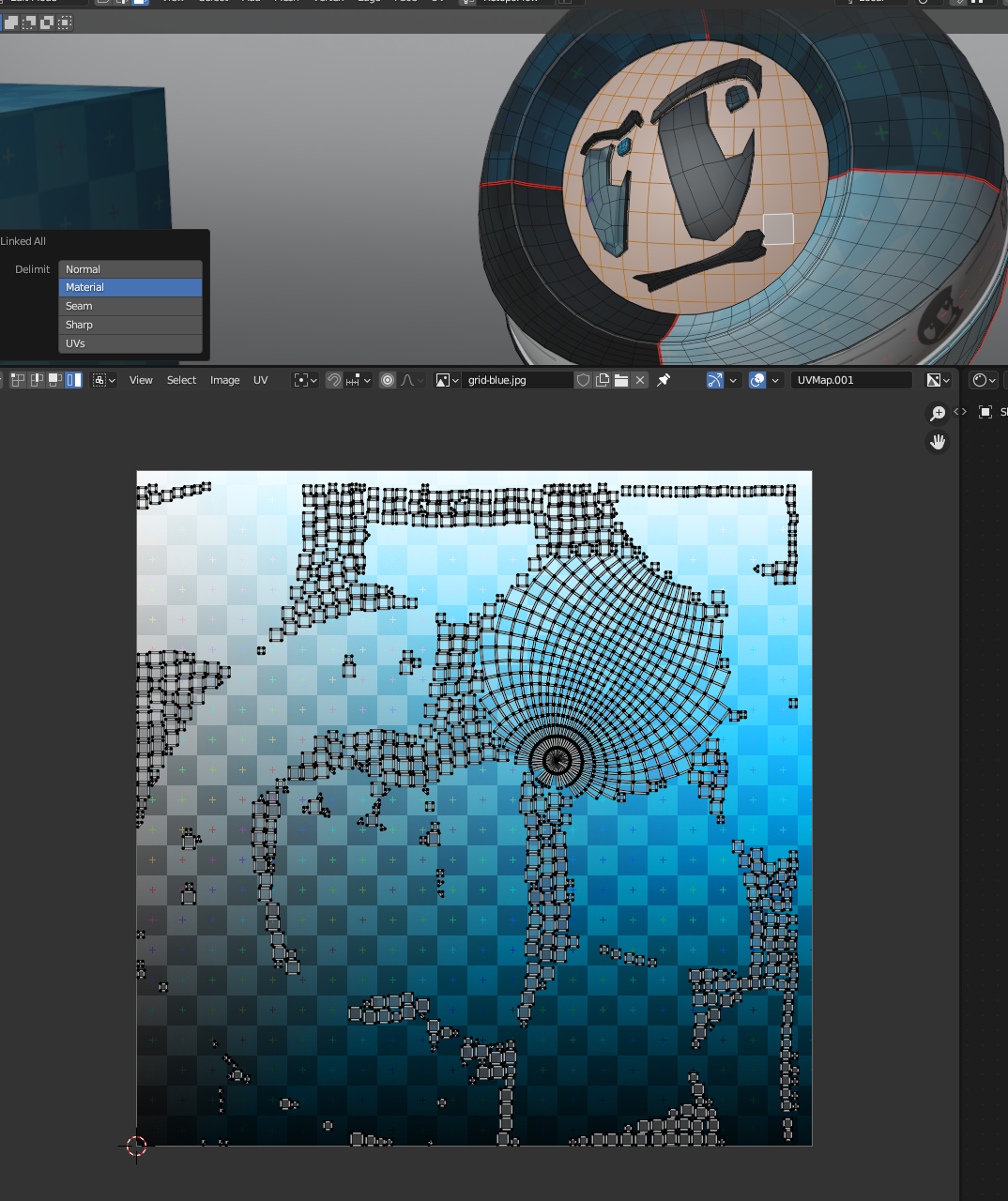

    Further when I CTL + L the shader inner face they are all the squares in the blue grid UV map
    Whereas when JL does it in the video he gets a completely different result
    1 love
  • Omar Domenech replied
    Ok I understand.
    Well Blender has changed a lot since JL made that recording and Blender keeps changing even more. They always change the unpacking algorithm and stuff. So I'm not surprised you are getting a different result out of the box. It might be that you changed some setting that Blender remembers, but the point is that you don't have to worry about a different result, it's just a different one, it's not that it's inherently bad. I think that before if there weren't any seams, Blender made a jumbled mess, but now I think Blender tries to do a different unwrapping. If you start placing seams on your model you will probably get a result more that how it looks on the course. The point is that your goal is to unwrap the model, try to not get too fixated on how different it is from the video, that will always happen, if at the end the result is a great texture mapped to the shader ball and you got all the concepts, then you're all good.

    OK I've marked seams on the shader but not touched or put seams on the inner part of the shader (the white bit with the eyes and smile) at all. I selected all those faces, hid them, marked the seams on the rest of the shader, then unhid them, select all and uv>pack
    And I get this... which surely can't be right Every single face of the inner part is split as though it has been marked with seams.

    I also don't understand why/how these few faces got separated?

    If you try to Unwrap the Shader Ball as is, with the Seams that are present, you get an Error:
    (The Error Message shows on the bottom of the screen, but it disappears after a few seconds, that's why I show it in the console here.)
    Packing after a failed Unwrap, doesn't really make sense now, does it?

    I'm not trying to unwrap the shader with the seams present. I clear the seams, mark my own ones and then unwrap and pack.
    I started again from scratch and everything is fine apart from the inner sphere and eyes/mouth brows which completely screws things up.
    I hide the inner sphere.
    Clear original seams, mark new seams, unwrap and pack. Good results
    Now I unhide the sphere
    Select all and unwrap
    and now pack

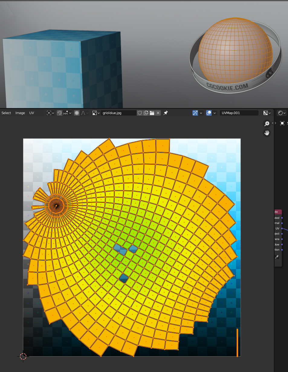

    The crazy diagonal lines are from the eyebrow! So I hid everything except the sphere, unwrapped jus that - and get this (below) Why are there a few missing faces and why do I have a line of vertices in the bottom right hand corner of the UV edit?
  • thehomme replied
    And then if I unhide and select all and unwrap again - I get this with the unwrapped sphere as an island that I didn't get before
    BUT if then select all and 'pack' the sphere splits apart into individual cubes againunwrap and pack .png

    I know, you don't want to Unwrap with the present Seams, but you will get an Error as well.
    You need to Unwrap the face as well (ie: place Seams).
    (Also, the rest of your Seams don't look too good...)

    OK... I think I'm finally got to the bottom of this.
    Not hiding the sphere is the thing that's done me in. If you follow as per video and select all with everything showing and clear seam while live unwrapping is on then this is what causes all the squares.
    Hiding the sphere completely and keeping the eyes. brows and mouth hidden until you've completed the unwrap of the shader is vital! The importance of this really isn't stressed in the video.
