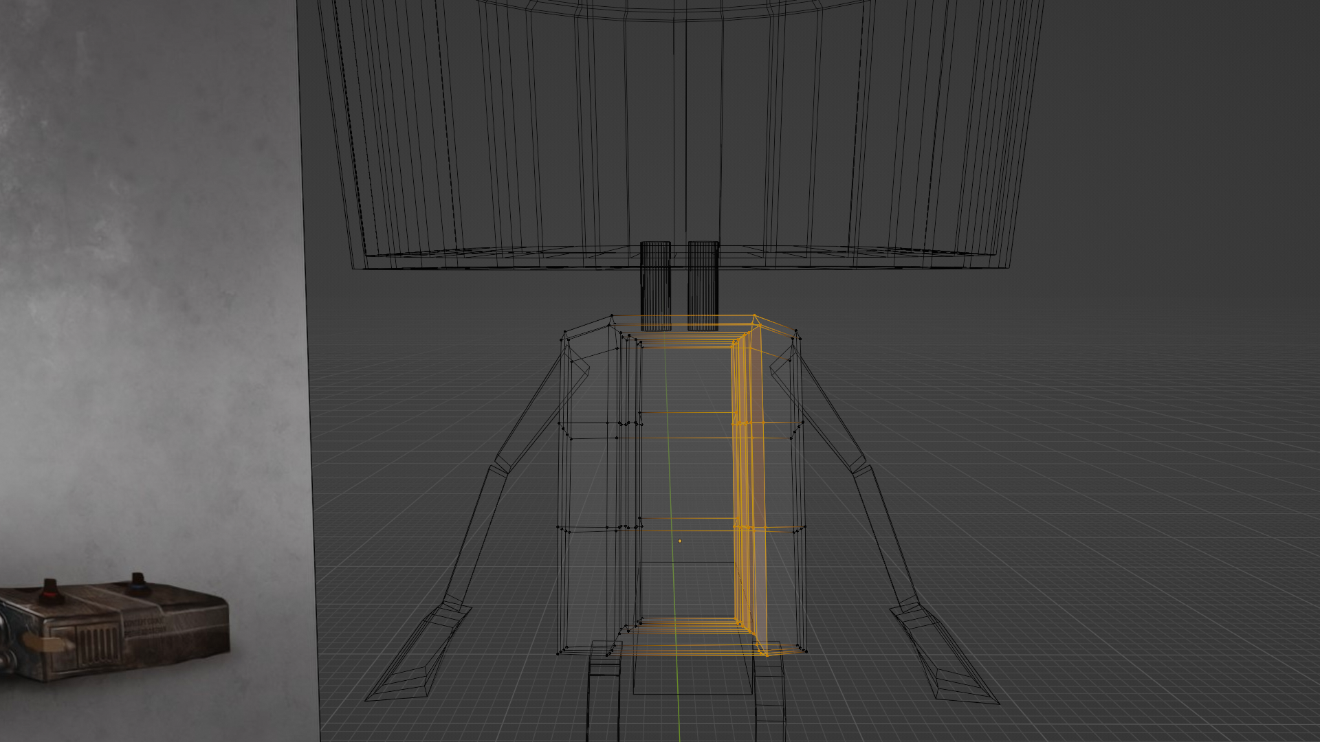

    So this is the image. As you can see I moved the right side but the left side didn't move, even though I had the X-axis mirror enabled above the viewpoint rotator.

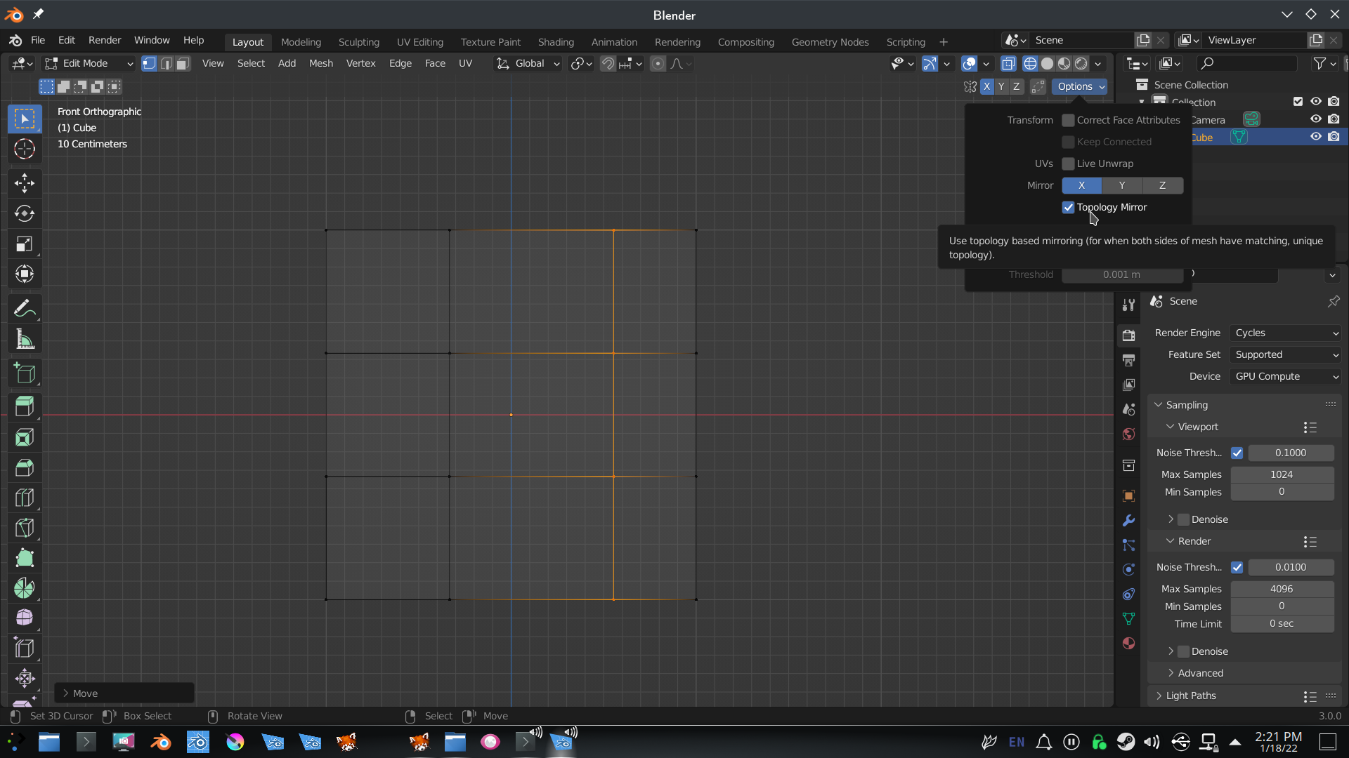

    That is weird. There is one thing I found: when you have Topology Mirror enabled, that might cause this:
    (Don't ask me what that is for...)
    Otherwise I have no idea what could be causing it.

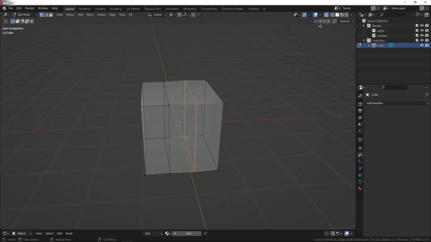

    Did you try this on just the default Cube? (New file.)
    Are you using any third party Addons? Try it with: File > Defaults > Load Factory Settings.

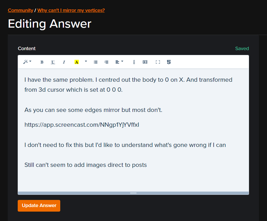

    I have the same problem. I centred out the body to 0 on X. And transformed from 3d cursor which is set at 0 0 0.
    As you can see some edges mirror but most don't.
    https://app.screencast.com/NNgp1YjYVffxI
    I don't need to fix this but I'd like to understand what's gone wrong if I can
