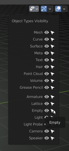

    Or you can disable selectability for all Empties here:

    thanks a ton! exactly what I needed
