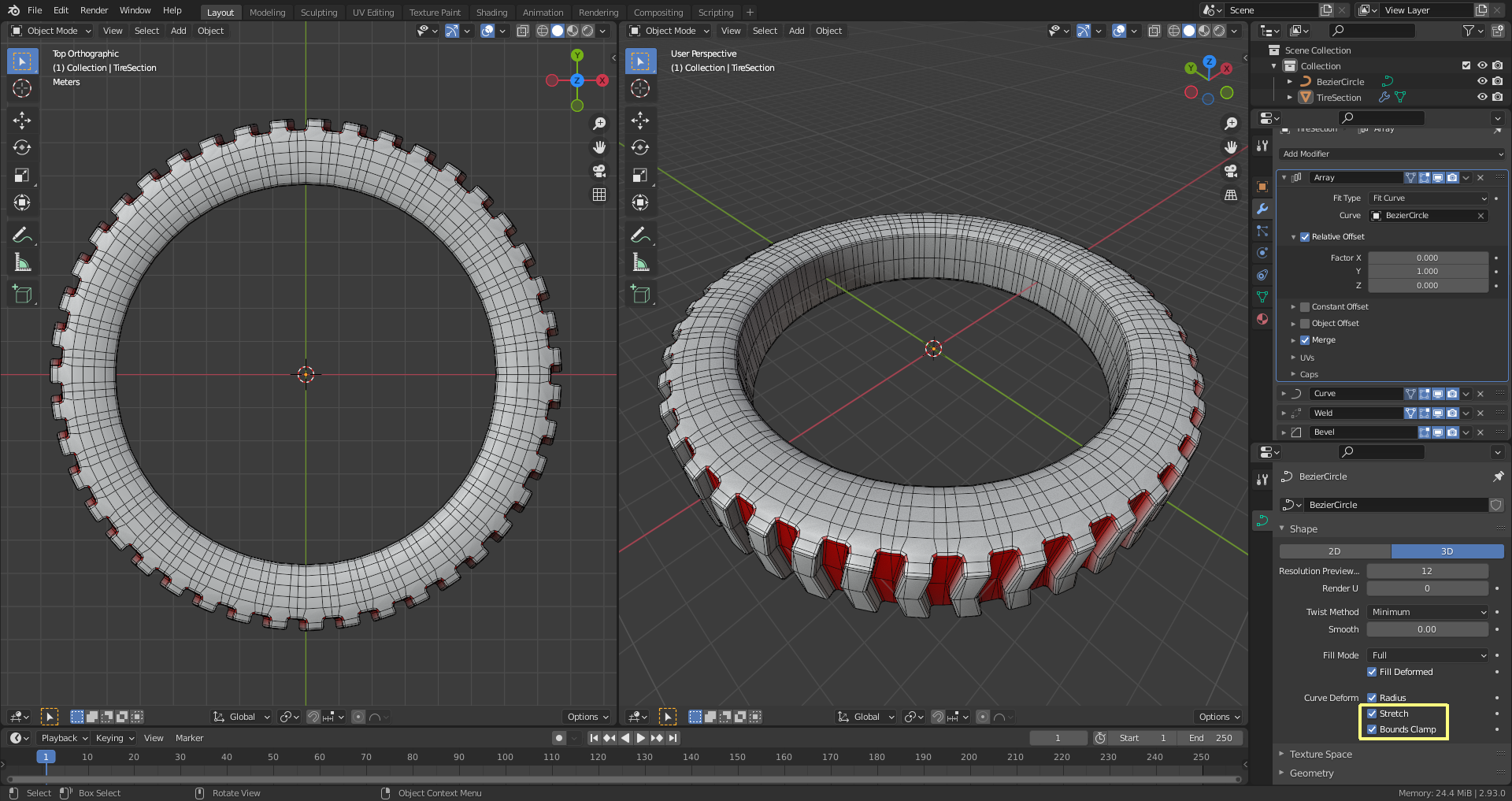

    jdeclanflynn there appears to be an 'overlap' here:
    Have you used an Array with Object Offset to make this? That method always has this problem....
    I prefer to use a Simple Deform (set to Bend) to make a wheel round, because you can set that to 360° and avoid a gap or overlap.
    I made a small demonstration of that technique here: https://www.youtube.com/watch?v=-4eKbpt_ZtM
    (Not edited...) It is actually about using drivers, but you can just watch the part about the modelling (the first 8 and a half minutes)

  • Ingmar Franz(duerer) replied
    jdeclanflynn Great job 👍! Tire modeling isn't easy! With the overlapping: Did you activate "Stretch" and "Bounds Clamp" on the curve used for bending the duplicated tire section?
    File is here.
    Select the "TireSection" object, tab into "Edit Mode", scale everything along the Y-axis and see what happens 😉. No "Drivers" needed!
    duerer that is also a cool way of doing this!
    I didn't know about those Curve Deform options. Good to know, thanks!
